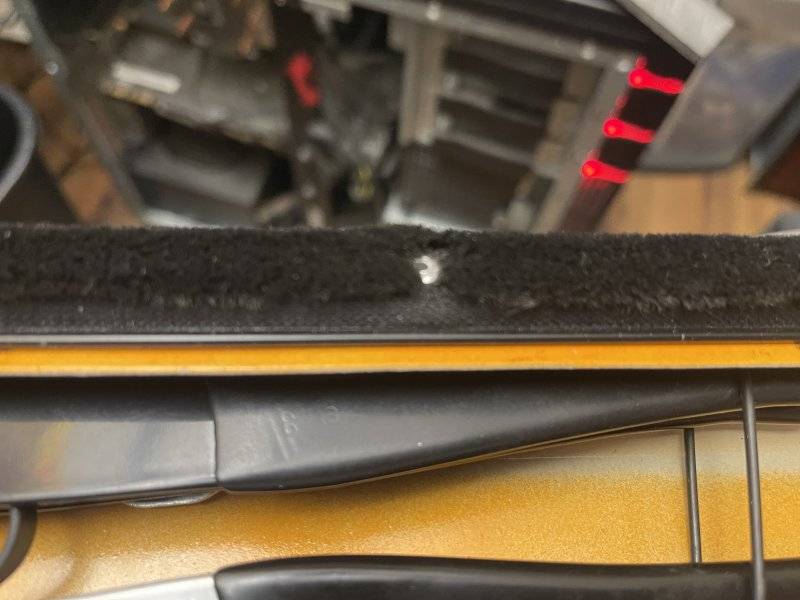

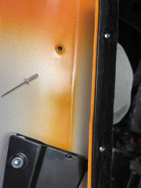

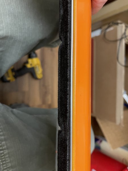

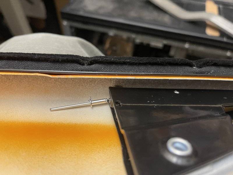

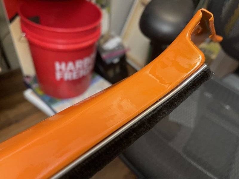

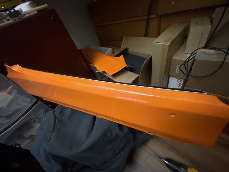

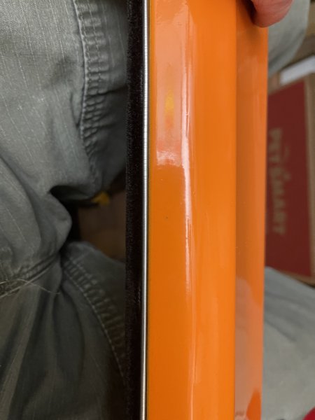

The interior rear top metal door panel used staples to attach the whiskers. After some thought I decided NOT to attempt to use staples. I think without the right heavy stapler and backing it just wasn’t practical. So I decided to deviate from Chrysler and use rivets. I used a 3/8 rivet which was just right. Works well as they sit below the whiskers and hold extremely tight making this an ideal alternative.
