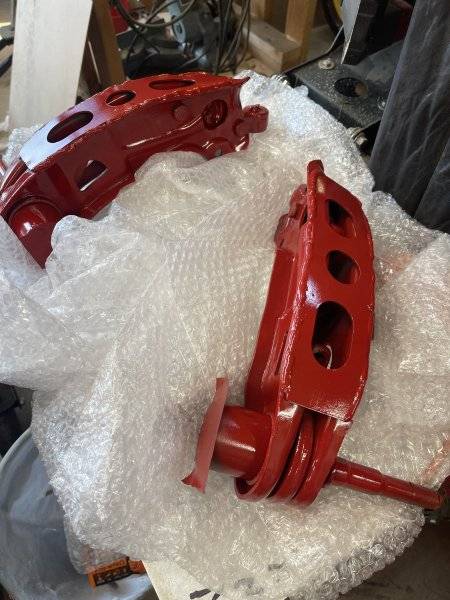

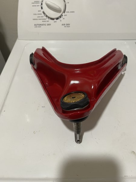

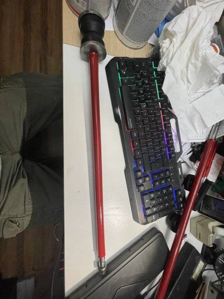

To maximize caster I am using Moog’s k7103 offset/eccentric bushing fix kit. My understanding is that this offset bushings was designed for camber adjustments on cars with front end “issues” but is being used to maximize caster when put in this way. The idea is to move the ball joint of the UCA rearwards. My drawing isn’t very good but the general concept here is the UCA will move out away from the car with the front bushing and in towards the car with the rear bushing. This will move the ball joint in an arc sweeping rearward.

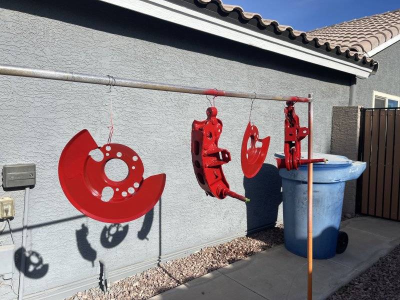

Now that all the bushings are in I can prime and paint. I haven’t factory deviated anywhere in the restoration but wanted to paint the suspension differently (other than steel or black) given all the work I have put into it. I wanted something different. I am using heavy duty tractor paint in IH color.
Will torque everything once in place then grease it up. Trying to get this done before major surgery that will F me up either permanently or at least 3 mos.
