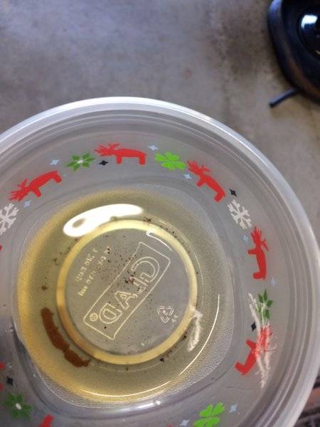

My Road Runner sat for many years and we finally got it up and running again. It had a few good test runs but the latest test run had the car stuttering to a stop and engine shut down. Looks like it is lack of fuel getting to
the engine. We filled up the fuel tank with about 5 gallons of gas and have not even driven it more than 2 miles so I know it is not out of gas. I even looked in the tank with a flashlight and can see gas.
The fuel filter has some fuel in it but does not appear to be very "active" or bubbly. We pulled the fuel filter and found some debris in it probably from the gas tank sitting. Do you think this problem will keep happening or will I need to completely remove the gas tank and pay someone to overhaul it? Any other thoughts?
This is a photo of what came out of the fuel filter that we have hooked in line next to the carburetor:
Thanks in advance!
We filled up the fuel tank with about 5 gallons of oil...
I assume you meant fuel/gas. I'd say you should start with the tank, given the crap in the picture. The sediment will probably continue to block the pickup in the tank. Send it out to be cleaned and sealed. If it were me I'd replace every fuel line up to the fuel pump with new. Then replace the pump. Then rebuild the carb.
Next check the brakes. Those might be getting gummy after all the years of sitting.

I had the same issue: crap in the tank. In my case, it was like a fine silt, and enough of it made its way through the fuel filter to screw up my carb with sediment, even after I put double filters on the fuel line.
I would clean or replace your tank. Flush your lines carefully and stop driving it until you know you have clean gas. I found out the hard way and had to rebuild my carb too...

These guys all are making very good points. However, if you have very little money & are willing to risk your carburetor, the el-cheepo way might be to put a very large magnet (Lowe's Hardware or an old speaker) on the bottom of the fuel tank & carry a couple fuel filters with you. When it starts acting up, just put in a new fuel filter (carry a screwdriver with you).... eventually, the rust will stop. I would also suggest you run a bottle of red Heet in every tank for the next 2-3 tanks of fuel (takes out water & red is 3x better than yellow Heet).
I "think" the stuff in your filter is rust out of the fuel line. I think it's too big to get past the sock in the fuel tank.
Having said all of that stuff.....these other guys are giving you better advice, and even using the el-cheepo method, I would still want to drop the fuel tank and change the fuel pickup sock at least.

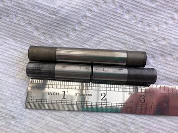

The fuel pump push rod needs to be examined as well. Even with all new tank, sending unit and lines, if the pump is not working properly, your going to have an issue. As everyone has mentioned, work in distinct areas starting at the fuel tank working to the carb. I would start with examing the fuel tank. Flush it out and examine for corrosion in the fuel that is removed. If you need a tank, go with the better quality tanks. Some of the powder coated tanks will not hold up well and will start rusting internally within a years time.
Absolutely. Here's the one from my daughter's 69 Charger when we pulled it after about 100mi. About 1/4" worn off the cam end. Bottom one is an NOS I found. From what I read, the best option, beyond NOS, is finding a good, used original. There was a run of bad MP repros, plus I hear some of the other aftermarket ones are suspect as well.
I have had good luck with the Mancini fuel pump pushrods
