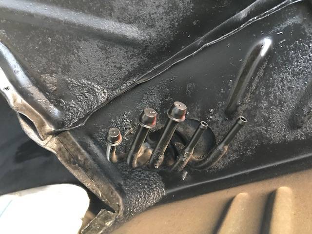

A '70 model year B-body equipped with California emissions will have the extra vent lines. If you car has a menagerie of lines like the pic below, you need the tank with the extra fittings. This is a pic of the vent lines exiting the trunk area from our '70 Satellite convertible. If you have them, they will exit the trunk right behind the passenger rear tire. Hope this helps!
