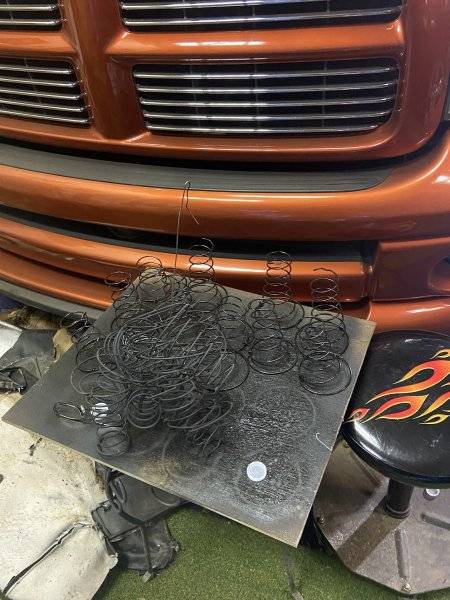

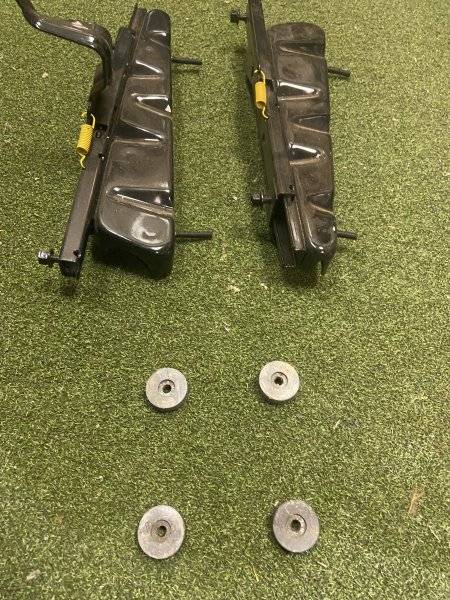

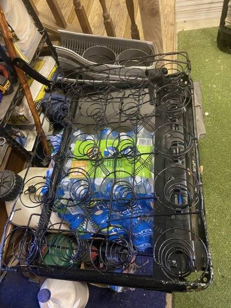

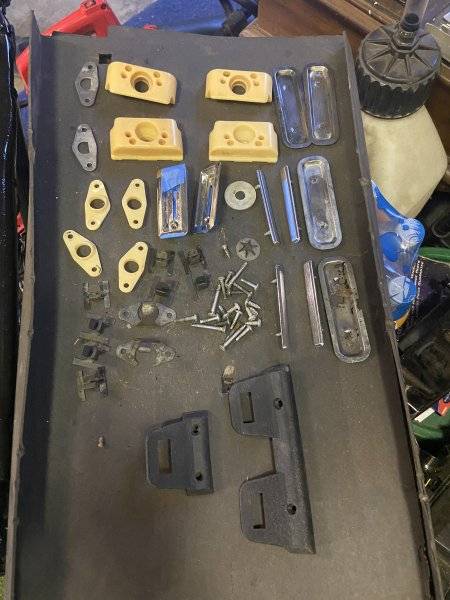

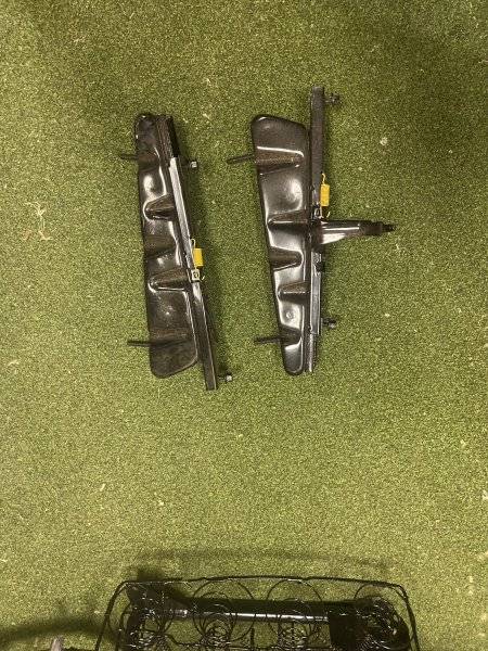

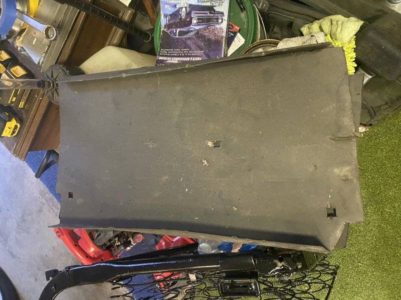

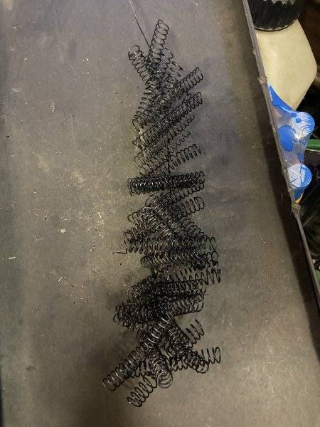

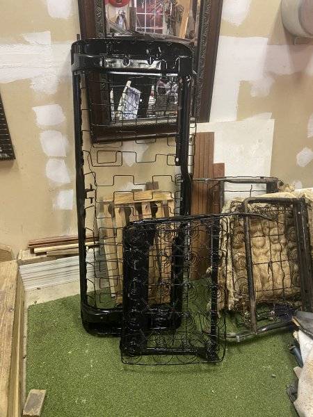

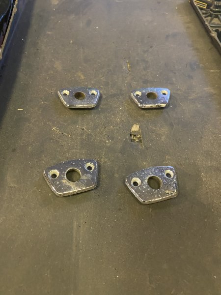

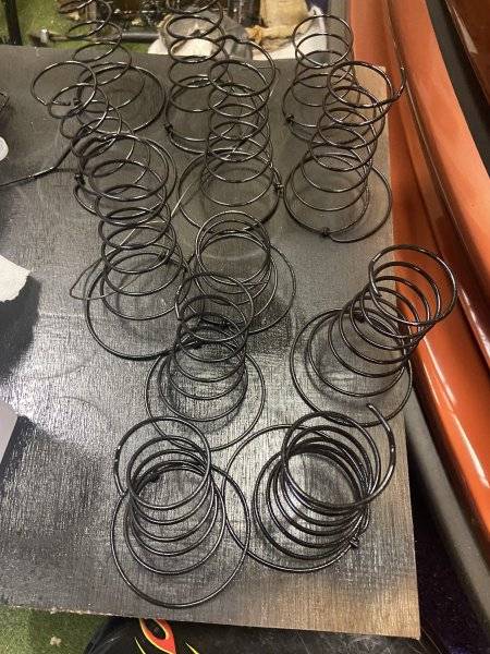

I don’t know about a kit, but I do know there is a lot of parts and pieces. Lots of prep. Here’s a couple of photos of most of the item you will need. Ask me how I know. Thanks to @MWbirdLOVER70 I now have my medallions.
If you have the old covers, take them with you to the upholstery shop. They can be used for reference.
