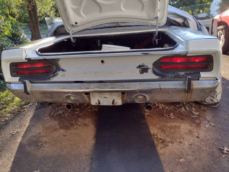

Guys Roadrunner rear tail lights do not work but hazard lights work any suggestions?

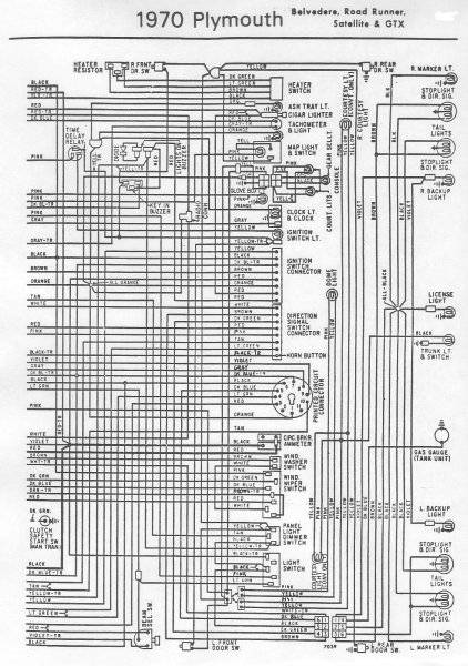

It has been awhile but my thought would be the black wire coming off the light switch. It splits with one black wire going to the panel light dimmer switch and the other going to the tail lamps IIRC
The turn signals run off a different wire, brown IIRC
Is your new wiring harness supposed to match the factory colors? If so I can see if I can dig up the wiring diagram.

I'd start with the simple stuff. Is the bulb good? Is the fuse good? Do I have 12v on the wire to the bulb? If all that checks out good, it's probably a bad ground. You can run a temporary one from the bulb holder to a good ground or straight back the negative on the battery if you have a long enough wire.
A lot of electrical issues in these old cars is simply due to a bad ground connection.

Guys I was able to find the lights issue but the turn signals do not work. And I took out the hazard module so I am thinking I need to replace the turn signal switch where do you guys recommend buying a replacement? Thank You Guys so much.
