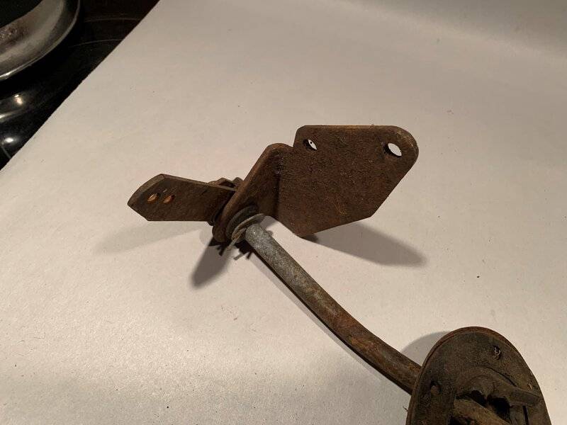

thanks for getting back to me. i have the torque shaft with a slight curve . i have it currently installed .i figured it was wrong since the shifter cant properly shift the gears. i adjusted the lower rod with the swivel.do you know what makes the 70 rod unique and do you know what other rods would work .thanks for your help
hi, i found the pic of what i recently bought.thanks
i thought maybe it was made that way? thanks
That part is commonly bent like that when a motor is pulled and the trans is hanging.. That could be straightened and used. It is supposed to be straight..
The torque shaft and top lever you have in the pic are not for a 70 B. Judging from the lever on top of the torque shaft that is a 66 A, B or C-Body part. A 70 B torque shaft has a fixed curved top lever. I have no idea how to help you w/o determining what top shifter linkage rod and lower linkage trans rod you are using. Miss matching pieces from different years and models never works correctly as almost every year and model has some different pieces that where specifically designed to function with the geometry of the other pieces which are being used from a specific year/model
