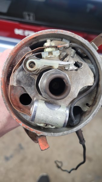

Do you have a good spare condenser?

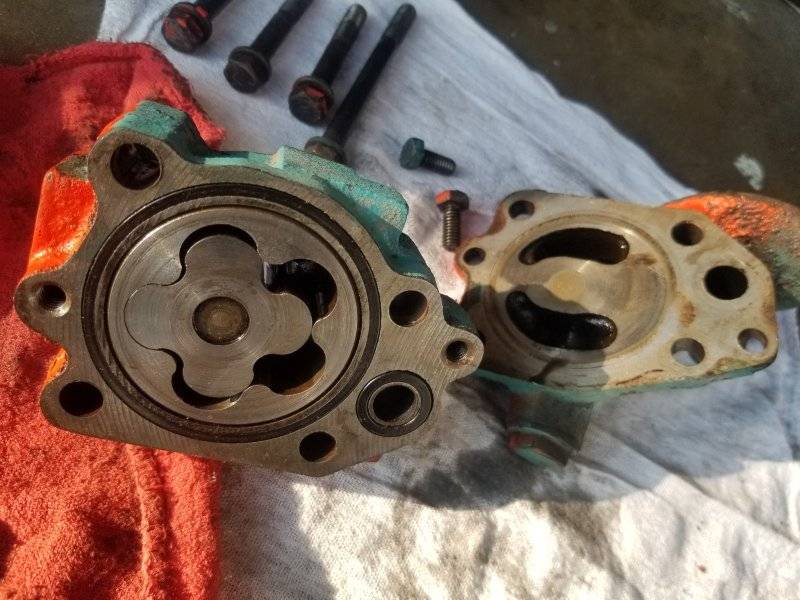

When I first bought the car I was hunting down a no oil pressure problem. I checked the pump (seemed fine) and then drained the oil and it came out slow. So I dropped the pan and found this wrapped around the pick up tube.
Yup, that'll do it......
Since the engine bay is not original [ Edel carb, good choice ], you might want to consider switching to elec ign. You can buy an elec ign dist cheaply from Summit, & use it with a GM 4 pin module [ also cheap ] that mounts to a heat sink mounted on the side or under the dist. You can use the existing coil & bal res, but if you use an E core coil like the MSD #8207 you can delete the bal res & run 0.060" plug gaps, such is the increase in spark energy. No more points closing up....
I installed an early Mopar electronic ignition in my ’63 soon after I bought it some 25 years ago. Only two occasions when something went awry, ECU and the ballast. I keep spares in the trunk. Each their own, as some like to stay original and find the old setup reliable – if – it’s serviced as recommended. MO, less hassle with electronic.
Wow, an entire shop rag in the oil pan? New one for me.

No problem Bobby. Hard to beat NOS when it comes to ignition parts.
Okay, I re-stabbed the oil pump/dist. gear. Points on and adjusted. I had to change the plug wires around to match the right starting place at #1. Everything in proper firing order and #1 is getting spark. It is late so I quickly tried to start it with brake cleaner (I know it's not ideal) and it wouldn't start. I ran out of battery power and I want to get actual gasoline. I also still need whatever gasket goes under dist. I just also installed a new Carter fuel pump.
The dist should have an o ring in the mounting base. That is the 'seal' & no further seal/gasket is reqd.
