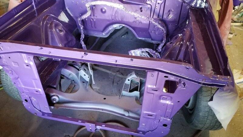

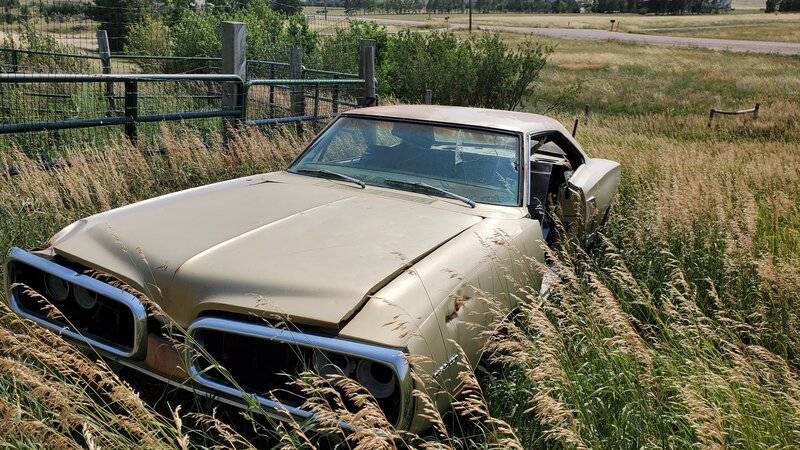

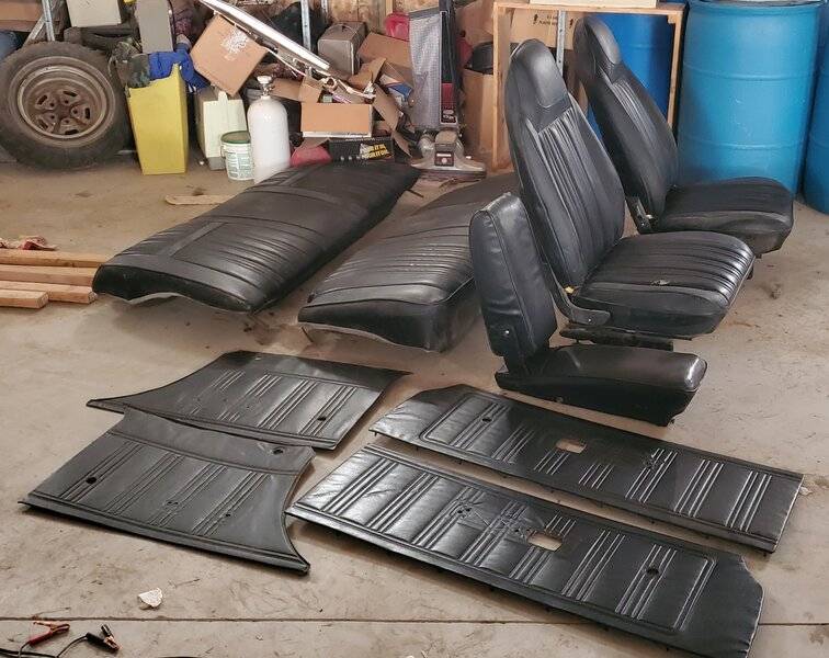

So, this is my 1970 Dodge Super Bee project that is going to be a bit slow moving as I am a full-time college student with too many classes. So far, the bodywork has mostly been done by me with the help of an autobody instructor with cool equipment like a spot welder. The engine (440 six pack) will be getting a rebuild as soon as I get starting funds from selling a 77 volare roadrunner so I look forward to that. Currently the car has no engine and when I got it there was a 383 under the hood but I have a date code correct (not numbers matching) 440 hp2 and the car vin says it had a 6 pack. As for spare parts I will not sell them because they aren't spare since I have 2 other 1970 coronets that were going to be parts cars that turned into projects after my Super Bee is done.

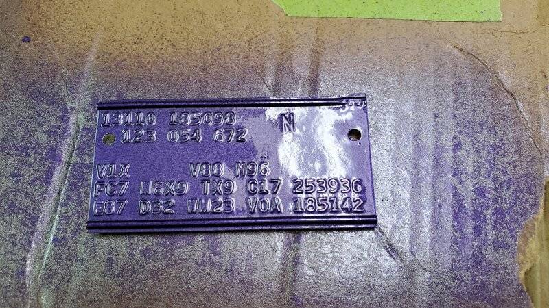

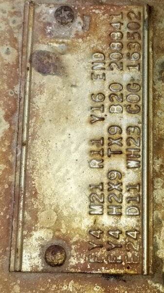

Here it is I have it mostly decoded but the large "N" in the upper right is still a mystery to me
here is what I have if it's all correct:
123: 440 6 pack
054: dana 60
672: 727 automatic transmissions
V1X: vinyl top black
V88: stripe delete
N96: ram air hood
FC7: plum crazy
M6X9: medium grade vinyl bucket seat interior with center armrest in black
TX9: black interior
C17: December 17th
253936: vehicle order number
E87: 440 6 pack
D32: heavy duty automatic transmission
WM23: w=coronet m=medium price class 23=2 door hardtop
V0A: v=440 6 pack 0=1970 A=lynch road Michigan
185142: sequence number
123: 440 6 pack
054: dana 60
V88: stripe delete
N96: ram air hood
FC7: plum crazy
TX9: black interior
C17: December 17th
E87: 440 6 pack

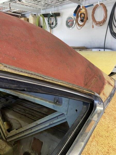

Nice projects. I have a question if you don't mind. I'm working on replacing the vinyl top. How do you get this particular trim piece removed? Do I have to remove the rear panels, window felts, and rear window?
So I have no clue honestly the vinyl top on my car peeled off and I haven't removed of the window trim yet because I haven't had the time to figure it out. (It's is going to become a serious project again this summer starting with the engine rebuild and getting it on the road.) The only piece of trim I removed so far was the trim between the side windows and the rear window which is clipped in and with outward negotiation thankfully they came out without problem.
Sorry I can't be much help with this.
