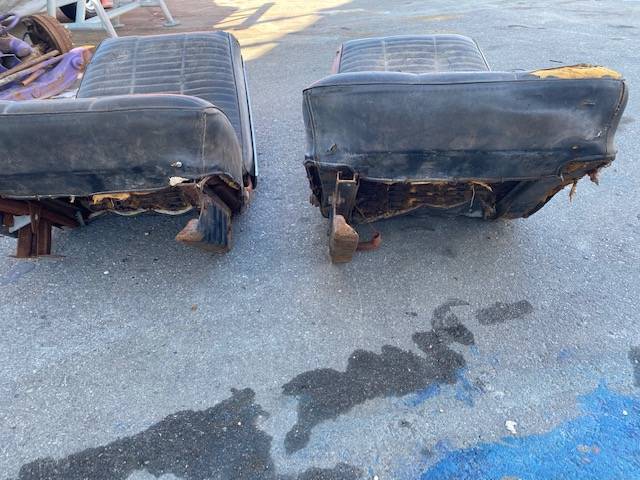

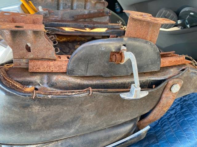

Here are the seats that came out of my 1970 superbee
Can anyone tell me what cars were built for ??? charger ? roadrunner ? superbee
And what years ?? 1968 1969 1970 ???
I want to trade them for the 68 road runner bench seat I need as reccomended above by JT 4406
Almost look like truck tracks.
68/69 any B body should work- Coronet/Belvedere/Satellite/Charger.
Head restraints were available as an option starting in 1967.
Seats look to have 1966 Charger covers, so frames are prob 66/67, not the 70 high backs and tracks I have never seen before.
Those don't look like 66 or 67 tracks to me.
I have NEVER seen those tracks before.
Seats look to be 66/67, and covered with 66 Charger covers.
I was agreeing with you that they look like truck or van tracks with the height.
