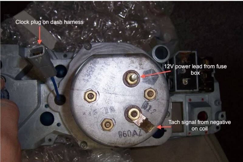

1970 Rallye tach. Which terminal is for power and which for coil? Don't have my FSM with me.
Thanks

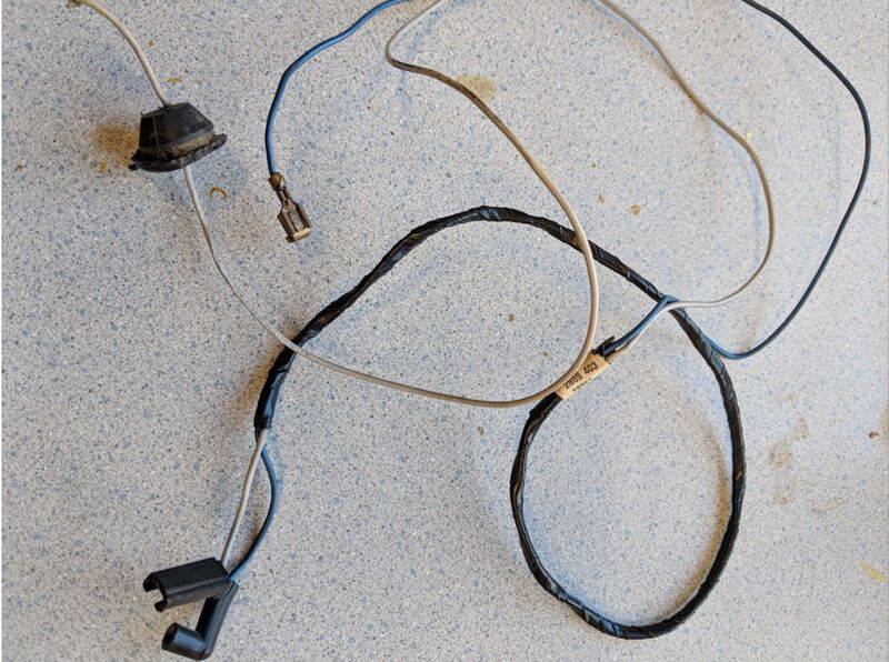

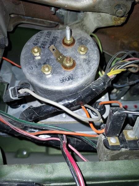

If you got the harness is pretty much self one way. Long stud power from Ign ( blue wire ) prong coil signal ( grey wire ) there is no other way to conect them. Harness gets these connectors specifically for those provisions on tach.
Hey thanks buddy. Just what I needed. I thought that is how the terminals were but wanted to make sure. I don't have a factory tach harness and wasn't going to get one. I'm installing a MSD and will use their tach adapter and do my own wiring.:thumbsup:
