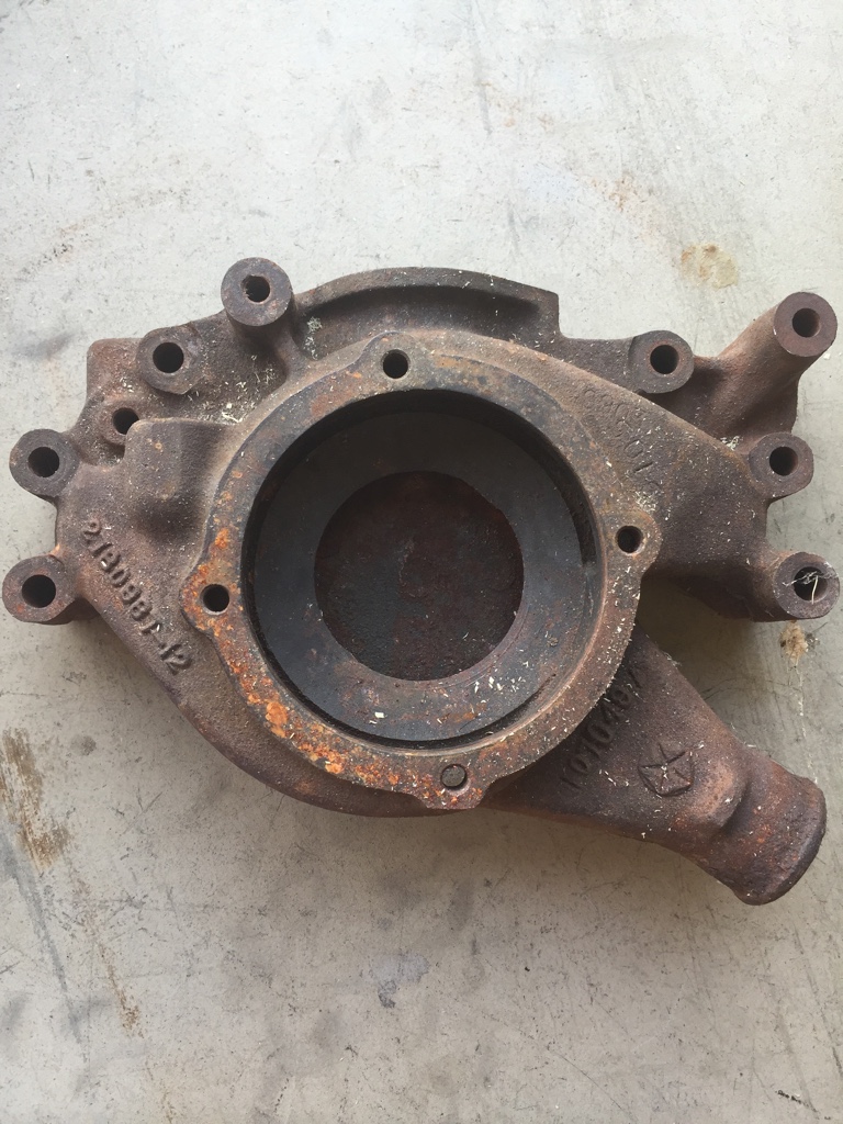

Is the water pump housing different for a 70 440. I bought a set of heater hose nipples for an extra one I have. They don't fit. I know my 70 440 has 1/2 & 5/8 heater hoses. I think the housing might be for 69 & down. I can't find any date coding on it either. If they are different, what housing # do I need. Any help is appreciated.

Geez....wish I could help you.... nothing on my car is original. I remember running into a problem with not being able to read the timing marks with one water pump housing I had. On my '70 I put in a "plumbing adapter" to mate the 1/2" and 5/8" hose.... but I'm guessing you're looking for "stock" so I'm not much help :(
The B/RB and Hemi water pump housings are all the same
383/440/426
I have an Old Thread on this forum, explaining this
Lets see if I can dig it up
Yes: one is "9/16ths and one is 1/2" I believe
CHECK OUT MY THREAD years ago: http://www.forbbodiesonly.com/mopar...p-inlets-for-Mopar-Big-Block-(B-RB)-on-a-Hemi

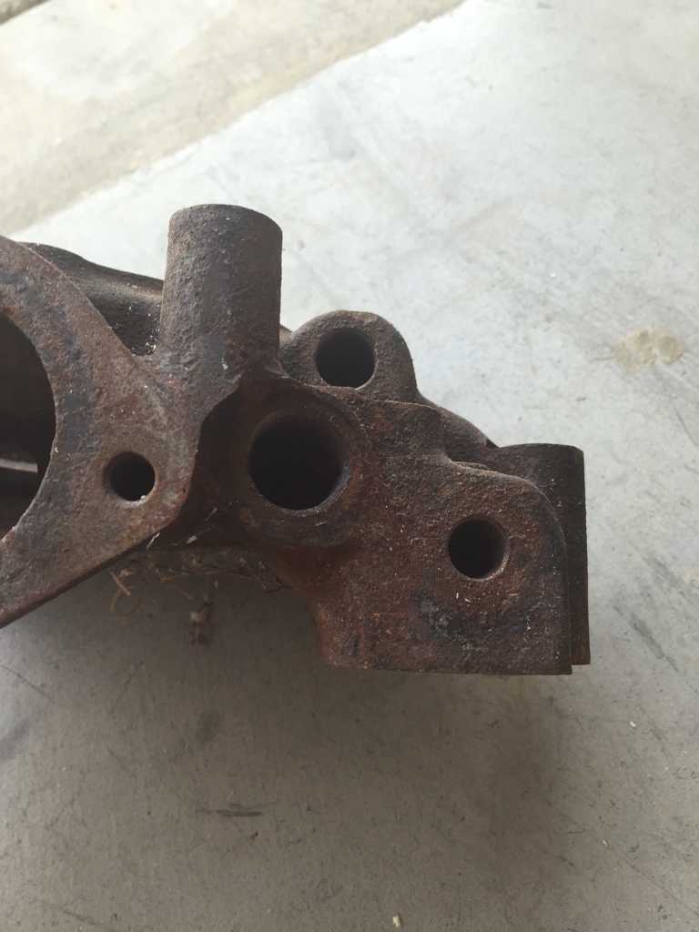

MY POST 2013:
I'm looking for a "NEW" inlet water nipples for the Hemi (For B/RB water pump housing)
Kit 1 from Year One has a small inlet: 7/16ths with a small thread.
Kit 2 from Mancinni Racing has a 9/16ths size with the standard 3/8ths NPT thread.
But: This inlet will not fit the smaller diameter hose to firewall.
The inlet I'm searching for is in picture 2 and picture 4. It is in rough condition, cast, not Aluminumn. It is 3" long and 1/2" O.D for the smaller hose.
Notice Mancinni Racings' kit has a "SHORT" inlet, again 9/16ths. I will use that but I need a 3" one with 1/2" O.D for smaller hose.
Does anybody manufacture this item new?
