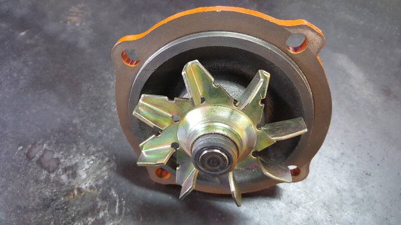

There's has been a lot of discussion on it in the past...... need to lay my hands on the link..... or maybe you could do some searches here and possibly FABO or more likely FCBO for the big blocks (inc Hemi).
IIRC, the issue was there are more different style impellers than you would think..... and some just don't cut it. If you do just grab a reman unit form the parts store, take a look at how it compares to your old one (you may not want to hand them that core).

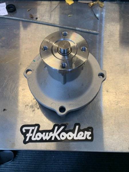

Agree with above comment from Ruffcut, Get a Flowkooler pump.. you won't regret it.

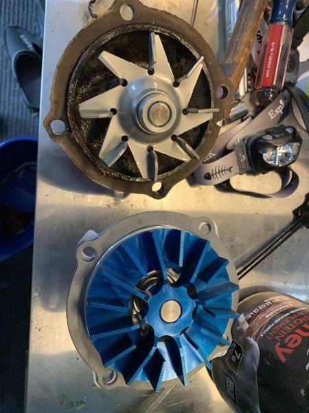

I just put one in a customer's car. Can't really say if it's great or not, hard to measure flow rates. But along with a re cored rad it ran cool.
The only thing I didn't like is the impeller didn't seem to be set as deep as the pump I took out.

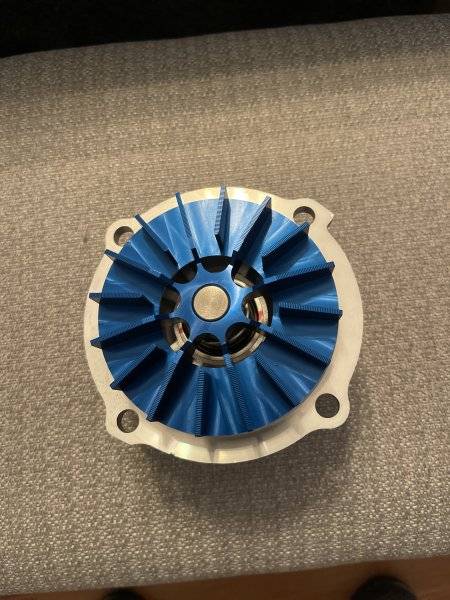

Anyone with a big block Mopar knows they can run hot so Flowkooler designed a high flow water pump with a CNC machined billet impeller with 16 vanes, integrated shrouding and a reduced casting-to-impeller vane clearance. It achieves greater flow rates, higher head pressure and a more efficient flow. The impeller color is due to Type II Class II military grade surface coating which protects against corrosive fluids.
FlowKooler introduced the first hi flow pumps and continues to improve impeller design. Why is increased flow so important to cooling a hot HEMI engine? Because it has been proven time and time again that reducing the cycle time between the heat source and the heat sink creates more opportunities to shed heat and drop engine temperatures.
From 0-3,300 RPM…Nothing Beats a FlowKooler!

Flowkooler, that is a unique impeller design for sure. They claim it helps cool at idle and low speeds, exactly where my issues are.
