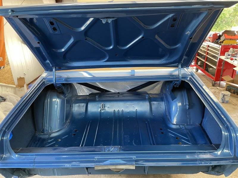

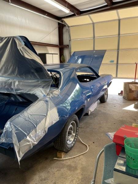

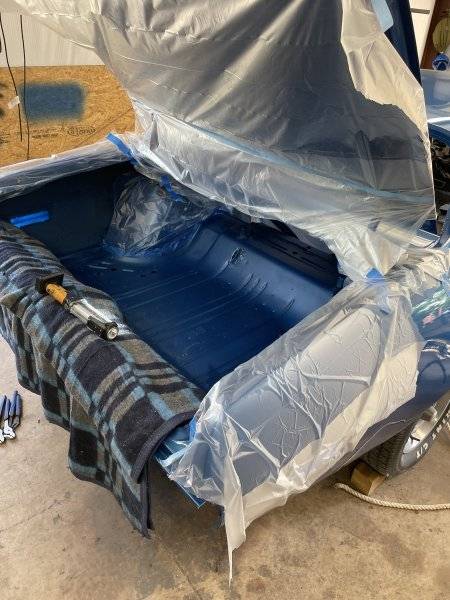

When my body guy was doing the car I had him leave the trunk floor unpainted so I could give it a try later (like learning how to plaster in a bedroom closet back in the day).
It’s was sort of cool yesterday morning so I gave it a whirl. Had to wear a long sleeve and wrap my head in rags to keep from dripping sweat on it!
View attachment 1331523View attachment 1331524View attachment 1331525

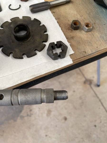

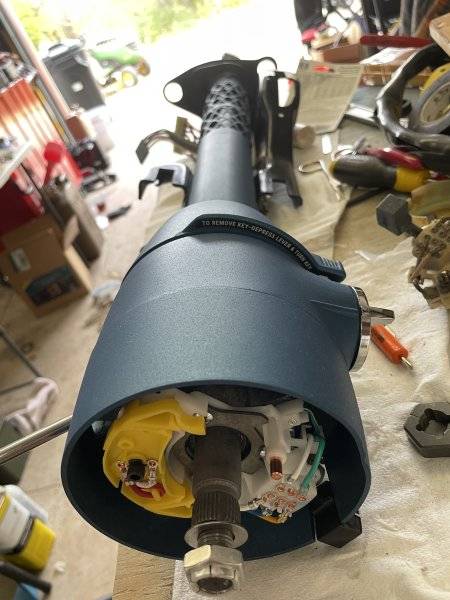

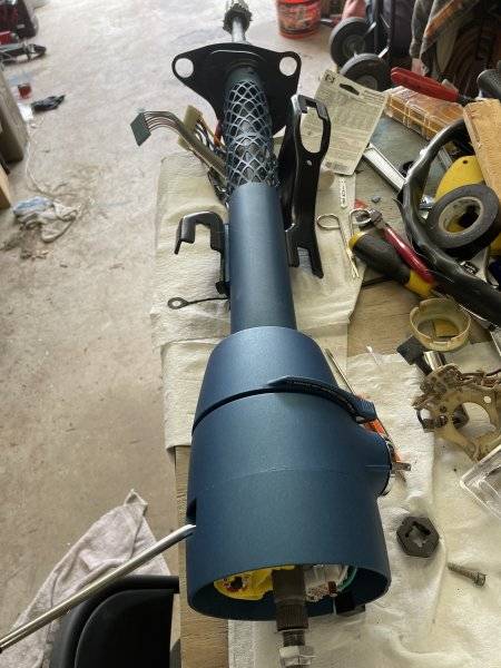

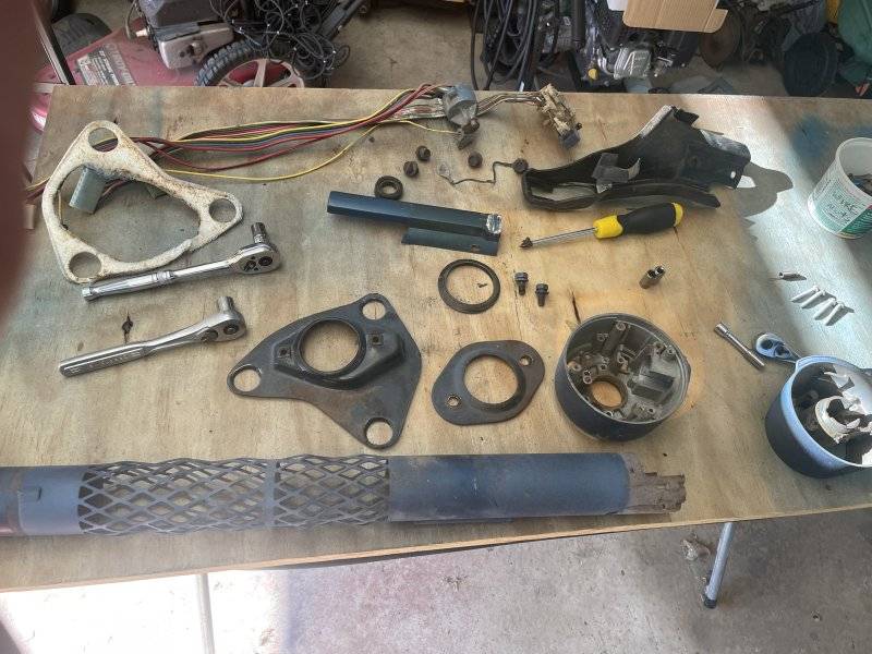

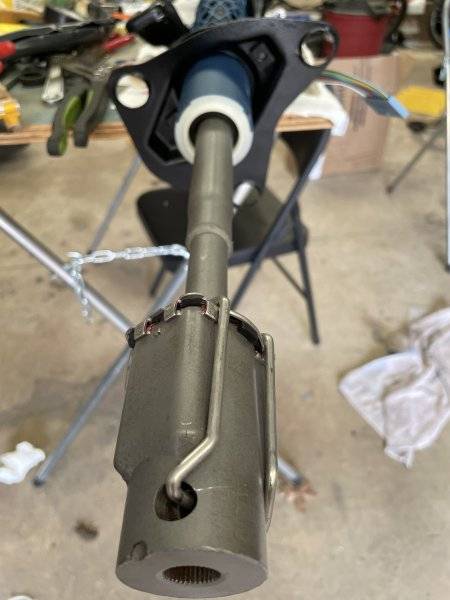

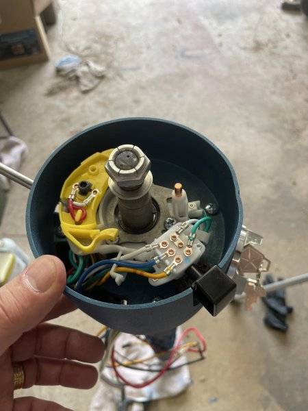

Ok. Now I way to look at my column more closely. I am missing pieces at the bottom. That white bearing spacer looking piece. And that wire retainer that I assume keeps the roll pin from just falling out.Finally got the steering column reassembled today. Still need to refinish the steering wheel, but I’ll take the progress!
View attachment 1365996View attachment 1365997View attachment 1365998View attachment 1366000
The white piece, at least for a floor shift car, is actually just a retainer for a foam seal.Ok. Now I way to look at my column more closely. I am missing pieces at the bottom. That white bearing spacer looking piece. And that wire retainer that I assume keeps the roll pin from just falling out.
