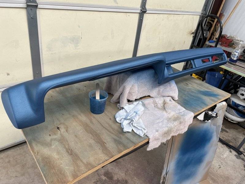

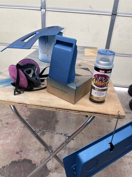

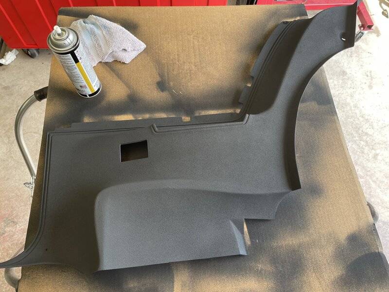

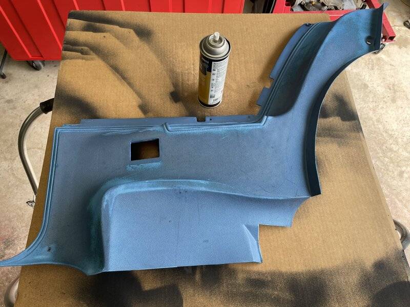

Proof of concept testing. Refinishing 50 year old scuffed, beat up, sun damaged, and chalky interior panels. Starting on the back ones so any mistakes won’t show as bad (like when they would make apprentice plasterers start in the closets of a home lol).
Blasted with walnut media at 30 PSI, cleaned and scrubbed with degreaser and green scrubbing pad. Dried, wiped down with alcohol, and then applied SEM texture coating to bring some texture back. Still need to knock it down with sandpaper/gray scrubbing pad and then paint the correct color blue, but it’s looking good so far…for a cruiser.
