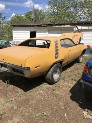

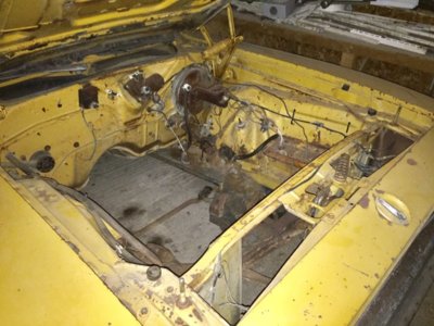

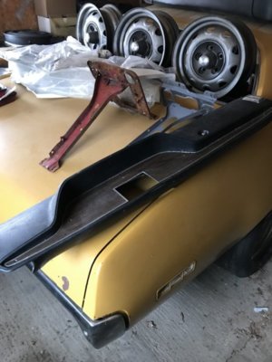

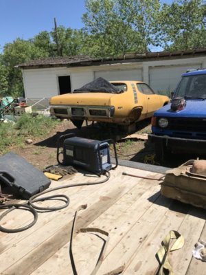

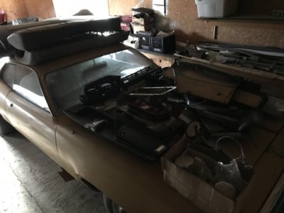

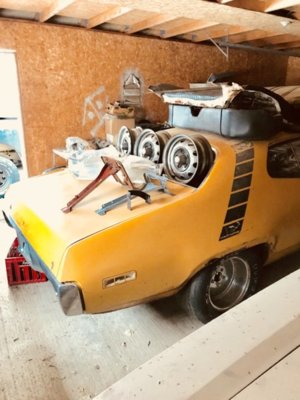

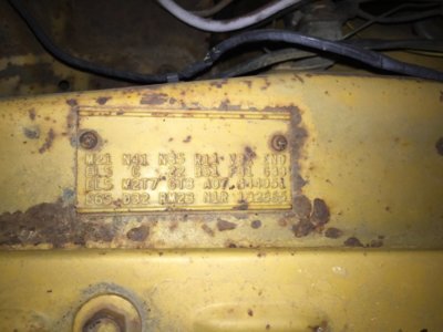

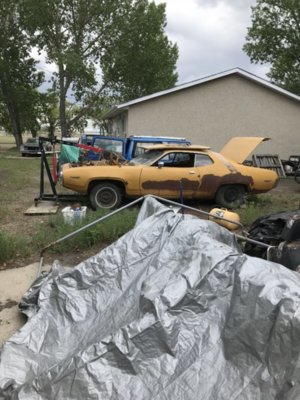

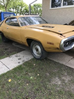

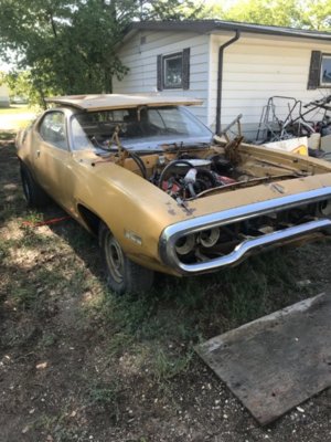

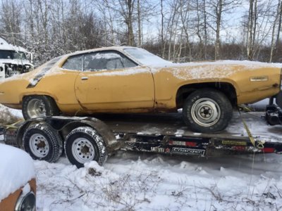

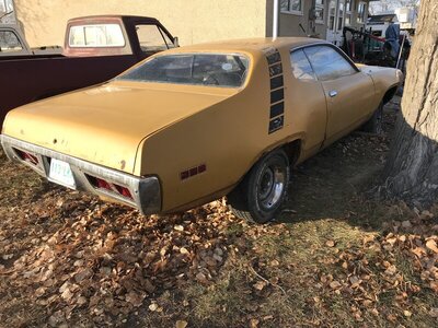

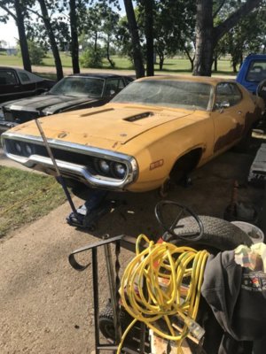

Bought this car in November of 2017. It’s a 383 auto column shift EL5 Bahama Yellow car. I Decided I might as well put an engine in and have some fun with it before I restore it, so I pulled it out of the garage this summer to work on it. This is when I first bought it and loaded it up

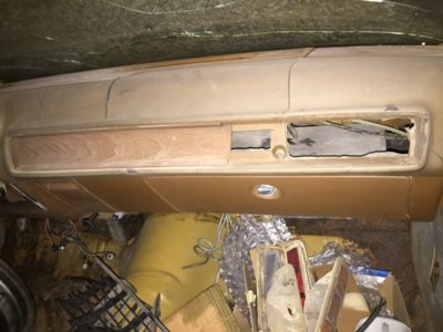

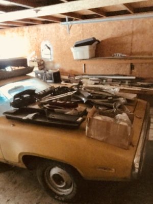

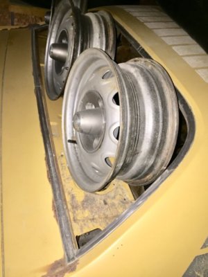

Few more pictures after I put it in the garage along with the rallye wheels I bought shortly after buying the car (bought all 4)

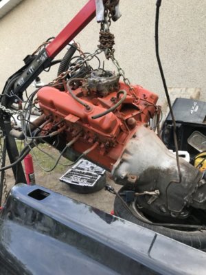

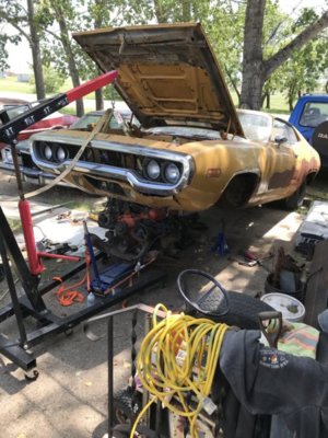

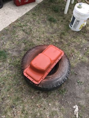

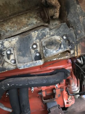

Bought a recently rebuilt 383/727 last year out of a 70 dodge sweptline truck. The trans will not work for my car but I can use it for my 70 D100 Dude when I get to it. The guy I got it from recently bought the truck and was swapping in a Cummins instead. I used a 933 oil pan and pickup tube and transmission off a mid 70’s C body 440 and gave the engine a rattle can shot of hemi orange doesn’t have to look pretty in this thing.i also had to knock the weights off the torque converter since the 383 has forged crank. I didn’t want to used the good new converter since I’m uncertain the condition of this trans as it was pulled out of a car that sat for years.

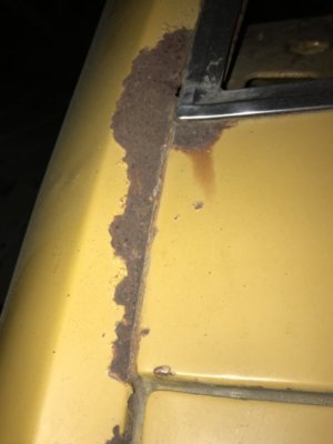

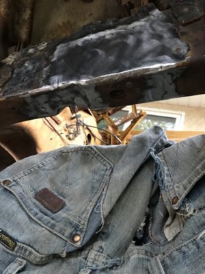

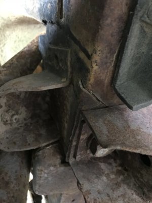

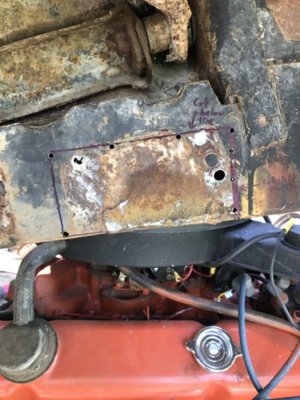

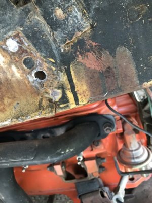

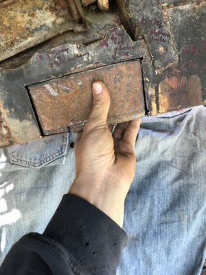

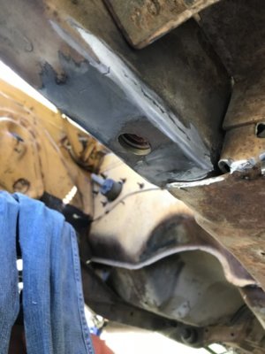

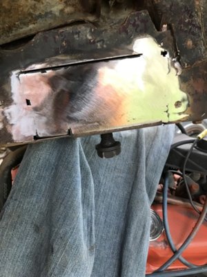

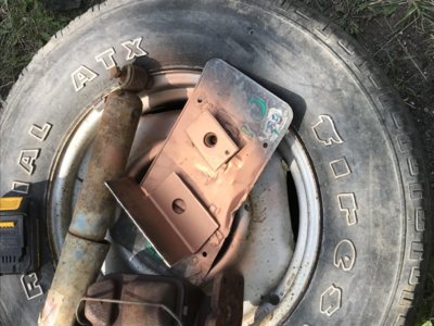

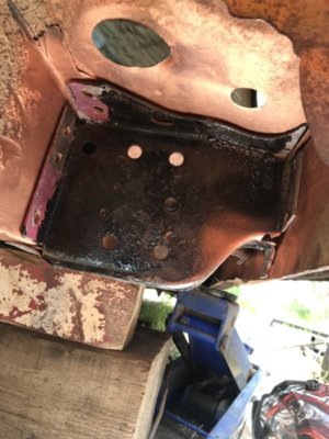

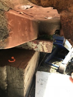

The front rear leaf spring mounts were butchered for whatever reason so I replaced the passenger side with one from my parts car. I’m not a professional but it should do the job. The drivers side is really ugly so I might leave it for now then I will replace the whole rail. But I kind of want to do that when I replace the trunk pan, extensions and lower wheel wells, quarters and rear window sill

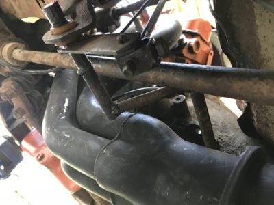

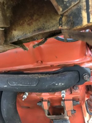

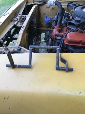

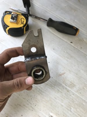

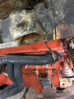

Headers went in no problem at all. I left the motor mounts unbolted so I could lift the engine up with the engine hoist. Then I realized the torque shaft for the column shift was dead center of the header. Made this in about an hour out of the torque shaft and a wrecked U bolt I had laying around. It’s not the prettiest but should do the job

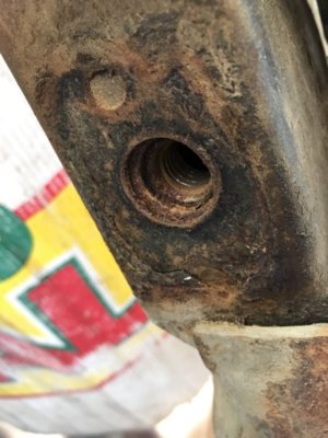

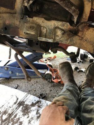

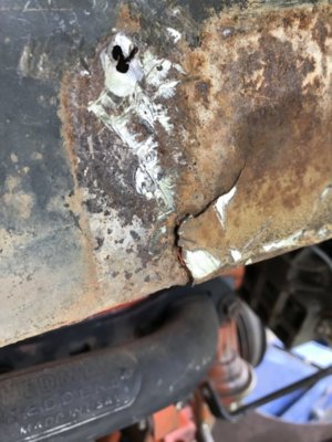

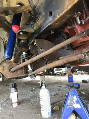

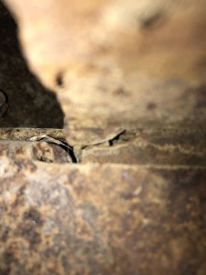

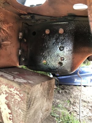

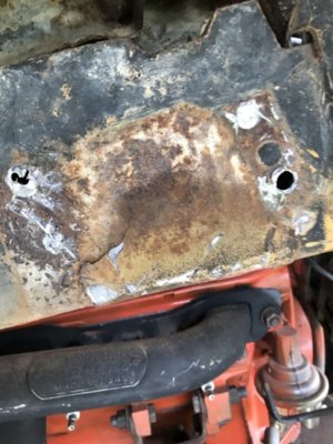

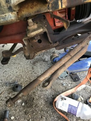

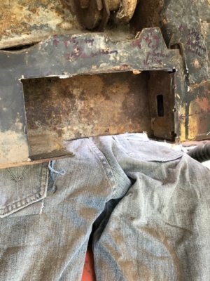

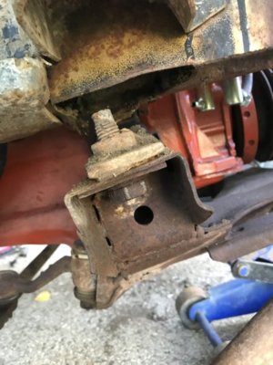

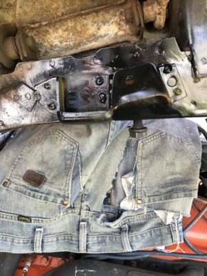

Not sure how I missed this before. Had to drop the K member to do some repairs. The passenger Torsion bar was a pain in the *** to get out
8C516CAB-849D-49CF-B575-75464E28E5C9.jpeg 3D409DB1-1ADB-4D7B-8285-DDB31903A01A.jpeg 9BC4D9B9-2A0A-4DB3-BB74-B85F88442502.jpeg 77E9B149-E0B2-4689-BAC3-CCE04BDBFB8D.jpeg D1FCC12C-93B3-40DA-BBEC-404577D720B3.jpeg 0F483746-D65D-41A8-8794-9FE9512A7F16.jpeg 05BBCD06-4CF1-4D7A-B3E1-532E8CF0923A.jpeg 12E820A2-6C38-4D48-9FC1-42566BAE1C14.jpeg 94926A54-7CE2-4B74-AFEB-630D91CAC7A9.jpeg 31AE332D-BA5B-41B1-ACA3-CF0CF2632BF9.jpeg

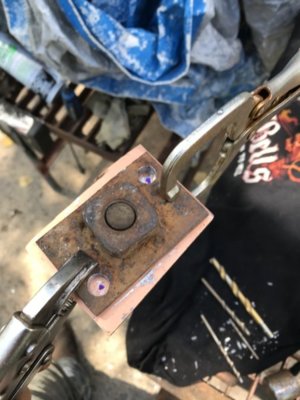

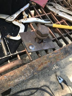

More pictures of passenger side k member mount repair. At least it’s only the one side...
upload_2019-8-22_22-36-57.jpeg 93774D68-5181-4D4F-BFDC-DEFA03ACA839.jpeg E961E17F-EECF-4C1F-851A-7BF8131670F2.jpeg E053393C-D6EB-4A5D-BBDC-4BF897A1E6CE.jpeg

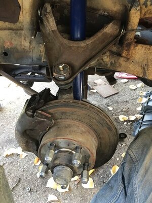

Decided I might as well rebuild the front end while I’m at it. Accidentally ordered red bump stop instead of black. Need to find upper ball joint socket so I can change upper ball joints and then control arm bushings
