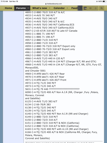

One year only thermoquad, very sought after and hard to find. A rebuild kit I dont think was available, dealers upgraded them to the 72 carb. 4972s for 4 speeds, 4973s automatic. They changed them in 72 for emissions.

Click the link below for a full list.

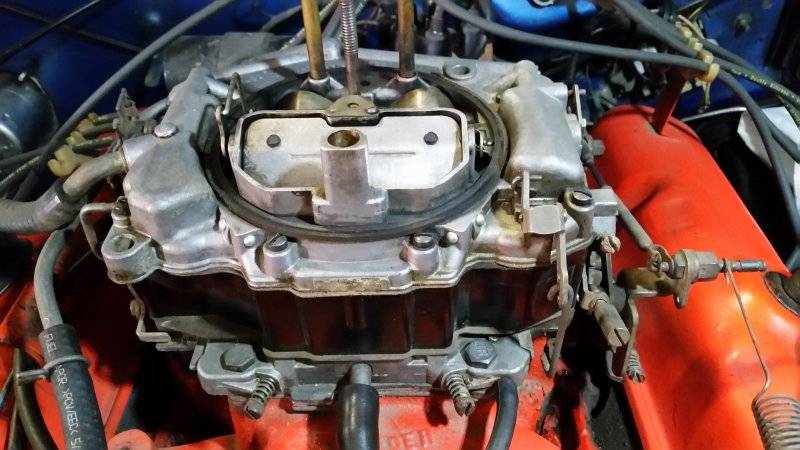

My December 1970 built Challenger 340 came with a TQ carb which is still running well on the car.
