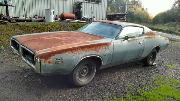

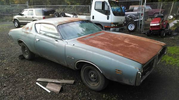

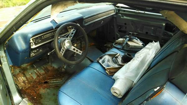

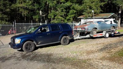

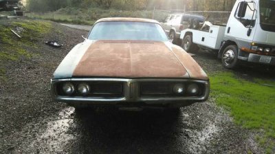

Yee Haw! I finally got my first project car and it's a '71 Charger!
Car came with a non-running 318, Auto transmission column shift with bench seat.
I picked it up on Wednesday and can't wait to get into it. The car looks pretty complete minus the Radiator and ignition keys so those are the top priority to replace. I just ordered replacement lock cylinders for the ignition, doors, and trunk that all use just one key. Now to locate a cheap radiator!
My plan is to get it running and driving then start restoring it bit by bit with the end-state goal of turning it into either a Super Bee clone or an R/T-SE clone, HEMI Orange with full Black Vinyl top.
I'm only considering the Super Bee clone because the car has several hornets nests throughout. I'll add pics of those later.
Meanwhile, here's some pics from the Craigslist ad and when I picked it up.
I'll be posting as often as I can during the process to keep you all up to date.

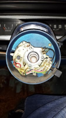

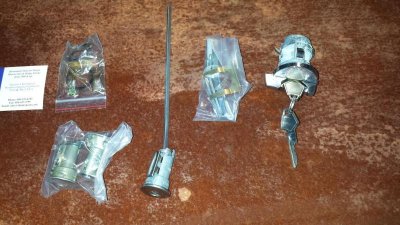

Small update. I got the ignition and trunk lock cylinders changed out. Now I am just waiting parts to start working on the engine and hopefully get it running.
In the meantime I got a line on a Big Block K-Member with Disc Brakes from a late 70s Imperial for $75. The seller comfirmed that the K-Member won't work but the brakes should. Can anyone comfirm for me that I can in fact use these brakes?

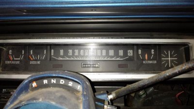

Here are some pics of the lock set and steering column as I did the change out. I also took the oportunity to photograph the odometer. It reads 09632 miles so I guess the car can have either 109632 or 209632 or even 309632 miles. The plate on the front was tabbed in 90s.
