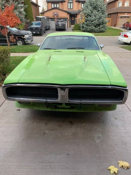

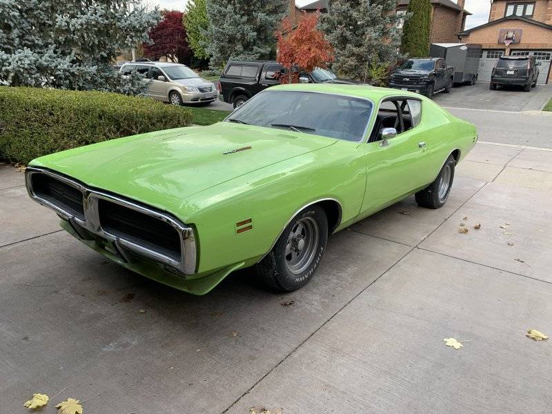

Heres the car. I've owned it since I was 18/19 years old. Been sitting for almost as long. Finally got started last year so excuse the photo dump.
She's a bit of a mishmash of other 3rd gens. It's got a 72 bulge hood I think, Some 72/73 interior pieces.
Prior to me starting it looked clean. But a lot was hidden well on this car. I'm in the midst of doing a full resto on it. In hindsight, I probably should've found a another car and used this one as a donor. But it's MY car so yeah :P. The plan is to build a great restomod thats going to handle well.

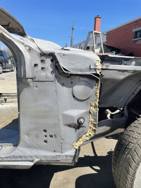

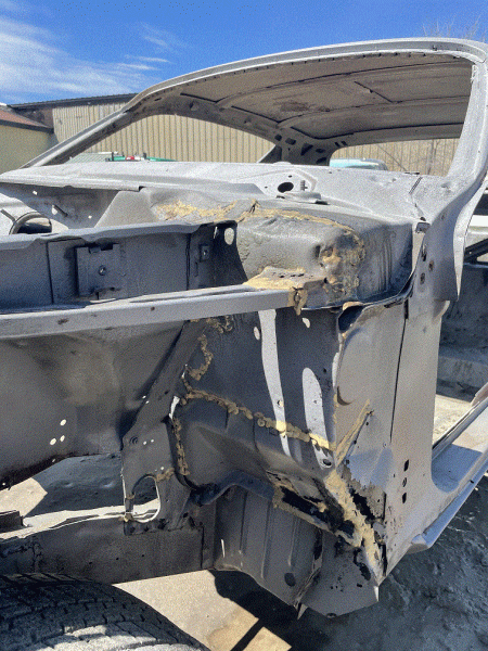

Ended up stripping it down over last winter. Bagged and tagged everything. Got the car blasted in the spring. Started to see the full extent of the work that was going to be invovled at that point. Should've hit the pause button then. But I don't like to quit, plus it was my wife's idea to start this. So I can blame her whenever it ends up going south!:thankyou:
Firewall and cowl area were rough. The drivers side floor pan was patched with a sign of some sort. The driver's frame rail was barely attached to the car. Mostly the inner fender and brace holding it in place along with the connection to the cross member. The cross member was shot, drivers frame rails had some gnarly patches. Rear trunk pan needed to be replaced, the rear rails were soft so opted to replace them too.

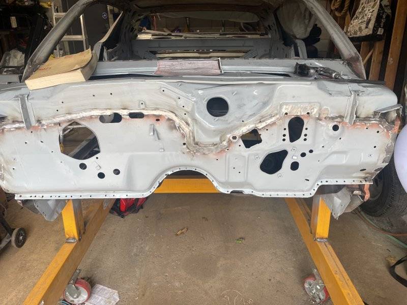

We got the new firewall in from moparmarks (Thanks!), along with my cowl and windshield trim repairs. Test fitted the windshield. Seemed alright given there is now 4 cars that make up my front end. It was a bit high on the bottom corners, but we massaged the top of the cowl a bit and it sat flatter.

Video on the firewall install. Floor is almost done so I'll have a video on that soon.
Nice! I commend you. Did a complete firewall and cowl on a 73 Cuda and it was a ton of work.
