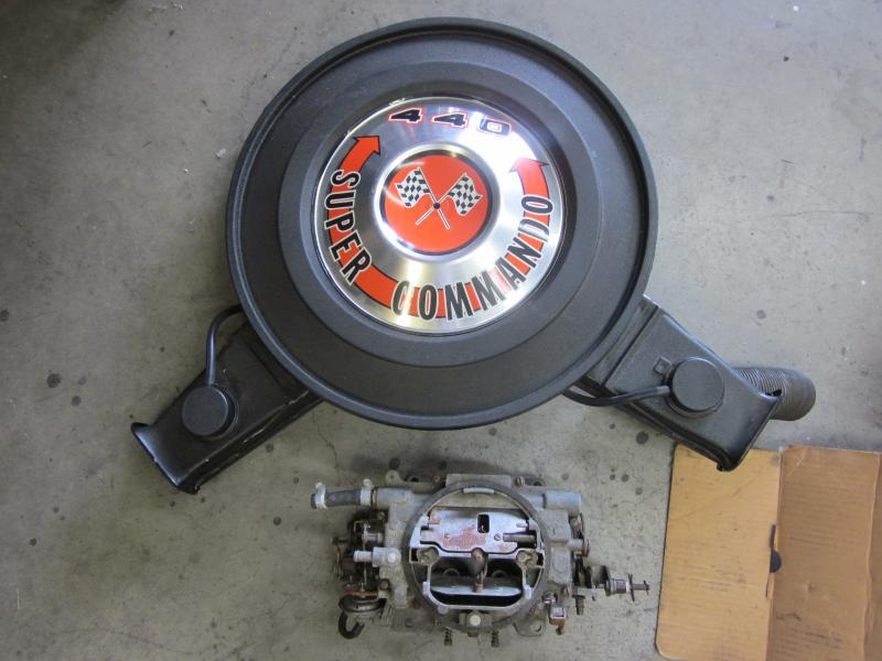

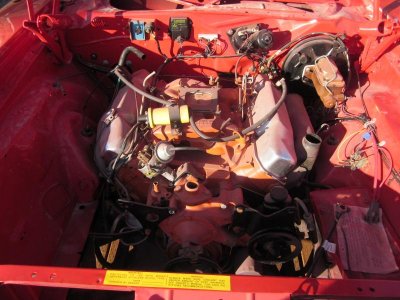

I went through the carbs that I took off my Road Runner this weekend. Had to replace the blown power valve. I installed a power valve protector and put Quick Fuel jet plates in the end carbs.
I also installed the idle mixture screws from Six-Pack Solutions in the rear carb. They come with the ball tip allen head so you can adjust them from an angle.

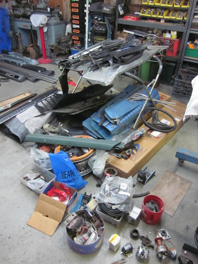

The car has a lot of hardware store nuts and bolts. I have been replacing them as I go. I got one of the Eastwood zinc plating kits and it works pretty good. The parts have to be REALLY clean to get a good finish. Here's some of the firewall bolts that I did today.
When I was going through the carbs, I found that the diaphragms in both end carbs were torn so I had to order new ones. There carbs are back together now and on the engine.

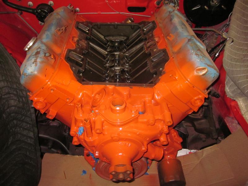

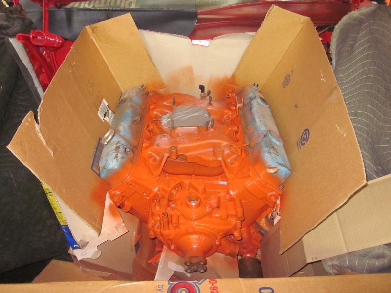

Between hunting season and SEMA, work on the GTX has been a little sporadic. Here's an update of what's been done in the last month. After I detailed the engine, I realized how nasty the front suspension actually looked, so I decided to pull it out and go through it also. Had to do some creative cribbing of the engine to drop the k-member.

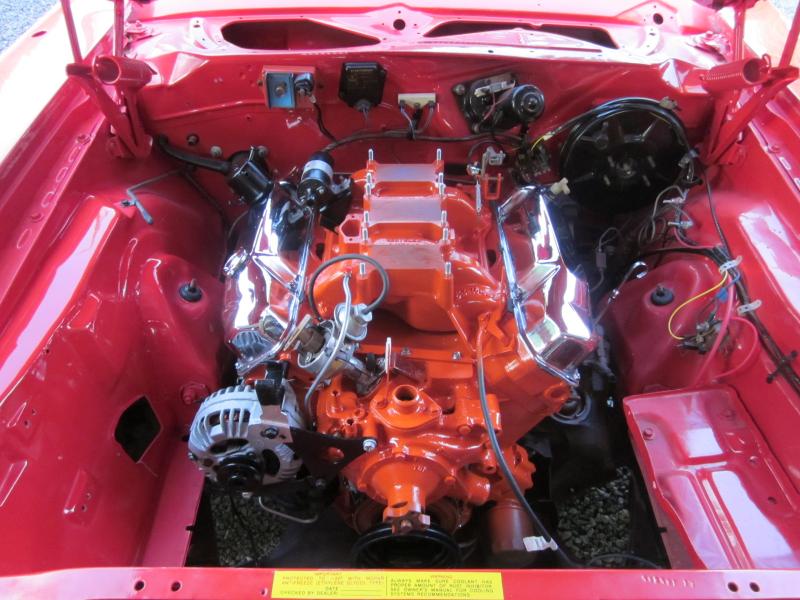

I installed the coated exhaust manifolds and finished the master cylinder and brakelines. My original passenger side exhaust had cracked and been repaired. I replaced it with the re-inforced '72 & later style to avoid future issues.

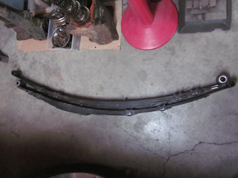

I have been trying to get my 24 X40 shop that has been used as a storage unit wired and insulated so that I can get it drywalled and move out of the little shop that I have been working in for 10 years. I will post pictures this weekend of the progress there. I did take a few breaks from that to work on the rear of the GTX. So far it's got new HD leaf springs, poly bushings, KYB shocks and new brakelines after a clean and repaint. Next is the brakes and fuel tank. I had to dig through the parts pile and find a set of backing plates. It looked like at some point in the cars life it was drug around without wheels and flattened the bottom of the backing plates.

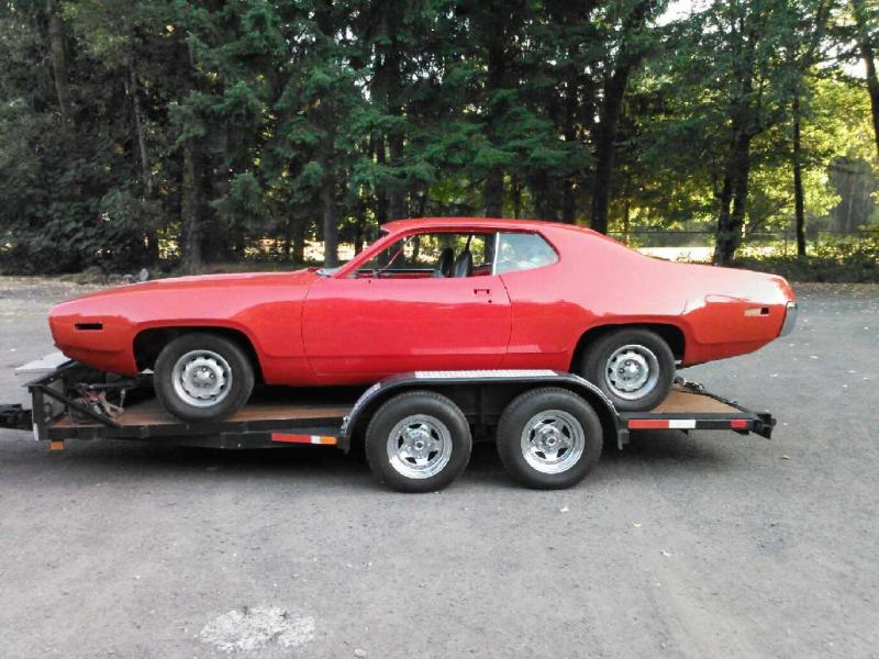

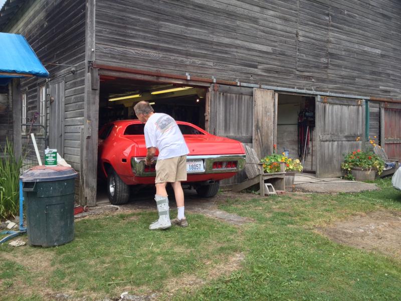

Back on it's feet and driving, we're headed to DMV to get it licensed in Oregon since it's from Washington. Everything went smooth and it's permanently tagged with a blue and yellow Oregon Plate.

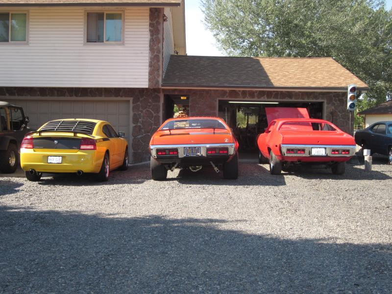

The last month and half has been about getting my shop finished. It's been an empty shell without electricity for about 9 years. Made a great storage unit but here's what it looks like now with the GTX in it's new home.

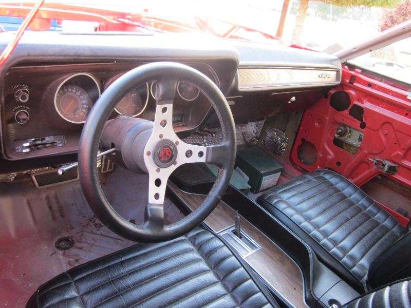

Now I'm going to attack the dash wiring gremlins and install a new dash pad.
