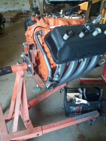

I'm of the understanding that the stock Hemi manifolds didn't use gaskets. I may be making a big mistake, but I just had a set of reproduction Hemi exhaust manifolds surfaced and bought the correct bolts and conical washers to attach.

When restoring my 440 powered original engine Superbird, it also had no exhaust manifold gaskets, and as they were the original manifolds, I replaced them without gaskets and did not have them surfaced. No leaks there either.
