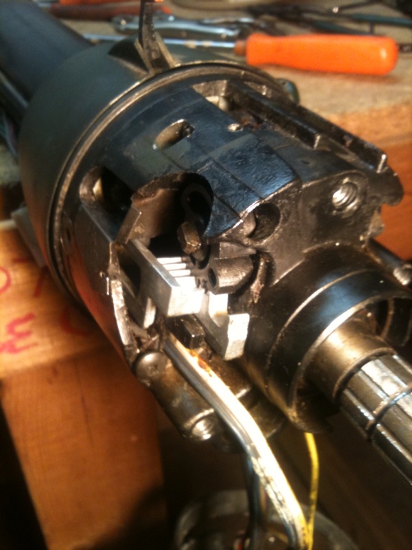

does anyone know if there is a place to get parts for a tilt wheel column in a 1971 ssp?
Took it apart to tighten and locktite the 4 loose bolts in the knuckle that were really loose..
There is a plastic gear track in there that travels up and down when you turn the key switch to start the car
and the very last gear tooth on the track is missing so we need a new gear track ..any info of were to find one ? Or if they will work out of a standard colum ? Thanks guys

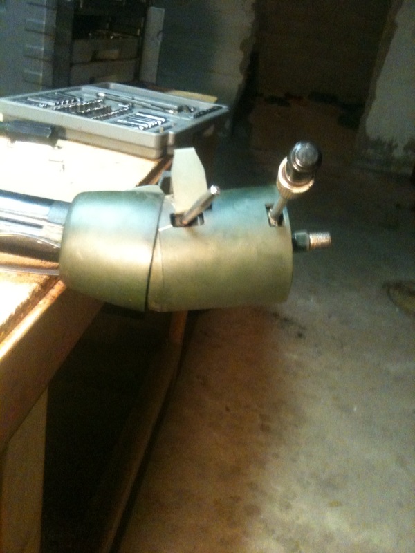

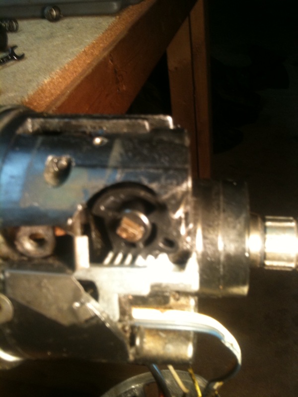

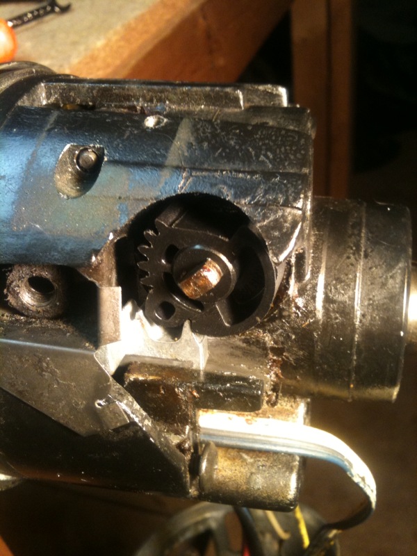

sure after we get it back in...i just got the new steering gear box that should go in first and also its easyer to swap in the clutch peddles with it out..but will add some pictures of it on the bench with new gear in it
These first pictures are of the new gear

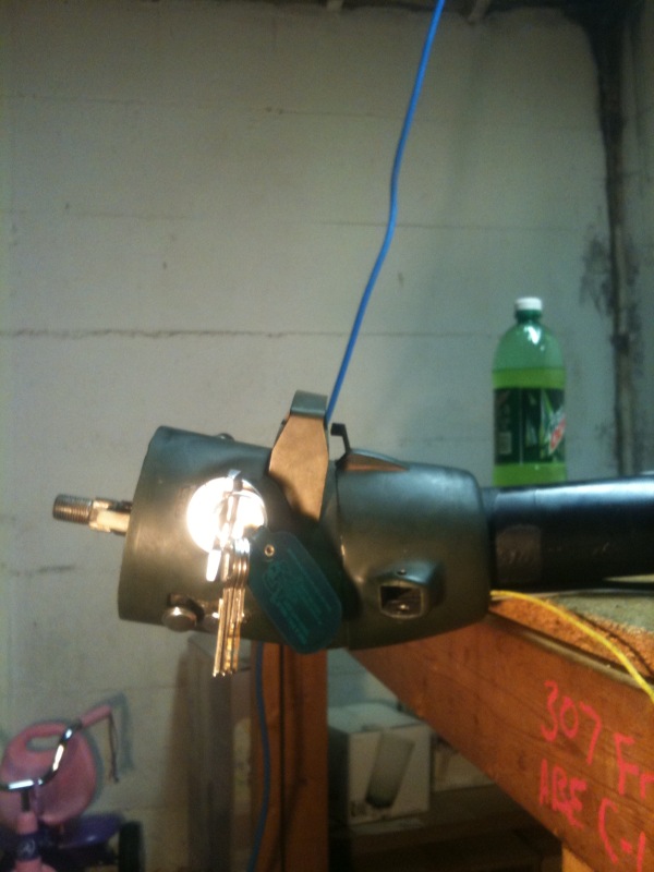

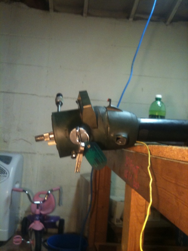

NOW HERE IT IS ALL BACK TOGETHER... NOTICE THE KNOB ON MY SIGNAL LEVER IS FACTORY CRUISE CONTROL..
I WANT TO THANK YOU ALL AGAIN FOR YOUR INPUT AND ADVICE AND A SPEACIAL THANKS TO MY 23 YR OLD SON MIKE FOR DOING ALL THE WORK ON IT 4 ME :3gears:
