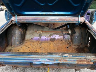

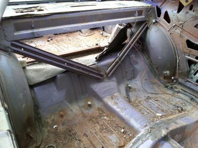

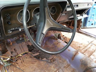

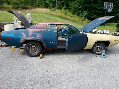

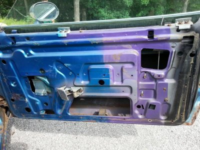

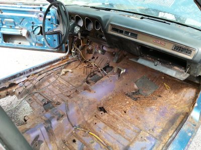

I just got this car yesterday and its going to need a lot of work. Just wanted to document how it started. I am a novice so I have no clue howlong its going to take. Estimate would be a year. Most parts are here but I has a lot of options to restore. Ps, pw, pb, buckets, fc7, dual racing mirrors, buddy seat, light package, 3 speed wipers, hood/fender turn signals, am/fm, tinted glass, 26 rad. It was column shift updated to b&m shifter in 80s would be my guess. Has original shifter so not sure how I will go back. The b&m looks very cool that's for sure. Also white vinyl top was later added by the factory so I will be putting that back on. Here are some pics. This car deserved to be saved. The place I got it from fixed the front fenders so that's why there in primer. Was debating dropping a hemi in it because I believe now its just a period correct 440. Let me know what you guys think

i would love to be working on that right now. I , myself , would be restoring it the way it came from the factory. either way, you have an awesome project. the first thing I would do is throw that shifter in the trash
She'll be a looker for sure, love that color combo!
Looks like a lot of work and a lot of fun...good luck and keep us posted.
Very cool color combination. It's your car, restore it the way you would like it.
If it were mine though, I'd take it back as close to original as I could. I restored an original FC-7 Challenger R/T several years ago and it's a very striking color. The Challenger had a black vinyl top though. I've seen cars with the purple / white combination and they really look good.

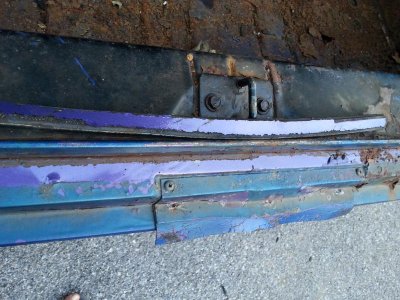

Yea it has 2 fender tags. N41 n42 p31 r36 v21 j25 l31 m21 m25 m31 c21 c55 g11 g33 g31 h51 fc7 a01 a04 b41 b51 p6xw tx9 b27 (think this is build date not an option) e86 d32 v7w 26 think that's all. I saw your challenger its beautiful. Here's a good pic of the original paint on my car. This is under the weather stripping when I removed it. The paint stayed on the car and on the bottom of the weather stripping so the removed weather stripping is in the pic upside down

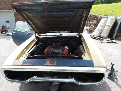

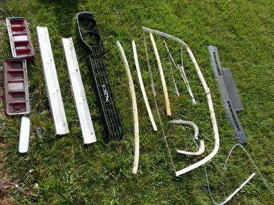

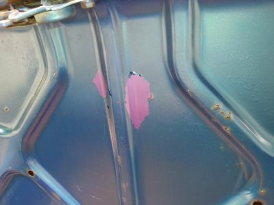

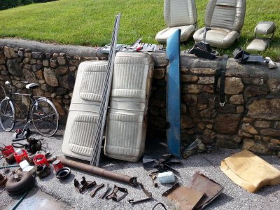

Nice gtx steve was it original rear spoiler car? I wish mine was I love the look. I disassembled a lot of the nose today and took some pics of the original s tampings. I am going to need a new rad core support. Also my car didn't come with a radiator so if anybody has any suggestions please me know. The motor will be a little more potent than factory so I want good cooling. Take care. My phone or the website wouldn't let medrag the pics to upload them so they will come later

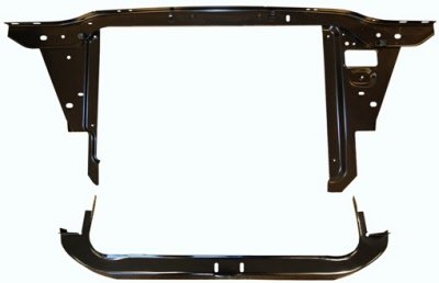

I would recommend giving Auto Metal Direct (AMD) a call. They have a good web site and you can order all of the parts you need brand new from them. I would recommend keeping the stock 26" wide radiator opening when running a big block anything.
Another choice would be to get these parts from a decent donor car, but my experience has been that 95% of them have damage on the lower half that is located below the radiator. Try giving Mopar Marks a PM. He may have what you need.
When you get into removing the old parts, keep the original cross support that goes along the top edge of the radiator. On this piece there should be a partial V.I.N. number stamped into the metal. This number should match your door decal, dash VIN, etc.
Use a good spot weld cutter to remove the original metal.
If your serious about keeping the engine cool, and are not too overly concerned about keeping a factory stock appearance, consider getting a good quality aluminum radiator. I used one in the 70 Challenger I restored that had a Stroker 440 (500 cubic inches). It would stay at 180 degrees all day long, idling in traffic with the AC on, during the hot Florida summer, etc.
