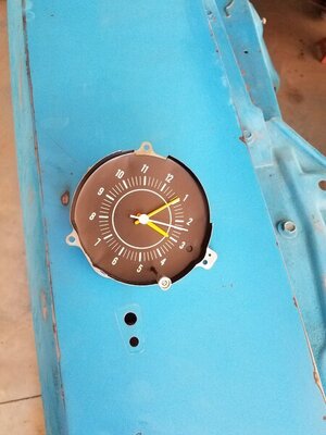

Anybody know how to repair these? More specifically...has anyone here disassembled one? Was hoping to simply oil it and get it working again, but like a good car guy, i created more work for myself by breaking the seconds hand trying to disassemble.

i bench tested it...it's a no-go.
thanks to all who responded....especially NachoRTg74....excellent info. Being that i broke the seconds hand and will probably break more things trying to get it apart, i decided to send this off in Instrument Specialties.
