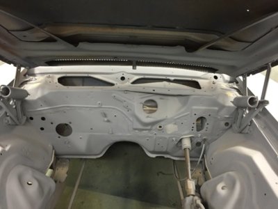

been raining and busy so was not able to get picks of the car as they reassembled it and coated it with primer sealer. They started with prep work with replacement trunk lid with factory spoiler cut outs and the upgraded hood.

Body shop is starting with 26in radiator support conversion from Ed At ‘The MOPAR Shop’ and preping the bodywork. AMD cut-out rear valance from Ted and Jackie from Steven’s Performance and will be prepped next.
