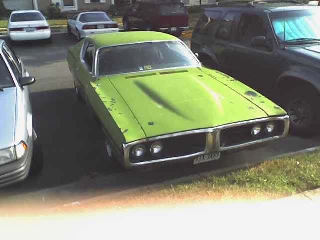

About one month before purchase

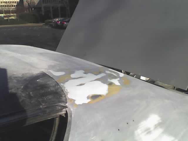

After I did the dent filling, rust chipping, priming and blocking. in background is some Air Force art.

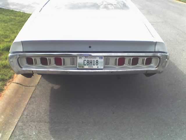

A little extra smoothing on the sail panel.
