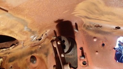

Well I am getting underway on my restoration and I have to say my heart sank when I finally got around to taking off my brake pedal assembly and saw what I saw. I started sanding some to see how bad it is and it got even worse. Now I am not sure what to do. I honestly do not have the money or know how to replace a firewall but don't want to neglect something that could be a serious issue down the road. Would anyone have any suggestions to an easier fix to this problem? so far it only appears to be in the crease where the firewall is on top but I havent gotten to much further into it for fear of damaging it further. My idea was to finish getting out the rust then seal the metal and possibly use body filler but I don't want to half *** it either. I am just thinking that no one will see it and its not something that will be as weathered as say a quarter panel. Is that something I could patch with metal given its location? Any ideas or suggestions would be much appreciated. I am so down about this right now I am think gas and a match but I could never commit murder on a chrysler :). Also, one more dumb question, does anyone have a how to on how to get the emergency brake assembly out? it looks to me as if the bolts go into the fender but I just dont see how that would be possible. Thanks again guys for reading my post and sharing your thoughts with me.

looks like its right along the seam that the 2 panels come together,very common,you can find used panels to replace it,would need lower cowl panel,also the e-brake has 2 bolts that run inside the drivers side wheel well,usually has a bunch of road grime on them,clean them with a wire brush,and wd-40 the crap out of them,and hope they dont break when you take the nuts off.
Grind it as best as you can. You want to get rid of all the loose rust that’s in there. Epoxy or etch prime it. Then cut a piece of sheet metal and fabricate it to fit. You could weld it in or use this stuff that works great called Fusor. I used it. It’s a two part caulking that you would need the gun for it. I would also check under the cowl screens for any other rust.

Cut out the rust weld in a new piece from 16ga sheet metal... rent a welder and prime with a rust encapsulation primer and paint so it doesn't come back replace the original insulation with a product that doesn't absorb water and check for where the leak is that caused the problem like the windshield weatherstrip
Depending on what your skill set is, I agree with all of the above posts. You don't need to go all ape sh*t crazy on this. Odds are it will never be seen and like with my rig- she ain't NEVER gonna be 100% perfect or concours worthy. So just cut out what you can, clean off the rust as best as you can, stitch weld a new section in and call it good. If you can't do that or don't wish to (I wouldn't blame you if you didn't) then hit it as best as you can to get rid of whatever loose scale is there and to get rid of whatever weak metal is there. Personally I'd hit the good metal left over with POR-15 or Rust Bullet and then either fill or glue what you can to make it right. I've had a hole in my Jeep CJ upper cowl that I just cleaned up as best as I could and filled with a filler that had alum in it to make it stronger than bondo and it has been right as rain for 8 years now. Then again I could get to the back side of it. In this case (I don't know your body style horribly well), I'd say do as best you can, kill what rust you can and fill it. You'll be fine.
I do have a mig welder I am pretty handy with. I am going to clean as much out as I can and see about welding in a few small patches. If I can't I am going to kill the rust and seal and fill it in. Thanks for all the advice guys. It's nice to be able to bounce ideas off others and get some bearing as to what to do.
If interested you should check out my post on my floor board patch. It was a 1st time outing for me and it turned out okay. Seems as though a willingness to do the job right is the main ingredient. :icon_winkle:
That rust could be A LOT worse.
The cowl on 71-74 cars is a leaf and dirt catcher, and lots of them are rusted around the vent opening, where yours is not.
For the size of those holes, I agree that cleaning and durable filler or epoxy could work, if you can't get your hands up in there to patch with metal.
A friend of mine (who's much more patient and a better welder) just removed the top cowl panel, and fixed his lower.
That's way beyond my skill set right now.
One trick is going to be getting some sort of sealer (and cleaning, for that matter) on the top side.
My firewall and floors were a lot worse than yours, I patched mine with some stainless steel sheet metal I had laying around, a little filler, pop rivet and sealed it all up. I would love to someday cut it out and replace the firewall, but not in the budget, I now drive mine everyday!!!!
