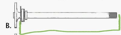

well... im an idiot. apparently the HOUSING is a B body housing, but the axle shafts are for a A body... Axles measure 27 11/16" flat from the outside of the flange to the end of the splines.. i apparently need 30 5/8" for my b body.. would make sense seeing its not engaging the splines on the carrier. when installing the axles, i did feel it "pop" into place, but its just shy of meeting with the splines. Damn.. anybody have some 8 3/4 shafts laying around for a B body? lol..

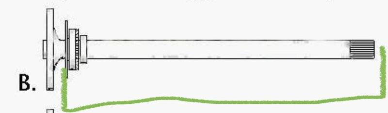

I very well may actually need 68-70 axles… measuring the actual axle itself, not the shaft.. from the inside of the carrier to the end of the axle tube flange I’m seeing 29 3/16”…. So this axles kinda funny, because the leaf perches are 47.3”, which is a 71-74 B body measurement, but my shafts are measuring 29 3/16”… which again, is 68-70… for a 71-74 8.75 it SHOULD want 30 5/8”… who the hell knows anymore lol.
Need ones with this measurement being 29 3/16”.
Start with the flange to flange measurement of the axle housing.
Sounds like maybe you have a 71-73 wagon housing?
