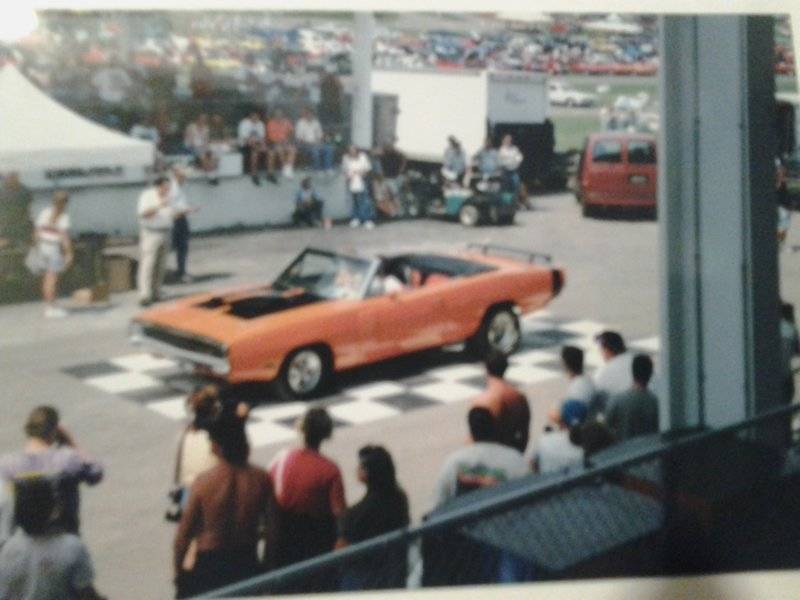

                When I installed the Sixpack hood scoop on my Charger convertible, I cut the hood and installed it from the underside with rivets. I have had only very minor cracks verses fiberglass scoops that I have seen attached on top of a steel hood. The scoop on my car has been on it since 1999. 20180430_225113.jpg
