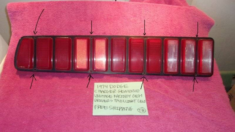

Hey guys,
I'm new to MOPAR and the site. I just picked up my Charger a few weeks ago. I was in the process of replacing my tail light bulb yesterday when I realized I don't know how to access it. I noticed a few wires in the trunk secured by a rubber grommet, but I didn't want to pull those out if I didn't need to. Do I take off the bumper to access the tail lights?
Remove the lens. 3 screws on top of lens I think.. I know a 71 satellite is similar.
You can see the screws in this picture in the black area of the light.
