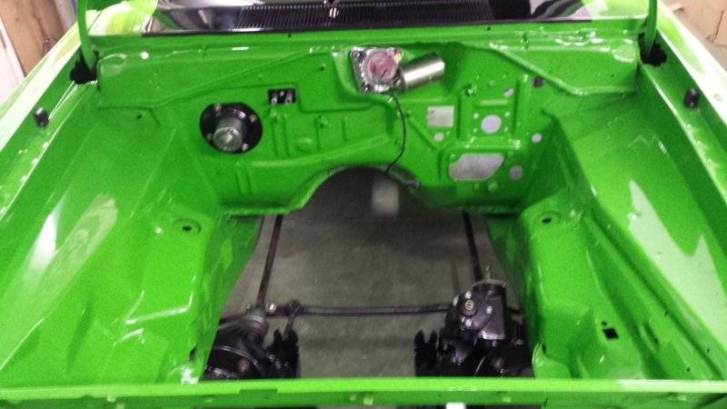

Thanks I see those holes now.I found a pic of mine before the engine install. You can see what he means about the oval holes. One drain below the heater motor and another more toward the right (center)

Also the blower motor fits into a rounded-triangular hole that has a lip around it.
it would be really hard to reproduce that lip.
hard to see in the pic since there's so much goop.
Was there foam in those hose and line pass through hols before the goop was put on?
That foam is nearly indestructible, even here in humid FL.
