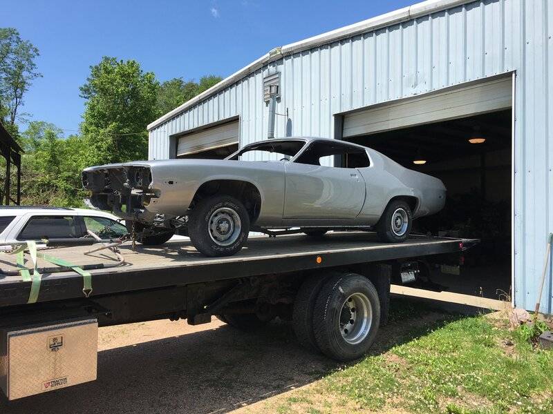

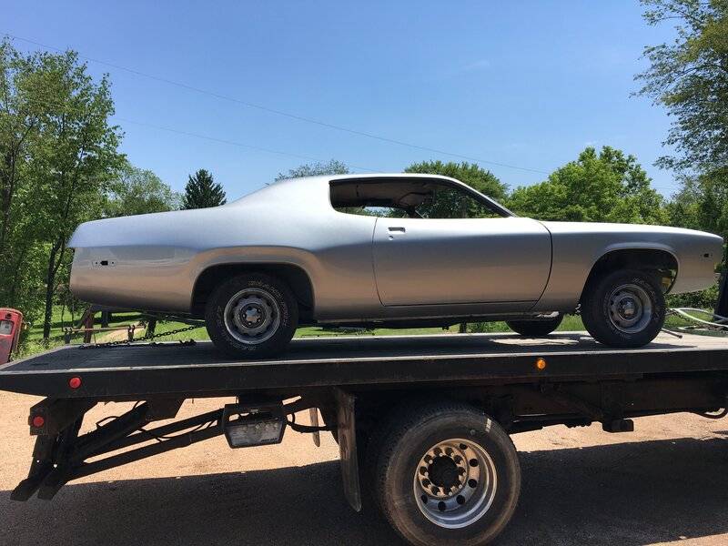

1973 Plymouth Road Runner Resto

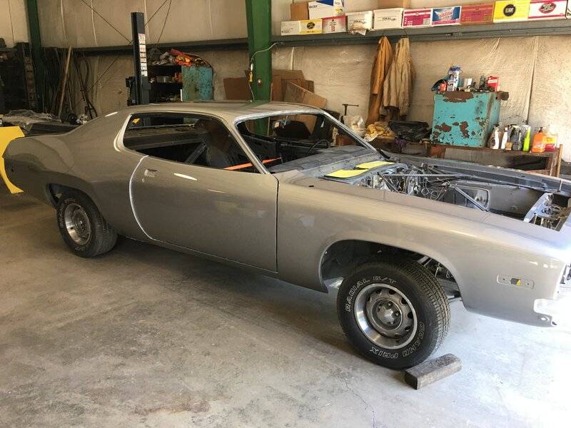

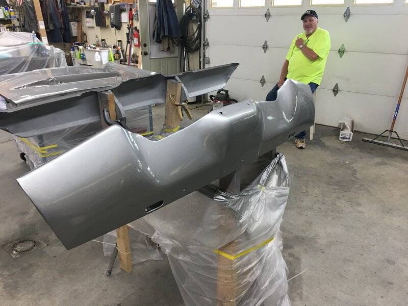

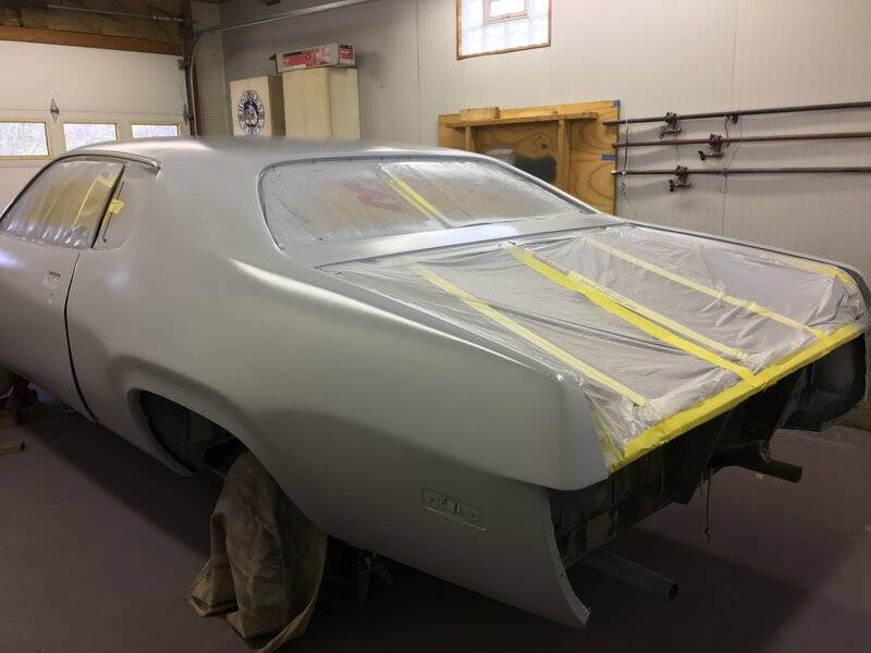

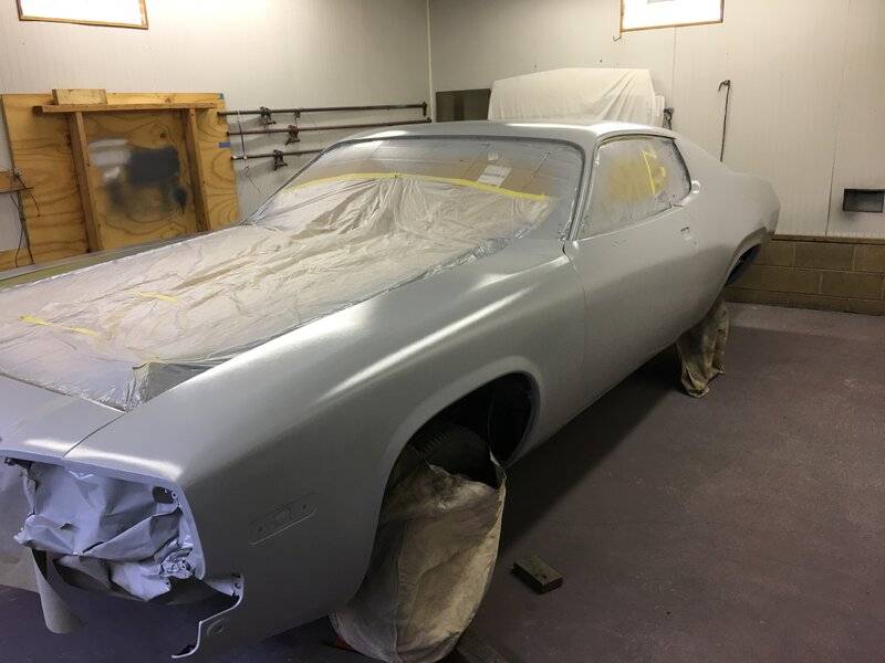

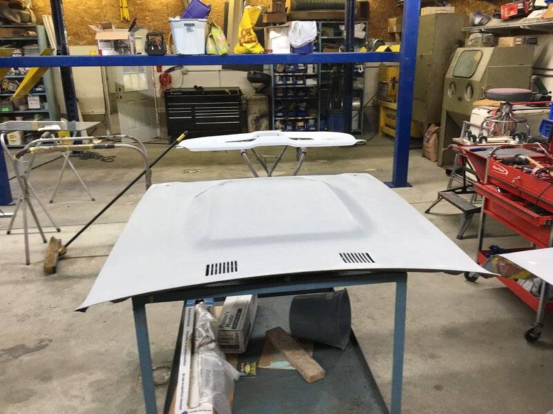

Okay guys I'm back and have been sanding on this 73 B Body finally got it in primer today , hopefully paint next week , Code A5 Silver frost metallic, probably going to use crossfire base/clear coat. Also does anyone have any feedback on where to order RoadRunner stripe kit , Classic has them but was wondering if anyone here on the forum has had any experience with them?

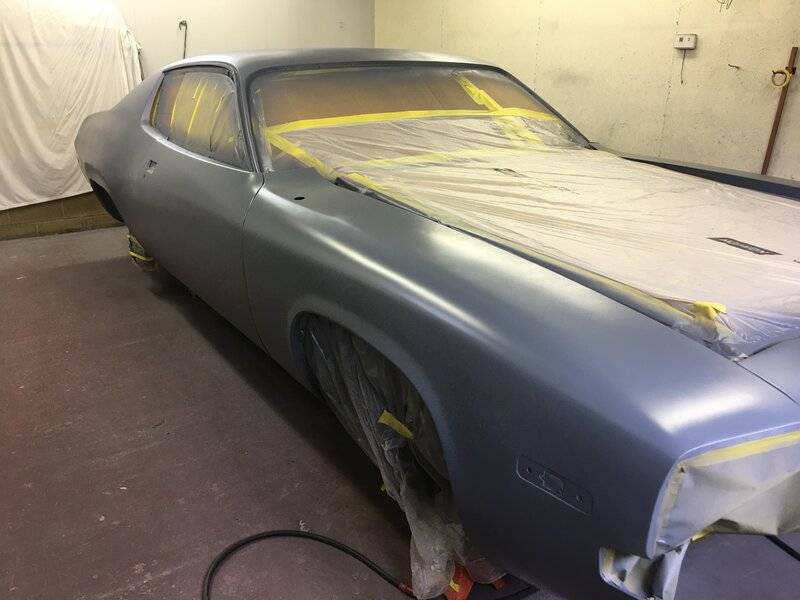

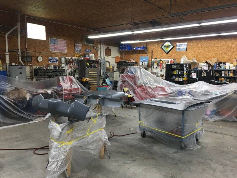

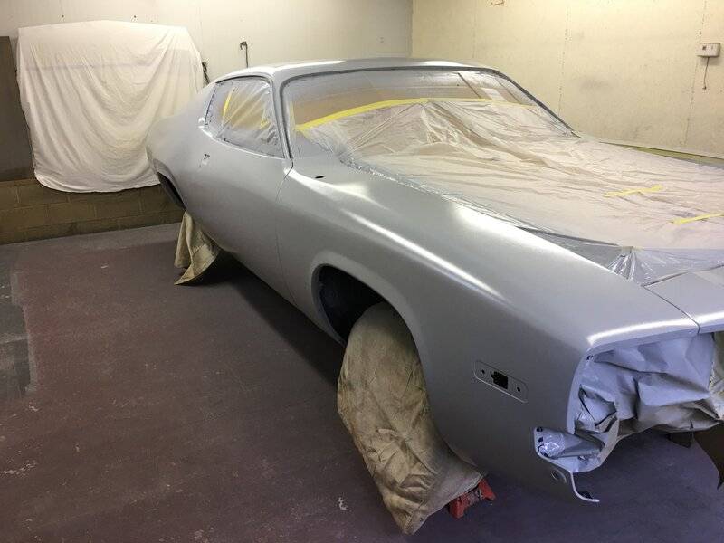

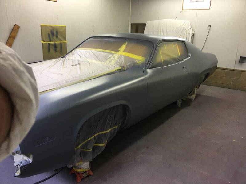

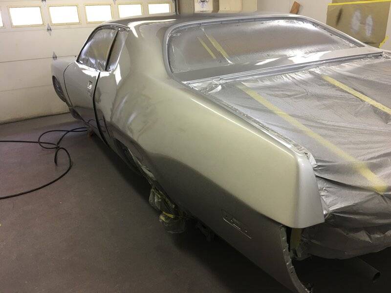

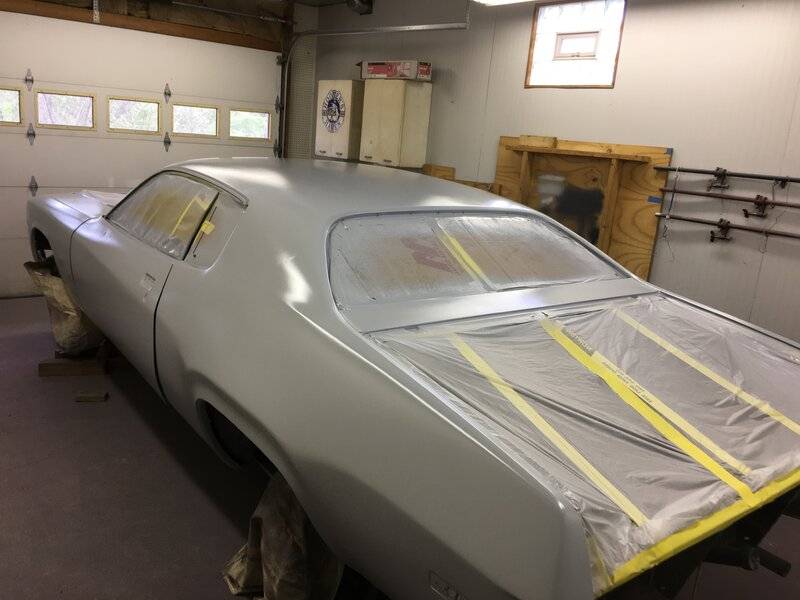

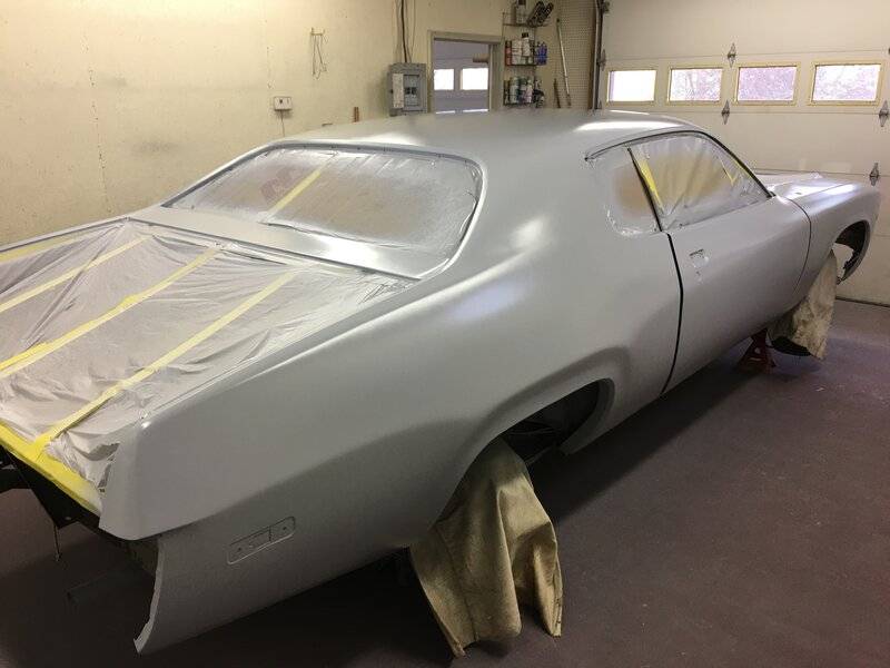

Okay Fellas , So I blocked the car out and cleaned it again , Used Finish Line Primer Sealer ( Acme/Sherwin William) and then Crossfire Base/Clear , The material laid out decent , you get what you pay for and this product was more than adequate and I highly recommend it

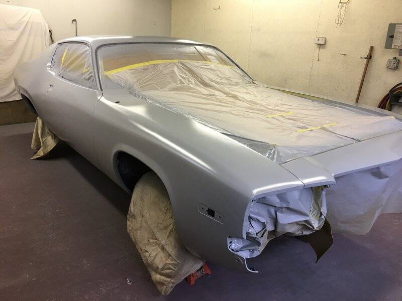

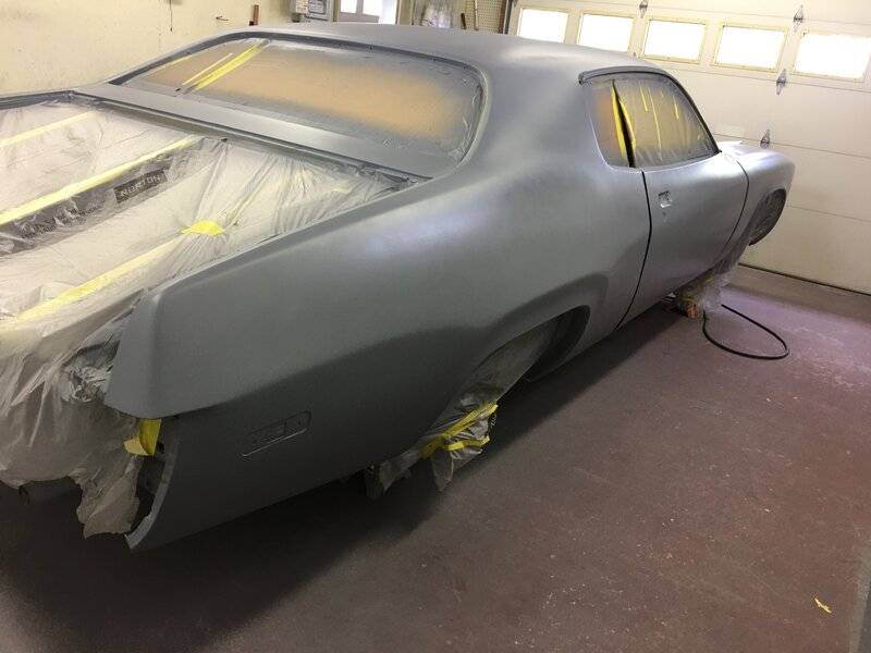

So Here we are after sealing

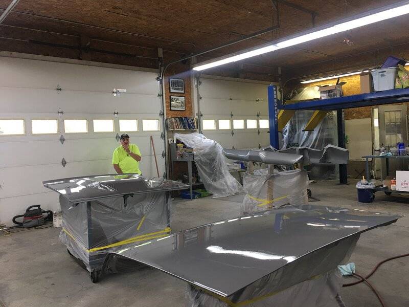

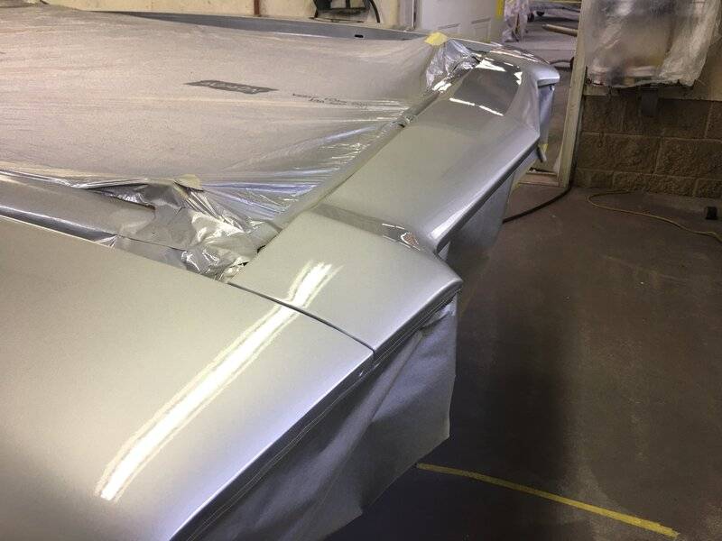

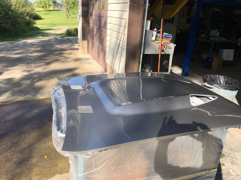

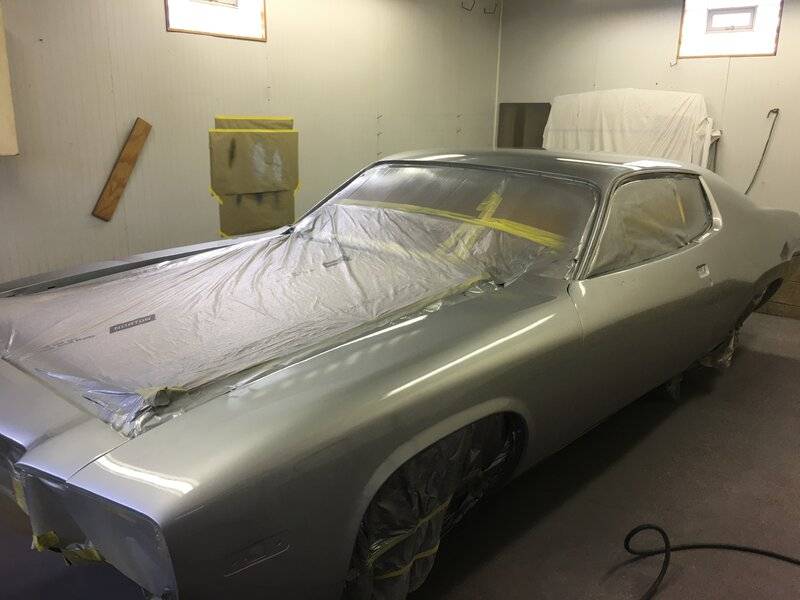

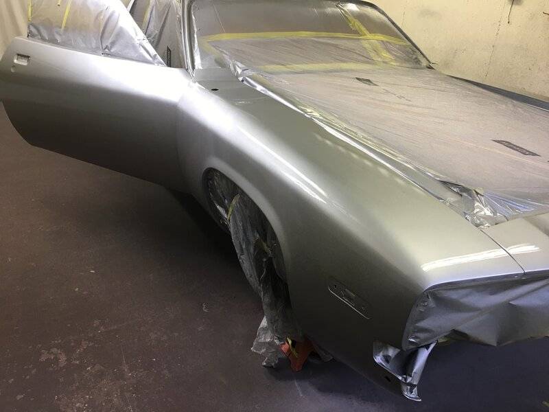

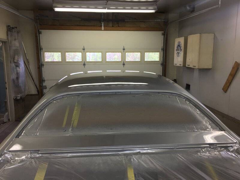

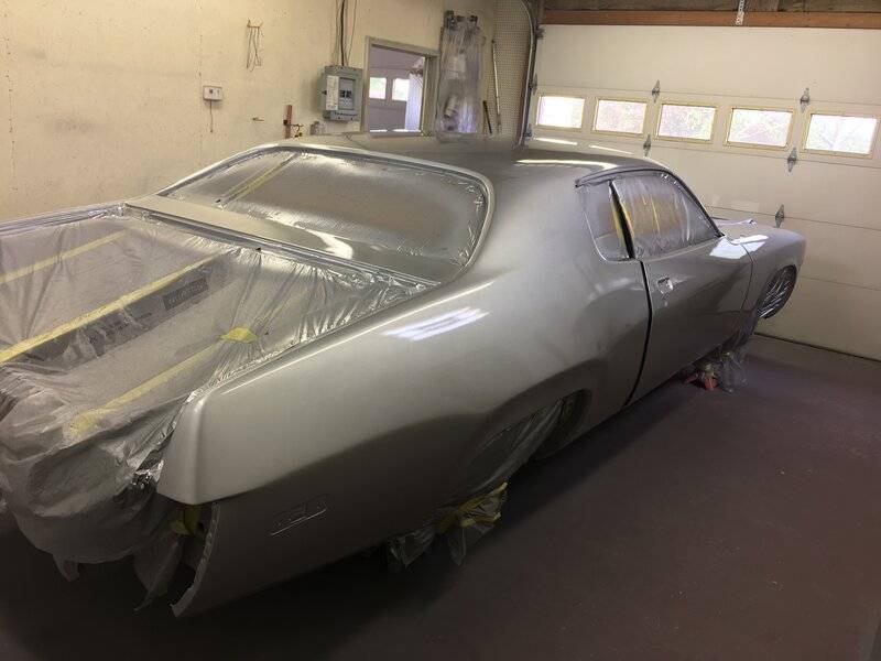

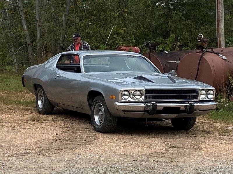

Now the Base and Clear , I could not get the clear to lay as flat as I wanted but was planning on sand/Buff with 1500 anyway , VERY VERY Metallic color and it laid out nicely

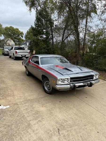

I will get one last post when I put the Road Runner decals on , our post office sent them back for a incorrect address so I am heading back to Florida for Red Snapper Season
Lookin' good!
