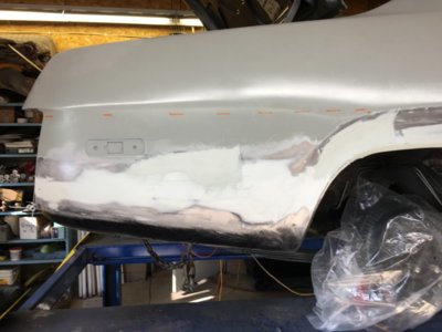

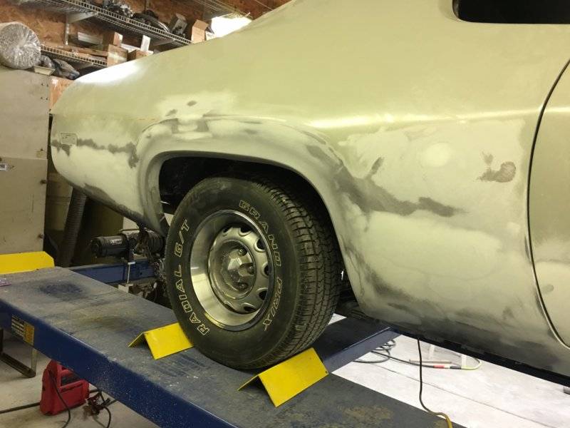

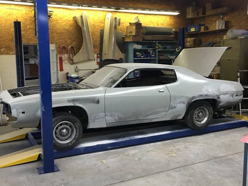

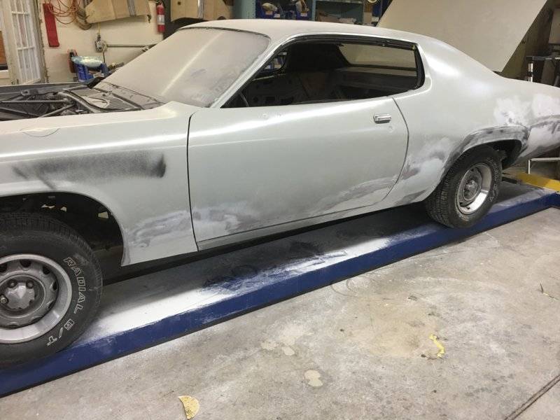

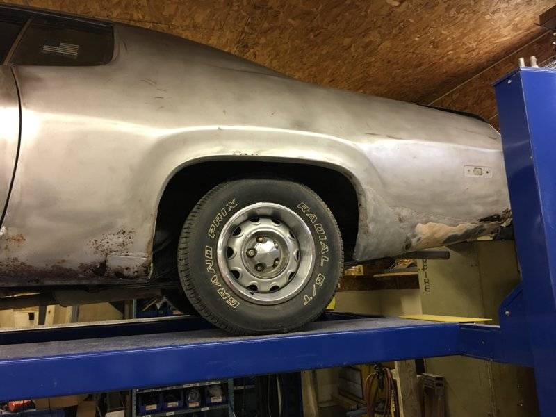

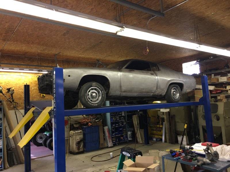

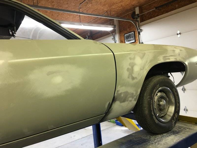

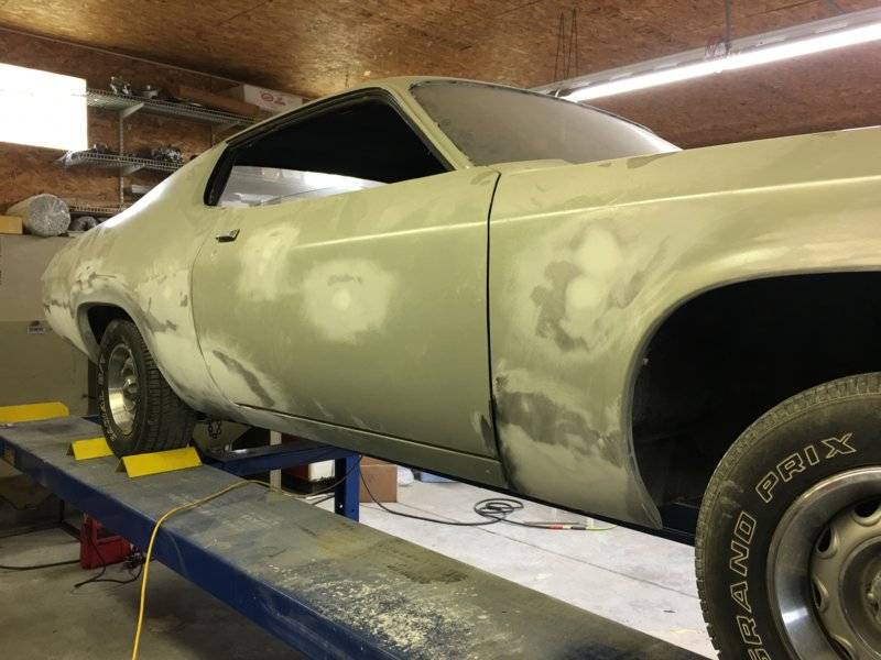

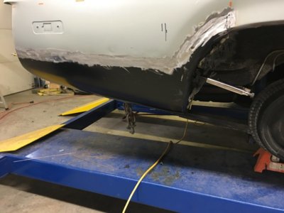

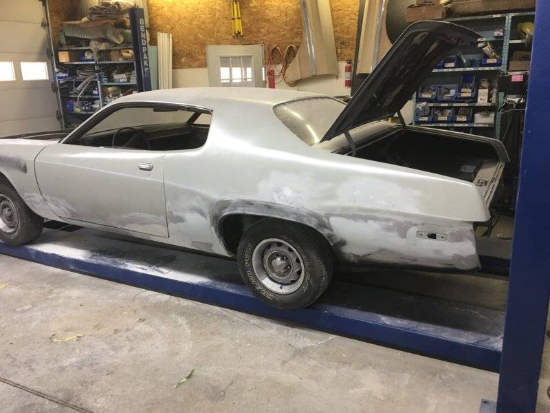

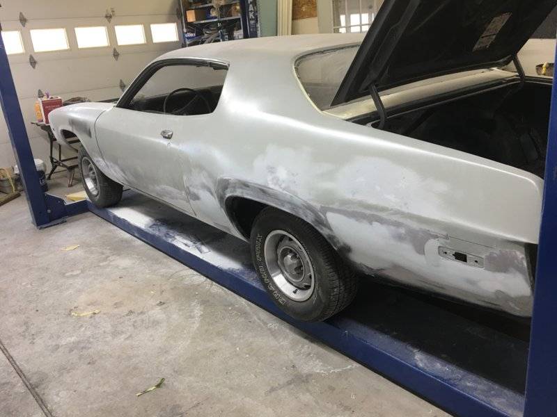

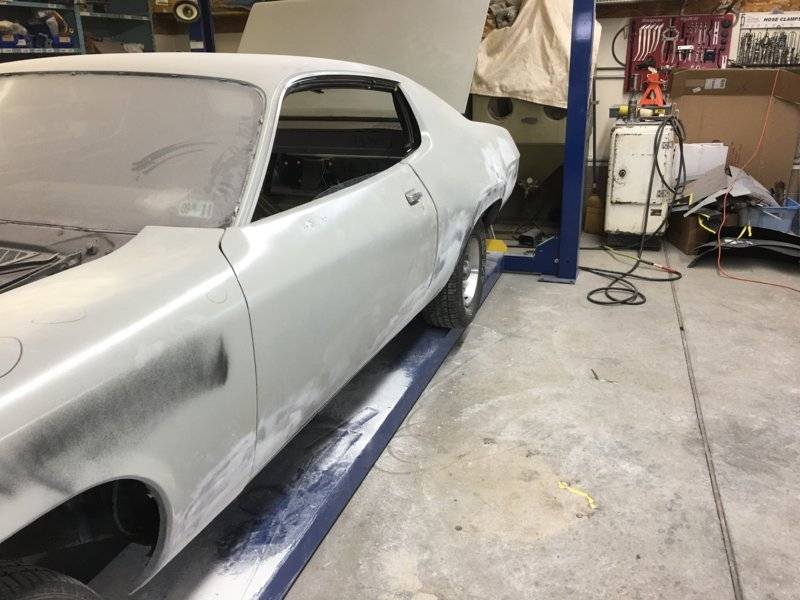

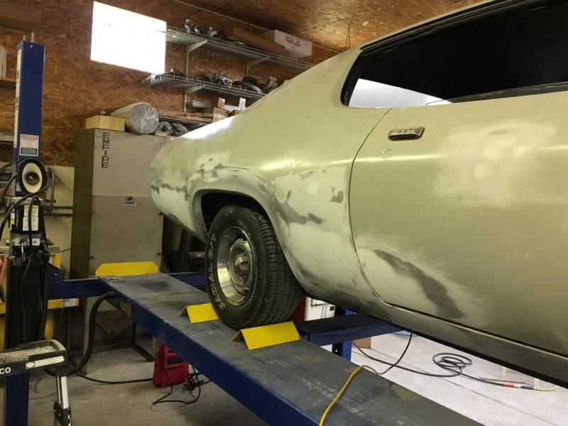

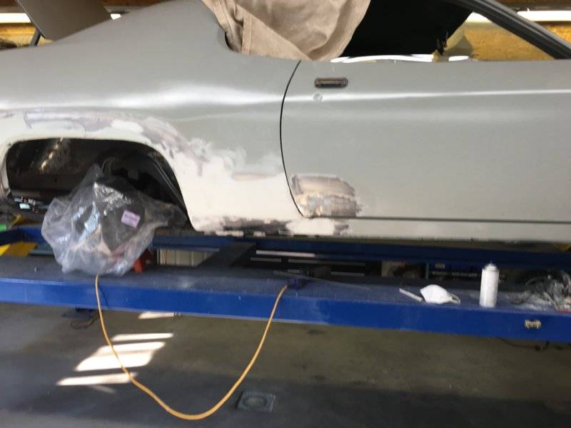

Here is the car initially after sandblasting , we had the dustless sandblast guy come in and for about 1200$ got the car stripped of the numerous coast of paint and then sanded it with 80 grit to prep for the the heavy build primer

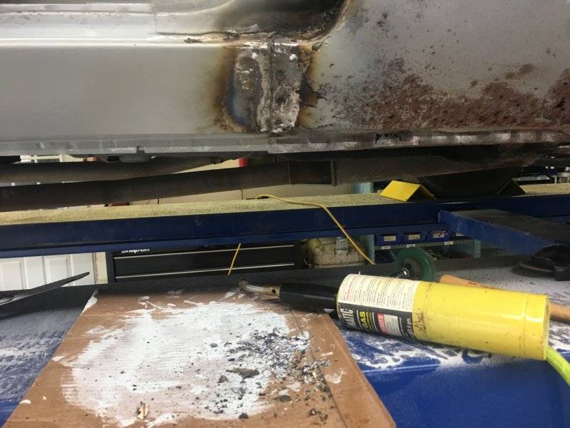

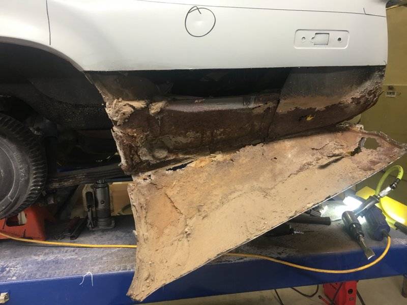

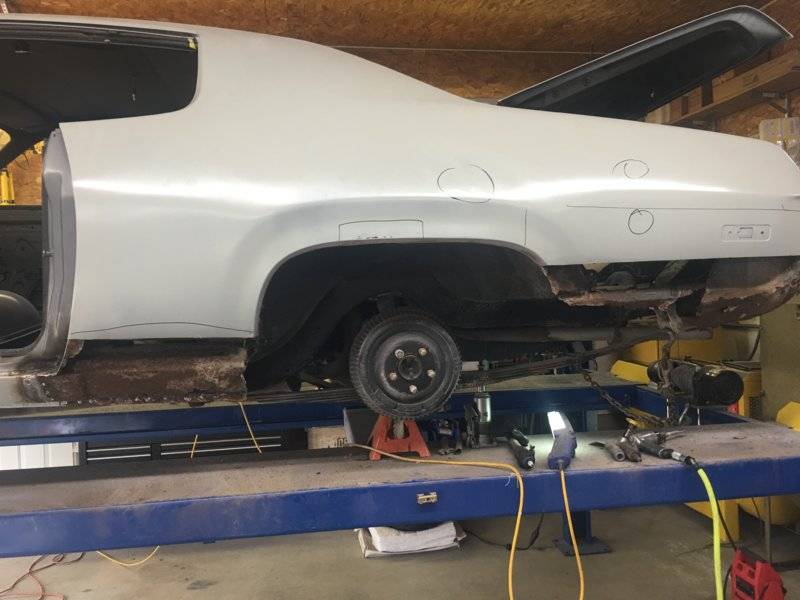

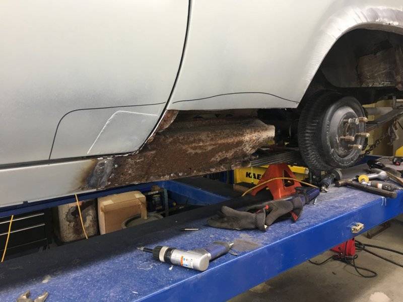

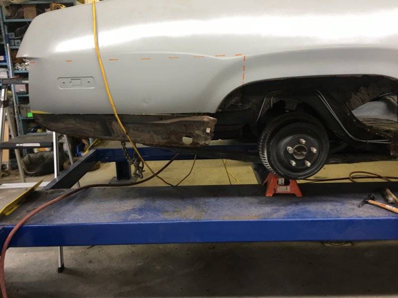

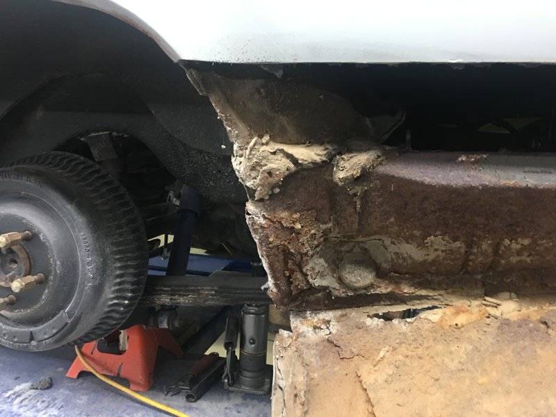

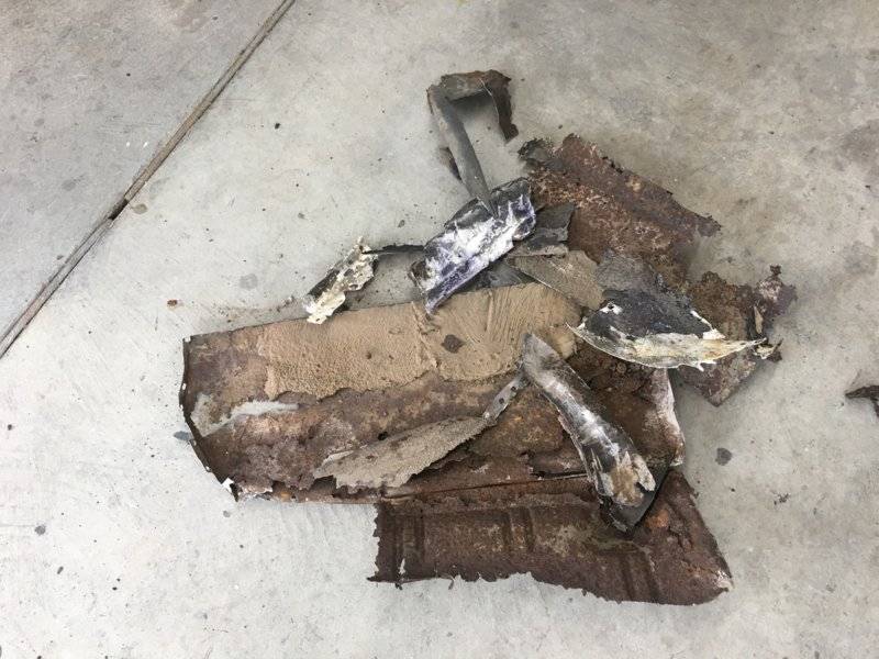

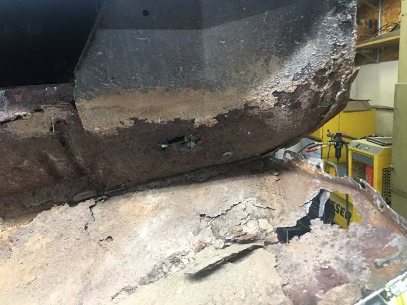

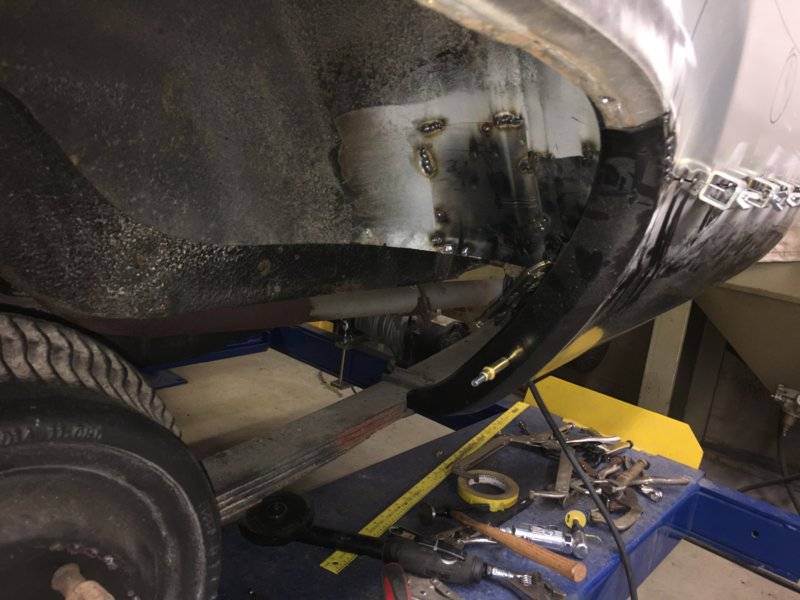

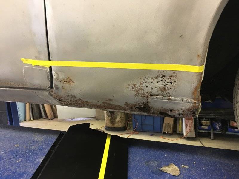

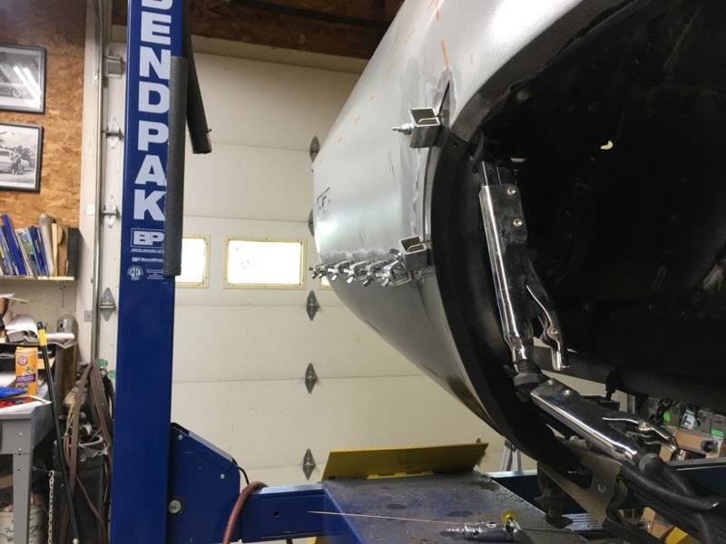

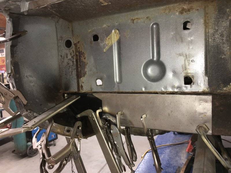

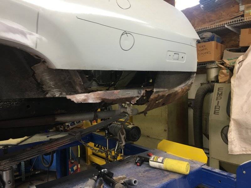

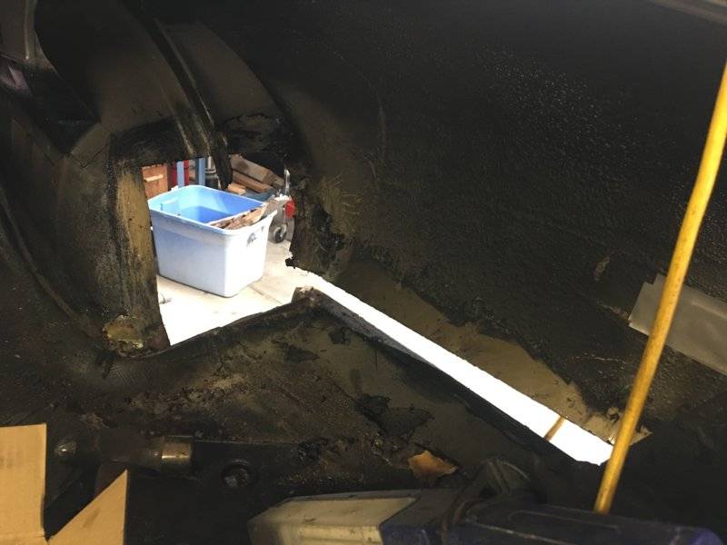

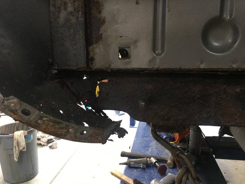

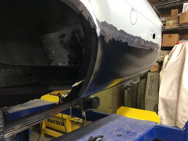

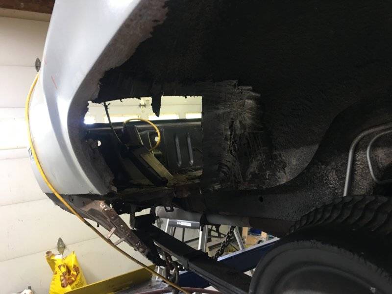

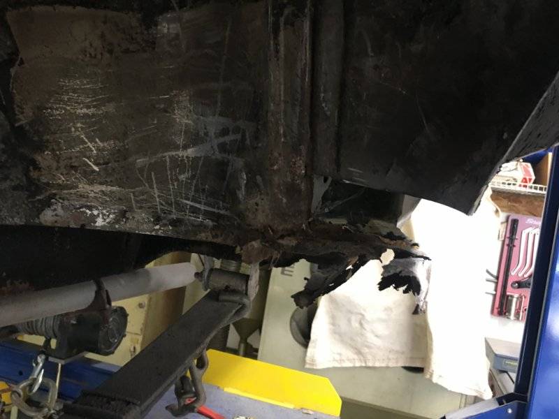

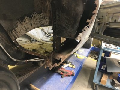

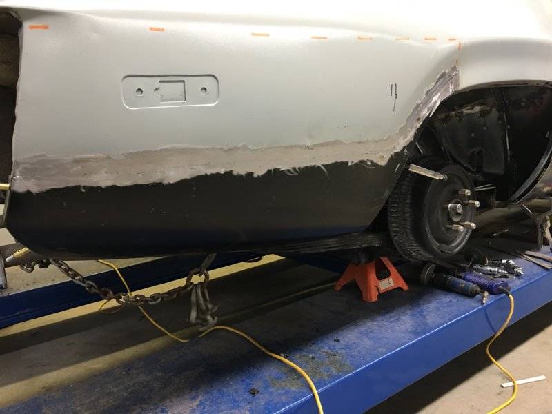

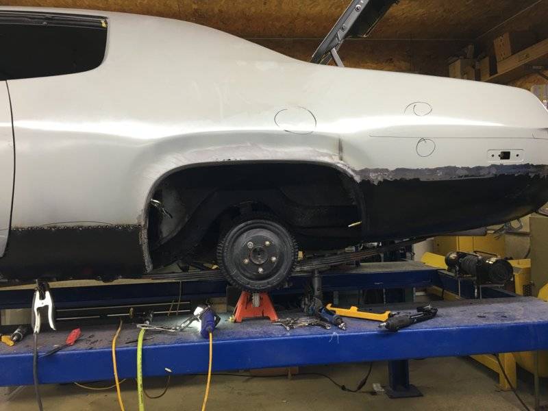

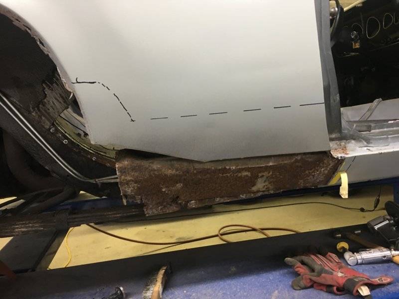

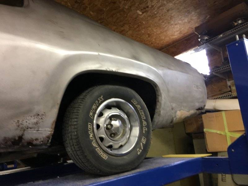

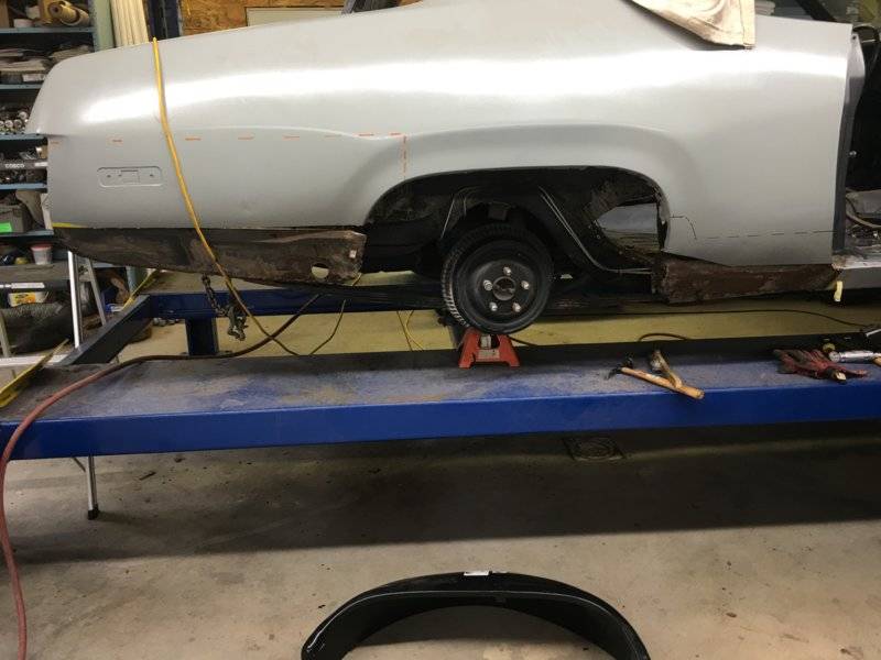

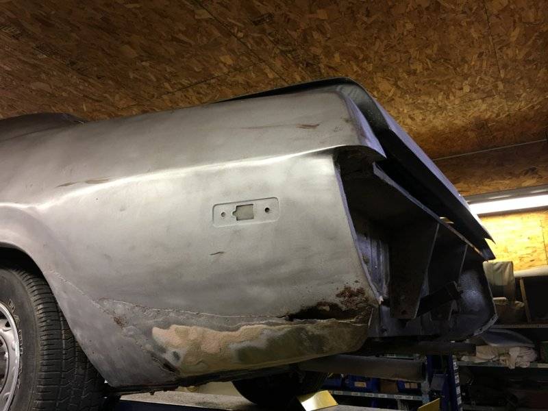

Starting on the passenger rear 1/4s first as the seem to be the worst , found a replacement patch from AMD metals for the rear of the 1/4 but they did not have the front patch, they did have one for a 71-72 that was really close on the fit with the exception for the actual wheel well lip and a body line that the 73 does not have , but notice the door edge fi and the shape of the inner rocker panel edge which were pretty much exact , I modified the WW edge to suit ( more on that later in the discussion )
Very nice job your doing. Its gonna look great when its all done. Thanks for posting the pics and progress.:thumbsup:

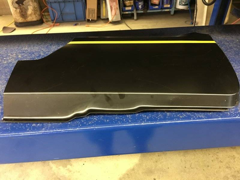

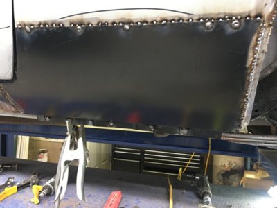

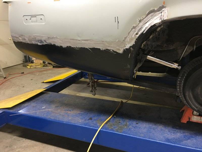

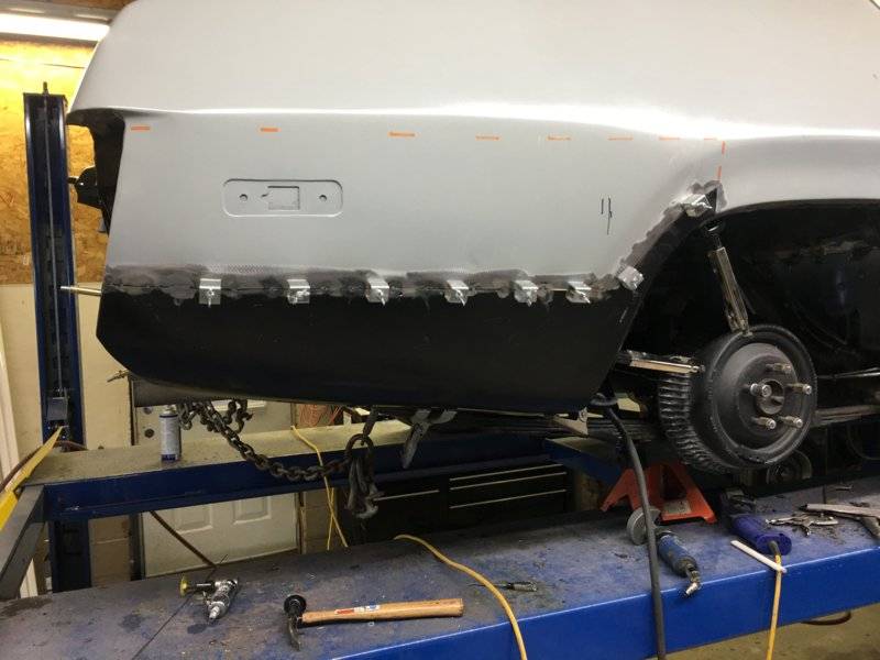

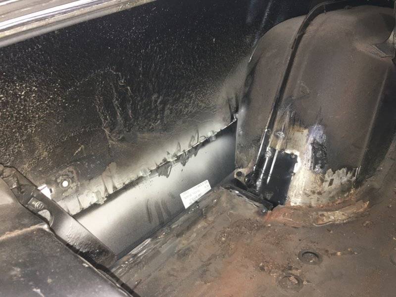

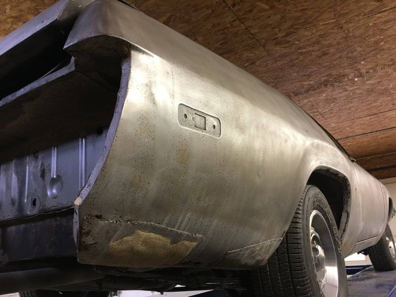

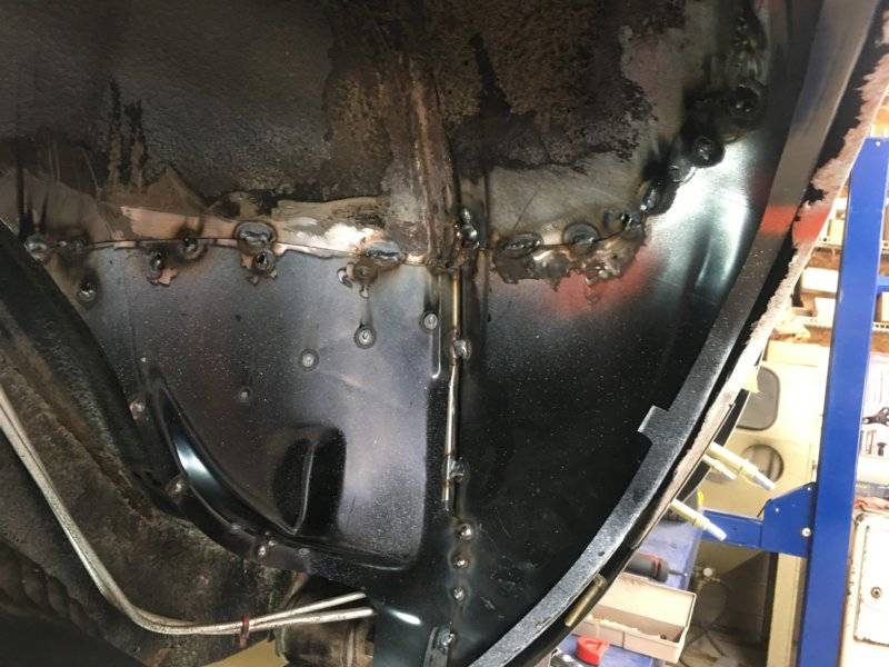

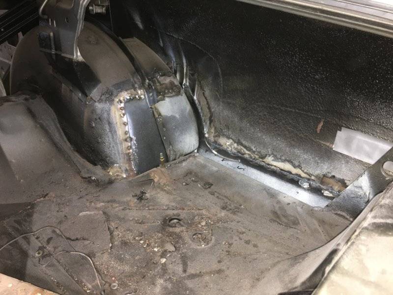

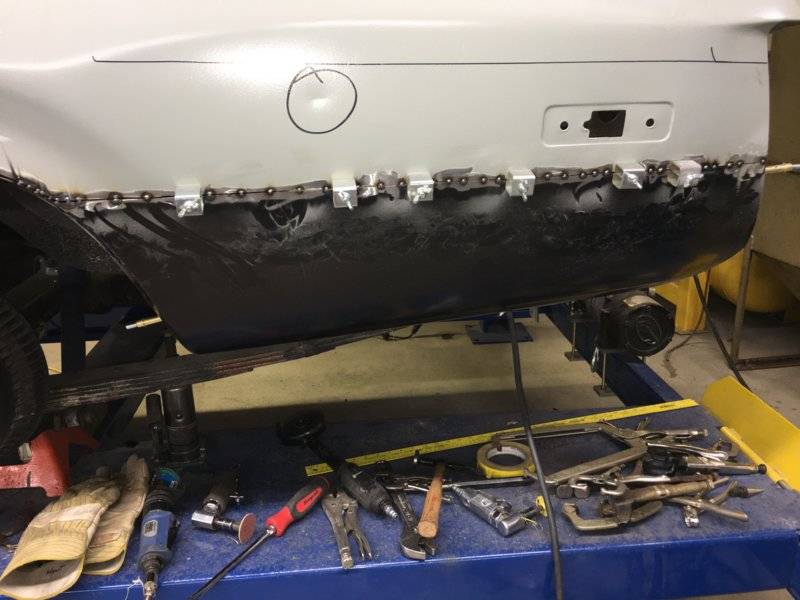

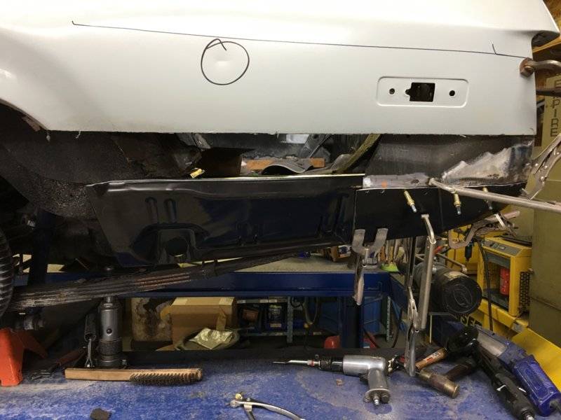

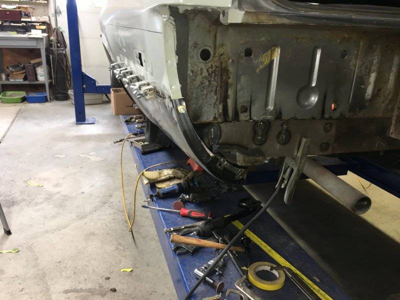

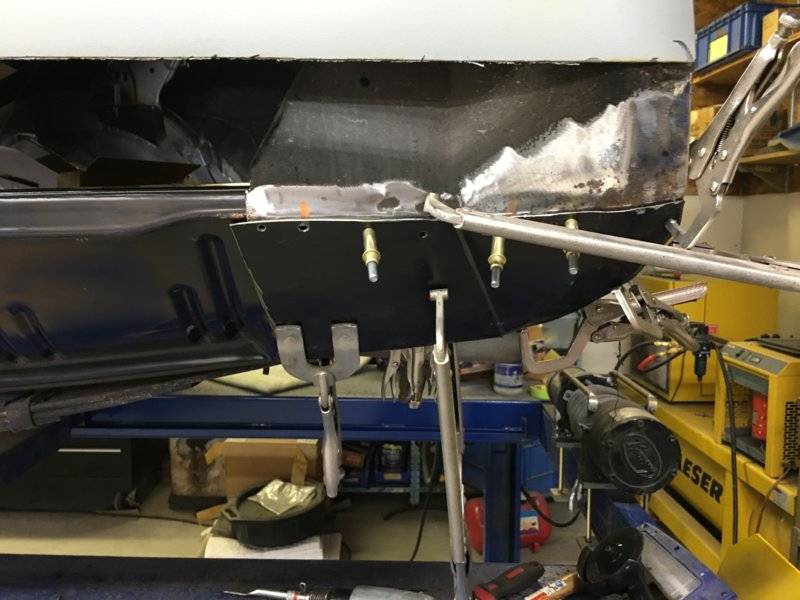

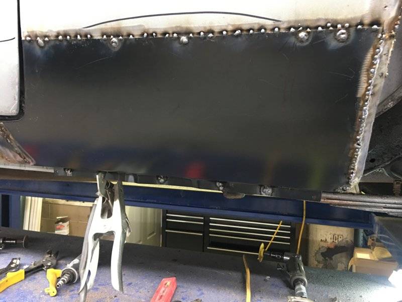

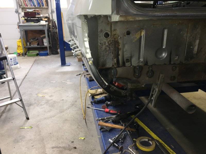

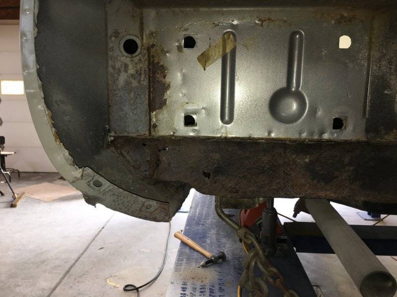

cutting and fitting the AMD panels , I also got the correct inner and outer wheel wells from them , really nice stampings and pretty easy to deal with

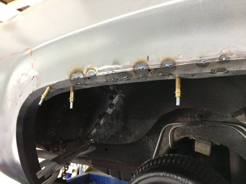

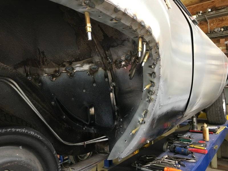

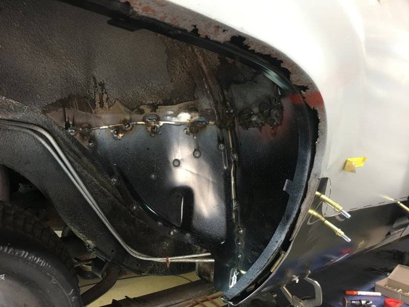

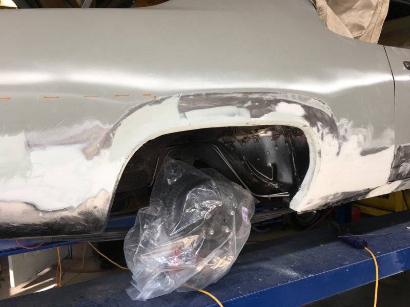

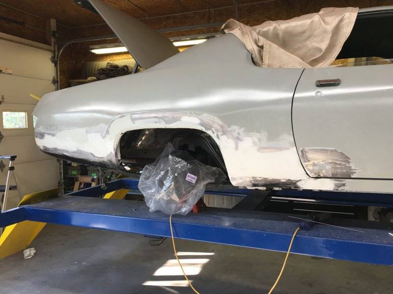

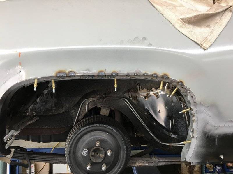

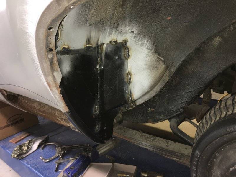

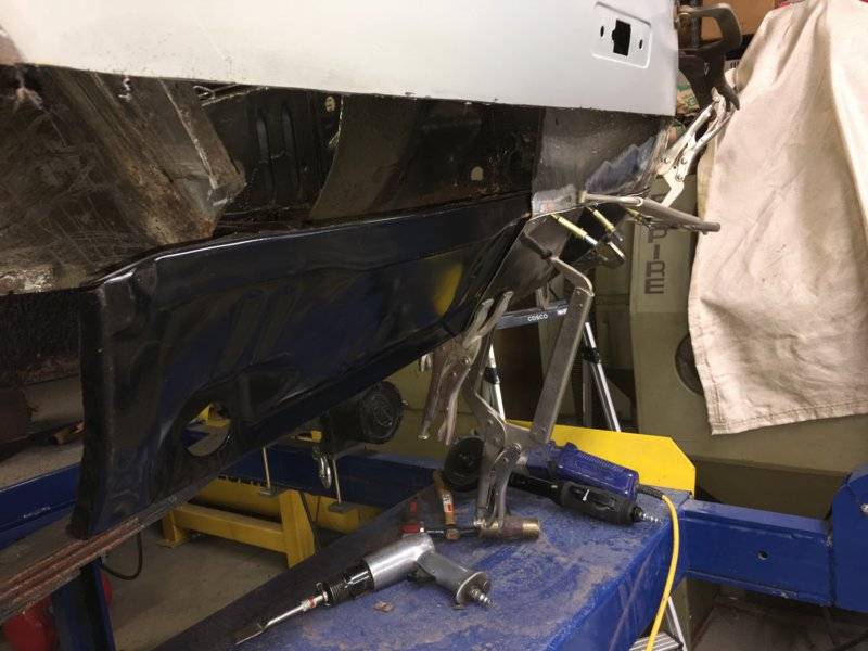

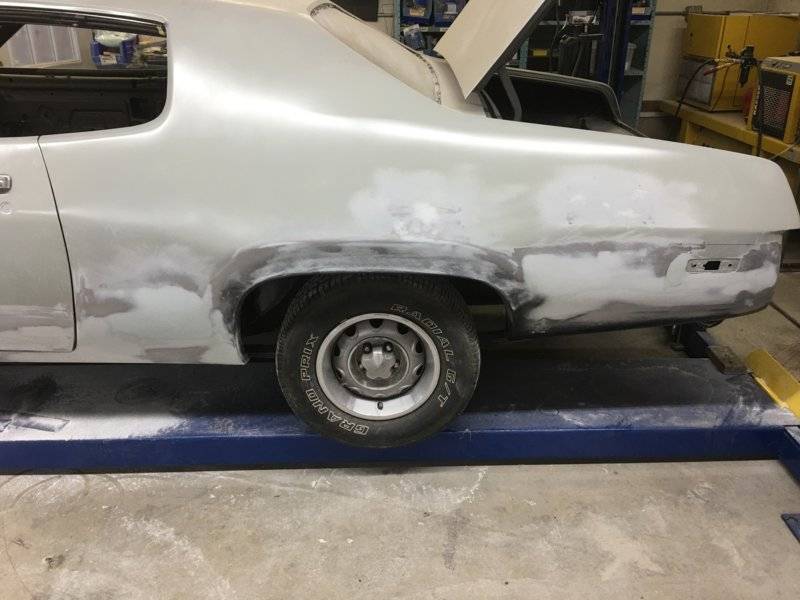

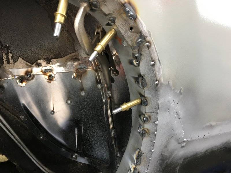

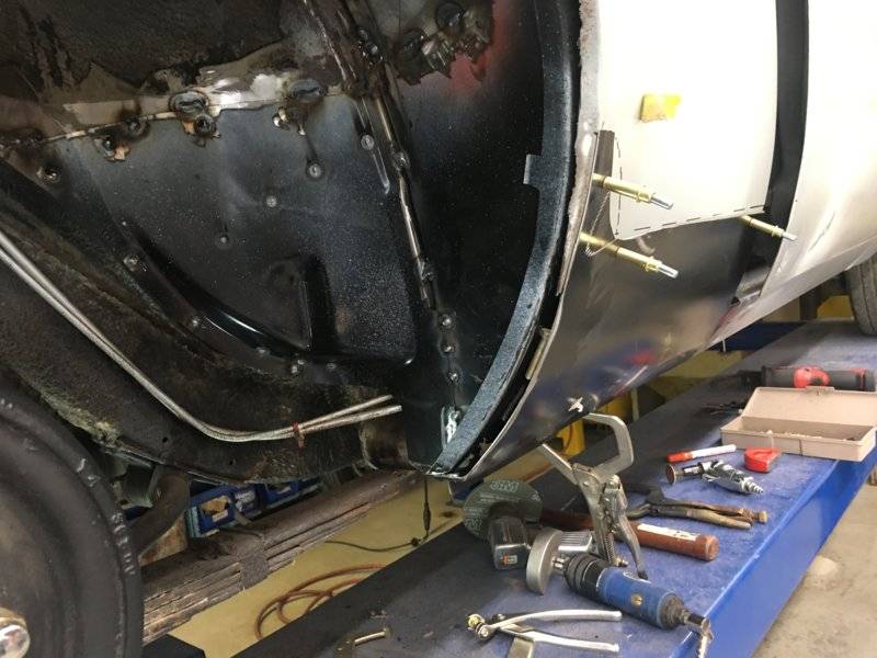

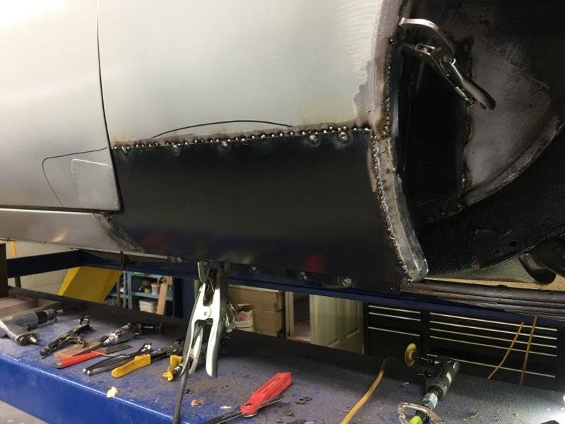

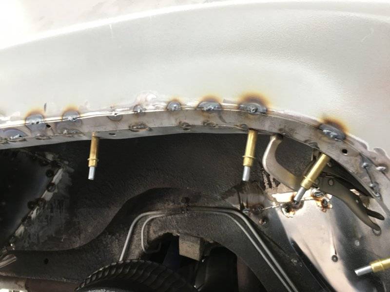

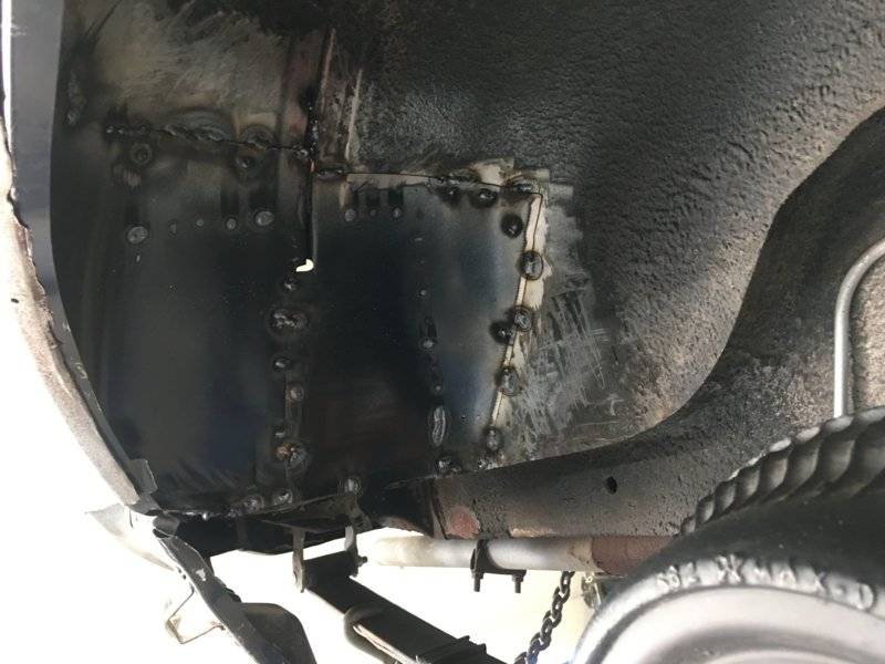

outer panels fir and installed then rebuilding the unique wheel well shape and welding , I did a combination of TIG and MIG
Notice how I formed the edge of the wheel well that was not on the replacement -
panel , I smoothed the radius in panel out before the body work but forgot to take a pic sorry
IMG_2930.JPG IMG_2932.JPG IMG_2955.JPG IMG_2957.JPG IMG_2935.JPG IMG_2936.JPG IMG_2956.JPG IMG_2958.JPG IMG_2959.JPG

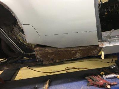

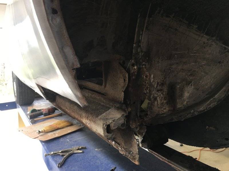

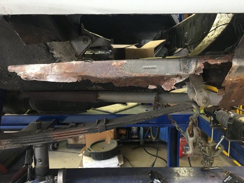

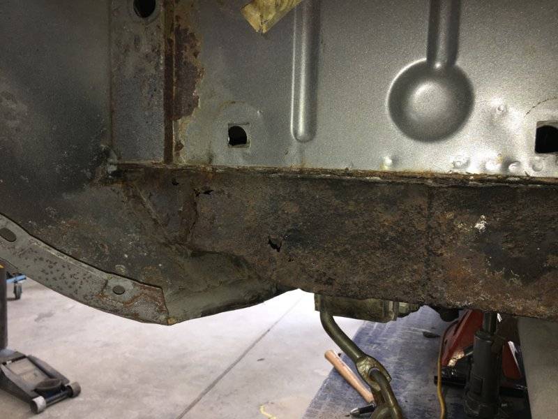

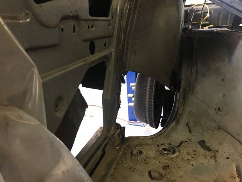

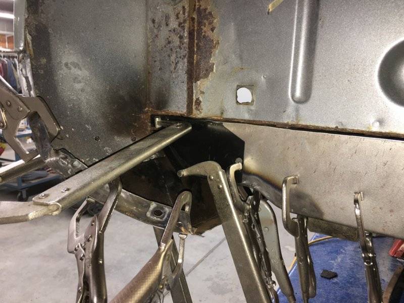

I wish AMD or someone else made inner rockers , the rest of it has been manageable but the inner rockers a bitch

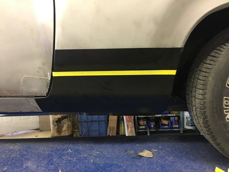

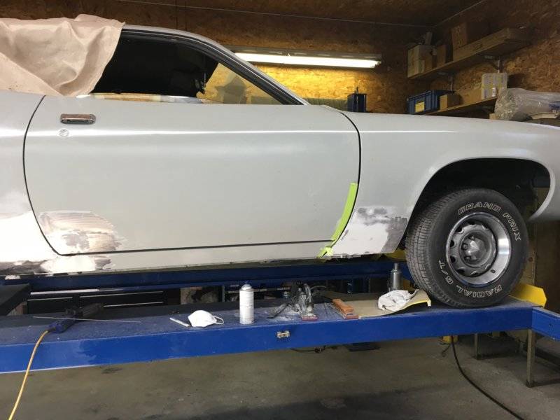

Stripe question-- Is there anyplace that makes a masking for the stripe? So I can spray the red and mask it off then get the rest of the color on and clearcoat ?
