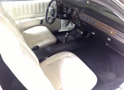

Well boys (and girls if your out there).... Finally some pictures of progress. In between moving out for termites and the girls starting school, its been a little hectic. But I did manage some progress.

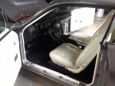

You all saw the headliner in..... Looks great. Had debated between the white and the off white sample but it turned out that the off white was perfect and actually read more white than the white when I held it uo to the roof in the shade. The white had a darker backing that wooed through and made it look grey brown....
Ivan changed out the drivers side window motor ( luckily had a new spare that really came in handy... All those weekend at the u-pick junkyards are now paying off. If they have the balls to charge me 1 or 2 bucks to just look I can fill my pockets with screws and clips.....
Now for the picture... Still have a million little details but it came together ( or should I say "it's coming together") nicely.

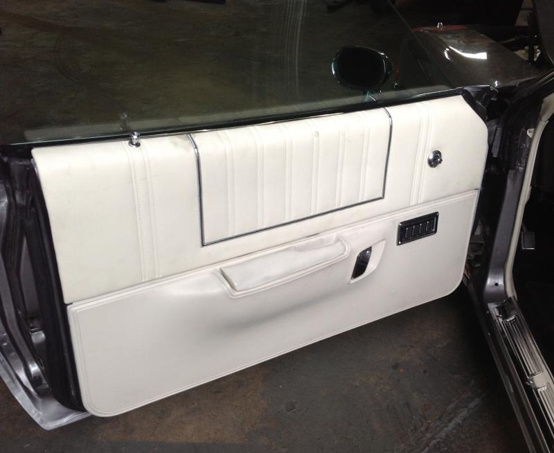

Here's the drivers side view... Thanks again to my friends at All In Leather for their outstanding job on the upper door panels and seats.

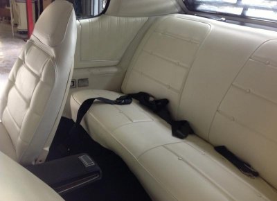

View of the back seat. I wonder how long I can keep them white......

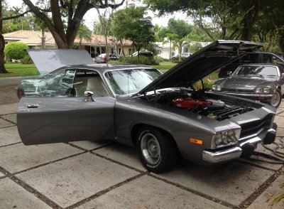

Update for tonight....
Moved back in to the house after work and then went to the shop.
Got a little done on my Saturday list by glueing in the window seals. The go straight and quietly into position without binding or biting into the seals. They had been biting into the seals but I suspected that they needed the upper door panels in for final alignment. I had used the old ones when I set the windows way back when.... Now, with the new upper door panels in, the windows seal up tight and go up and down very smoothly. Hurray........... Finally!!!!
Also drove the car and began to tune in the engine a little.
Timing was set at 8 degrees of advance (stock spec for a '73 340 with air) but the engine pinged under moderate load. Then, after full warm up, it would ping on even light load.
The cam is a little bit more aggressive than stock....about the same as a mild Purple shaft spec so it might be the cam. Will try to retard it to 6 degrees to see if it helps.
Thermoquad is set to spec for stock so it might be a little lean as well.
I'll start with the timing first. If it gets better with a little less advance then I'll start with the mix to get at the ping.

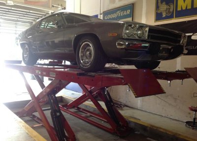

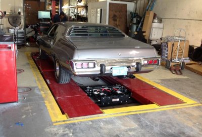

In today for alignment.
Its in.....
......And up

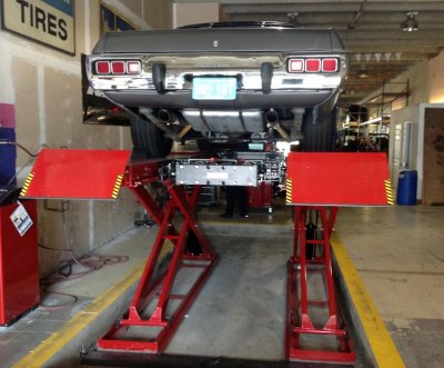

I had to wait after I got the tires til now because my friends a Sabal Chase had just pulled their rack to install the latest Hawkeye rack you see here. I'm one of the first on it....
And here it is from the front on the rack.

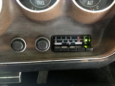

Worked today on a new radio I bought from Antique Automobile Radio here in Florida at a show on an impulse...
Here it is installed...
No power and a lot of distortion if I turn it up... Think it needs an amp... Am calling them now...... More later.

Radio just needed a better ground. Sounds fantastic! Those guys put together a mean radio!!!!

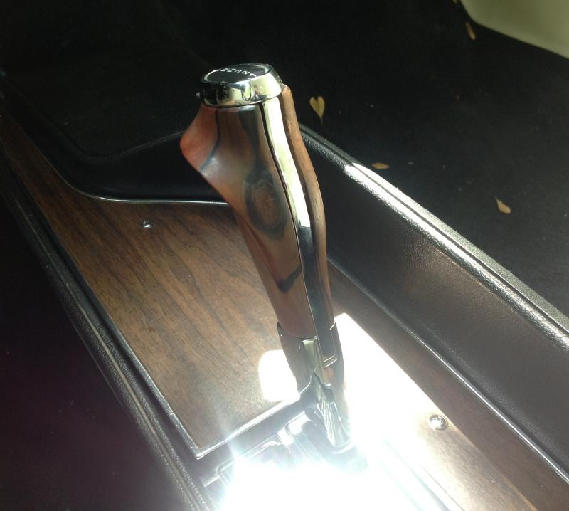

and now for something pretty cool... Got these walnut grips on fleEbay. Then adapted them to the automatic shifter yesterday.
More fun with dremmel tonight.

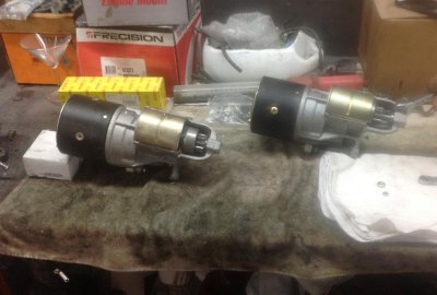

Drove down to Homestead in the Roadrunner.... New problem. Makes metallic rattling sound under slight power. I guess the knocking under load i took care of yesterday masked the beginning of the noise.
It only makes the noise (which sounds like a bad lifter or bent pushrod) under slight load regardless of speed. If I hold the brake while giving it a little gas...no more knock and no noise. If I release the brake just a little and the car moves it makes the rattle....
I'm thinking its the transmission... Possibly blew a clutch plate or bearing... I wonder how??????
I'll know more tomorrow.
If you've been following this thread over the last few days, you can understand when I say that I'm bushed!
Went over to me friend Ivan's shop this afternoon, he was in finishing up some little things and getting ready for tomorrow's work so he appreciated the company.....and I appreciated his lift. (note to self : next house I'm putting in a lift). So I drove it over and it still had the damned noise.
Also, I had just put in a new battery and the ammeter shows very positive at anything over 1200 rpm.... Odd......checked the draw with engine off to see if there was a short or hidden draw... Only the switch for the electric seat, which I then disconnected, then... Zero amp draw... Ok that problem checked, but started the car and there it was again... Odd....
Now for the noise.
Put it on the lift and ...... Nothing! ... No noise. Loaded the tranny with the brakes on and released it slowly to get the wheels turning... So we broth it down and there it was again... Under any sort of load and only while moving.......
We put it back on the lift and checked again... And again no noise.
So,.... Only under load when the car is moving.... Acceleration... Funny short... Noise sounds like its in the tranny area on the drivers side....
Then. it hit us both at the same time.... In fact we both said it at the same time...
STARTER!... Had to be.....but it was too late to have one delivered and we were both exhausted... I'm betting now its the solenoid for the starter shorting out and dragging the starter gear on the converter gear. That's got to be it.... Will also get the starter relay just to be certain...

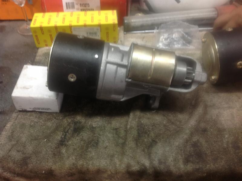

It was the starter... The gear return spring failed... Never had that happen to me before.
Here's the guilty gear.. All you had to do was tilt it slightly and the gear would slide down the shaft....
here it is in comparison to the new one.... Well actually, they were both "new".

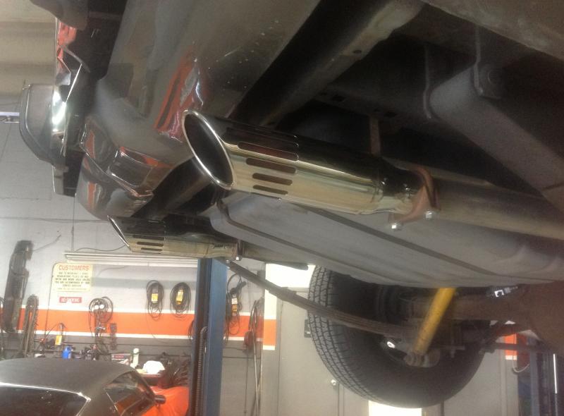

I got a chance to remove some of the overspray from the exhaust tips.
And polish them a little......
