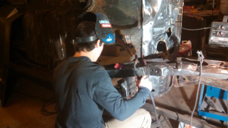

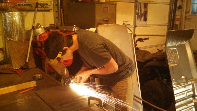

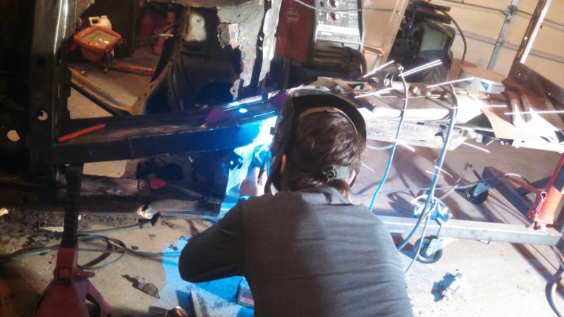

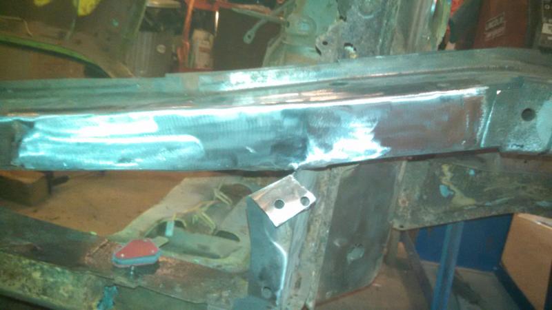

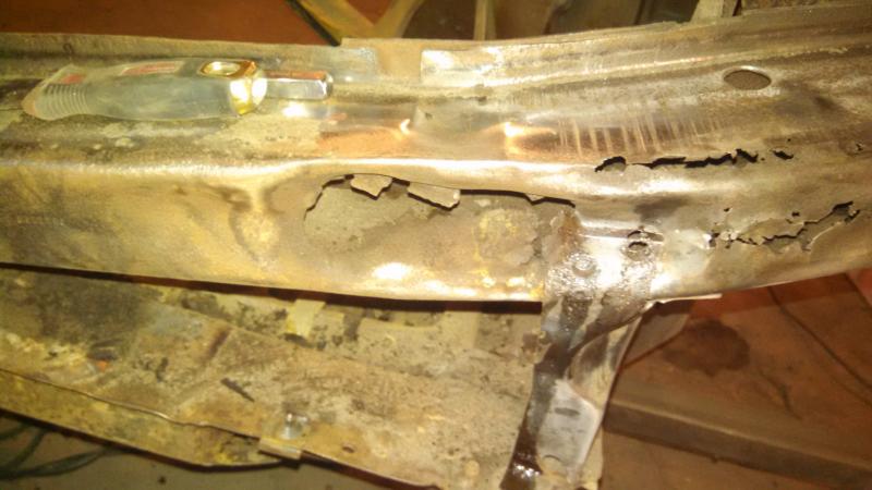

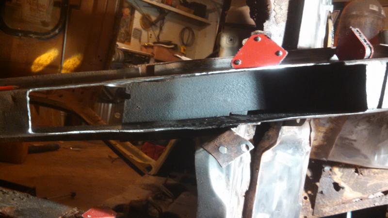

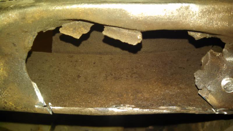

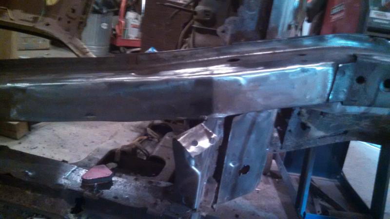

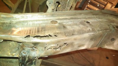

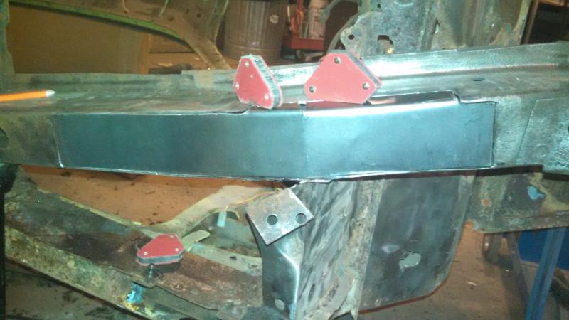

Well we got to work on the frame rail repair tonight...that was kind of a challenge making the patch in one piece

Nice job on the patch! Just make sure the weld penetrated well and you should be good to go with that fix!
Everything takes time, but it takes a lot less time to do it right the first time than to have to do it over later. Looks like you are wisely fixing things right...

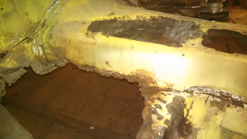

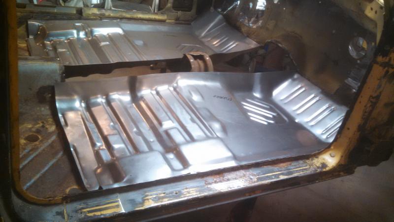

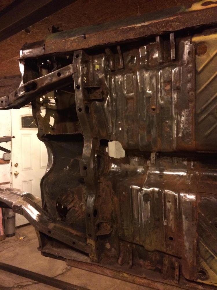

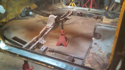

Thanks Hawk! And you are correct... Tonight we were drilling out the spot welds on the floor boards...we have new left and right side full length pans and the original 4 speed tunnel has the lower inch or so rusted out and gone towards the gas pedal area so we are removing it as the whole pan... hopefully that gives a better idea how to patch the tunnel to match the floor pan...
Great work on the frame rails, that is some hard stuff to accomplish!!
Hi Ron! It sure was a challenge but we got it... just had to keep massaging the metal to get all the correct angles and bends and then shave it a hair at a time until it fit good...took several hours just on the patch panel. And a BIG THANKS to you and everyone else for the advice and support. Being able to come on here and look at all the builds and get ideas is a huge help.
IMG_20150221_230042_075.jpgThis is the rusted tunnel area....

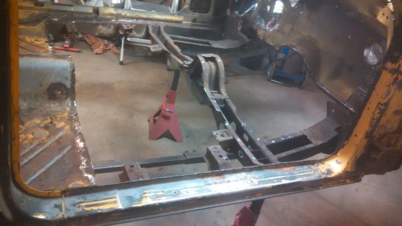

Well watched the Daytona 500 and then went out and finished removing the floor pans...now we can fix the rust in the firewall and keep movin forwad...
