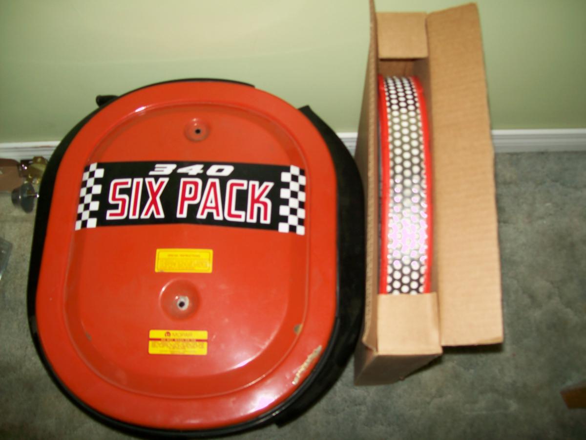

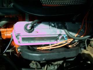

I was looking for a 340 6-pack, when I found the complete 6-pack only, with all the lincages, on a 4-sale site. The owner said he had it for 7 years, and it came from a local auto wrecker. He said they took it off a 1970 car that was smashed up.
I know that these are available as repo's, but I think this is original. The air cleaner has a few small chips, and the filter was dirty from a lot of use.

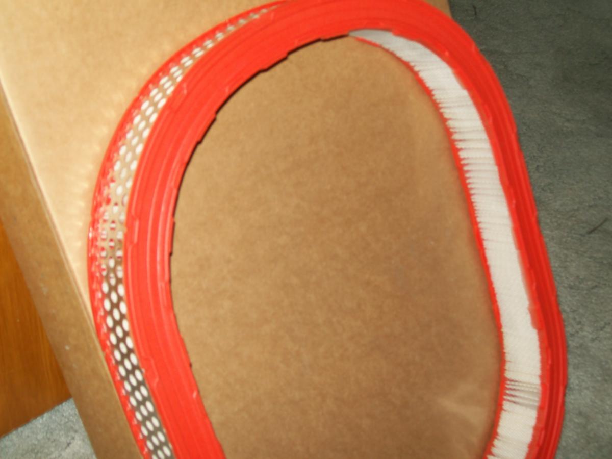

I asked at my local parts store, and they said they will get a filter for
$160 and 2 weeks delivery. I ordered one from the US for half that price, and it came in the mail in 5 days. They say it is the original Fram filter, but there is no name on the box or the filter. Nice original look.

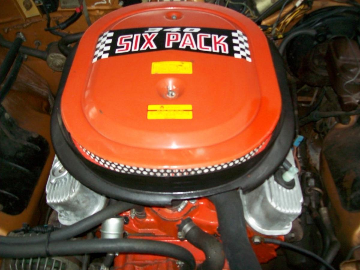

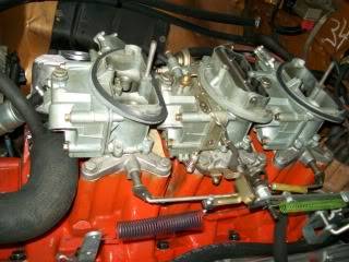

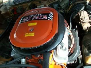

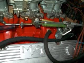

When I bought the 6-pack set-up, it came with carbs, but I didn't take pictures until it was on the car. Here it is, a sixpack from a AAR, on a Charger.

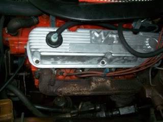

I wanted to replace those small rusty old 318 exhaust manifolds.
I got a hold of a guy who has the 1970 exhaust manifolds for the 340 reproduced (Ben Snobar 360-943-6633 ). I ordered a set, he says they are a good seller.
They should be, they fit any small block B-body or E-body, look great, and have less restriction.
I will get some pictures when I install them. I am going to go to 2 1/2 inch exhaust pipe all the way back. These manifolds have the 2 1/2 outlet, and are a very nice casting.
About the pushrods. The roller lifters are taller, so they use shorter pushrods in that application, but the heads are the same height, and will use the 7.500 pushrod in a flat tappet application. In my case, I shaved the head .030 for more compression. I put a .020 shim under the rocker shaft, and no problems.
I gave it a good workout with the 6-pack, and it really revs.
Well, I got the exhaust manifolds and put them on. The passenger side needs to have a oil filter adapter to turn the filter 90 degrees.
The driver's side manifold curves up and around. It has a different outlet angle than the old one.
I took the car to an exhaust shop to do the final hook-ups of the exhaust.
It is now 2 1/2 inch pipe all the way . I painted the manifolds with NAPA high heat header paint, and it is staying on.
