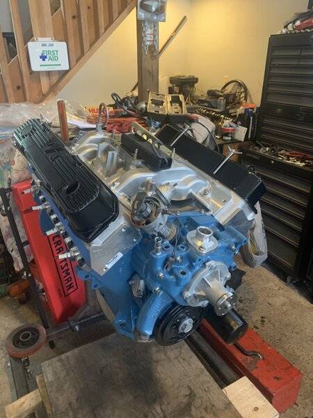

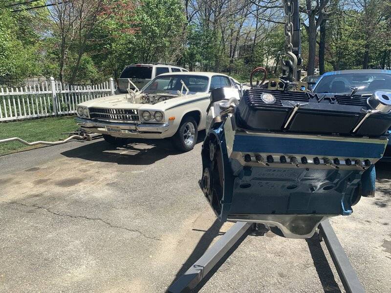

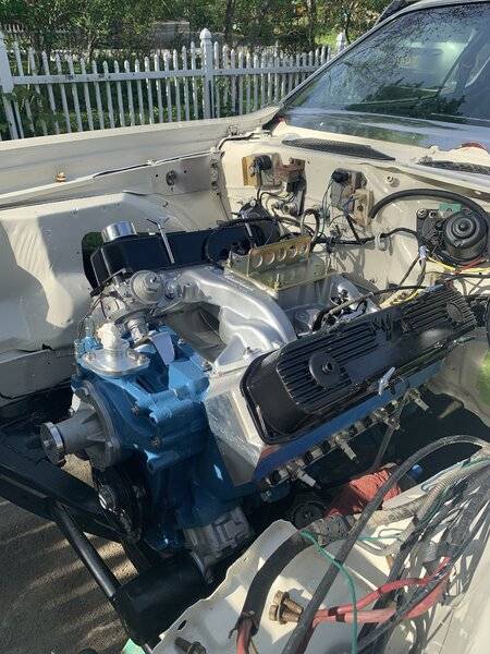

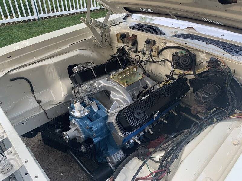

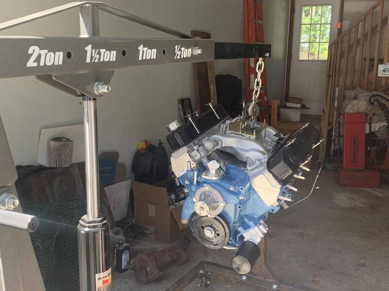

Back to the engine - after test fitting the intake and valve covers, we painted them both and finished buttoning up the engine. Now it was time to put the heart back into our mopar:

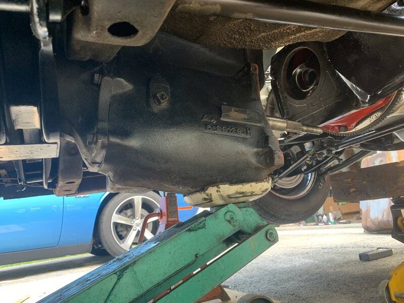

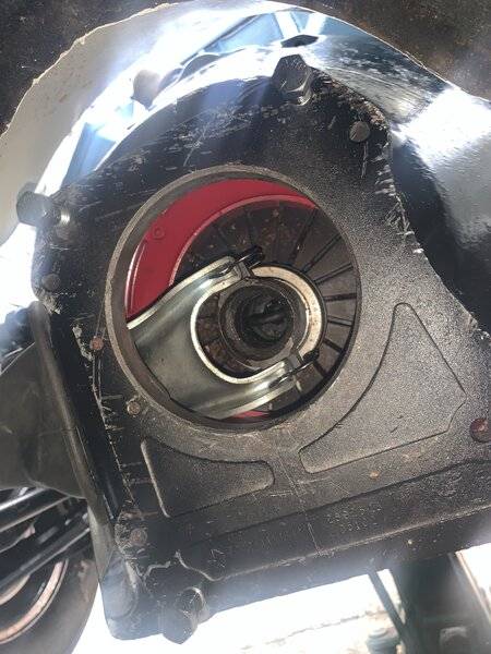

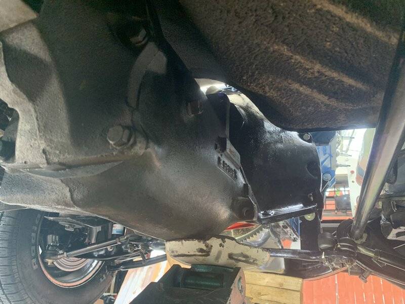

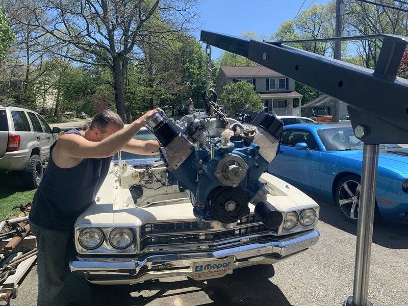

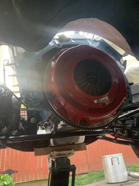

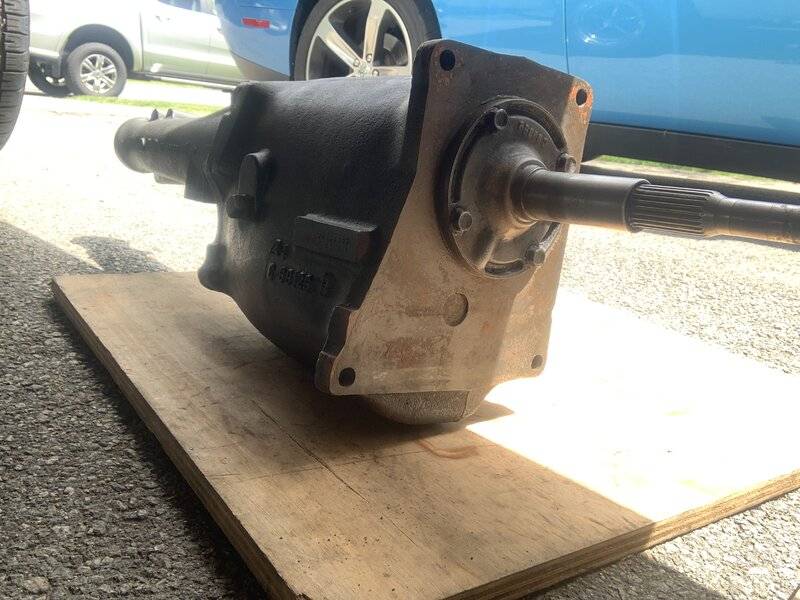

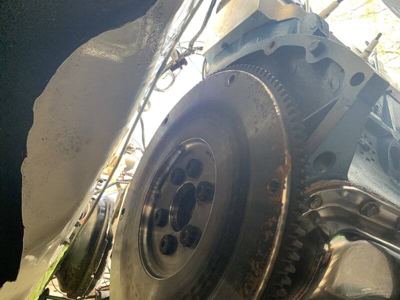

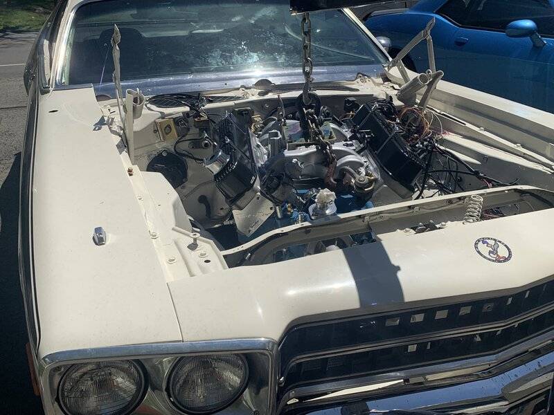

After installing the engine, the flywheel, clutch and bell housing were reinstalled. Not surprisingly, the transmission was once again a bear to get installed - although to my credit I must have learned from last time, as I was able to get it bolted up the same day this time around!

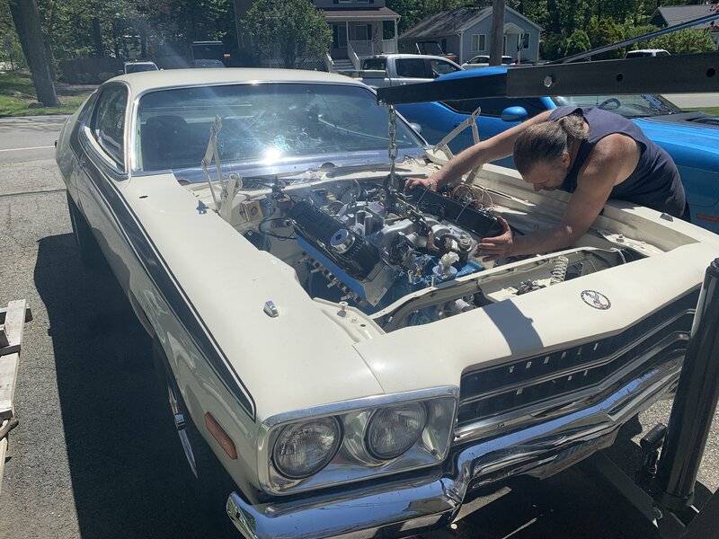

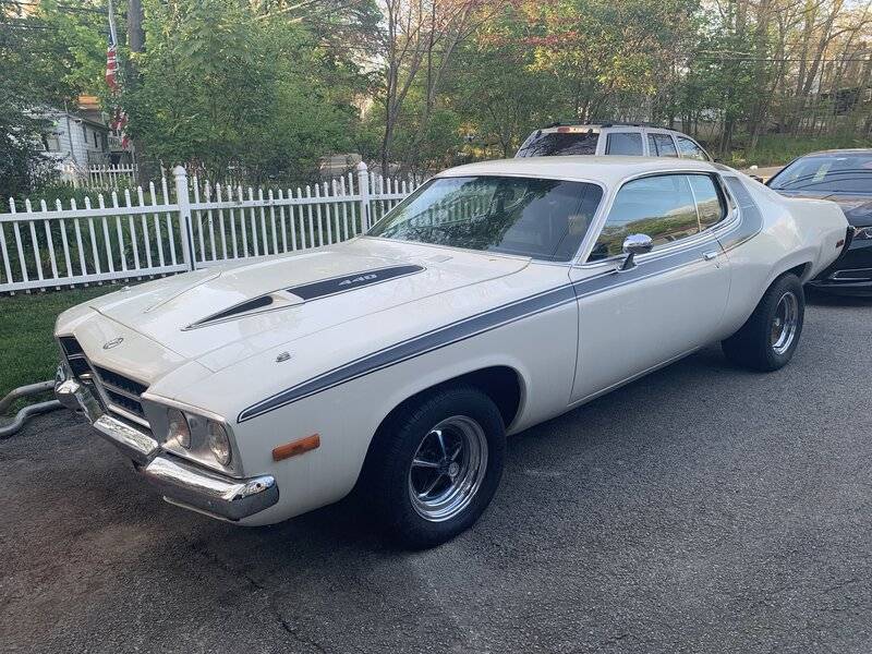

We also took the opportunity to replace the worn out hood hinges with a solid set we bought at Carlisle Chrysler Nationals in 2019. With the engine & trans in, and the hood installed, she was starting to look like a finished hot rod!
