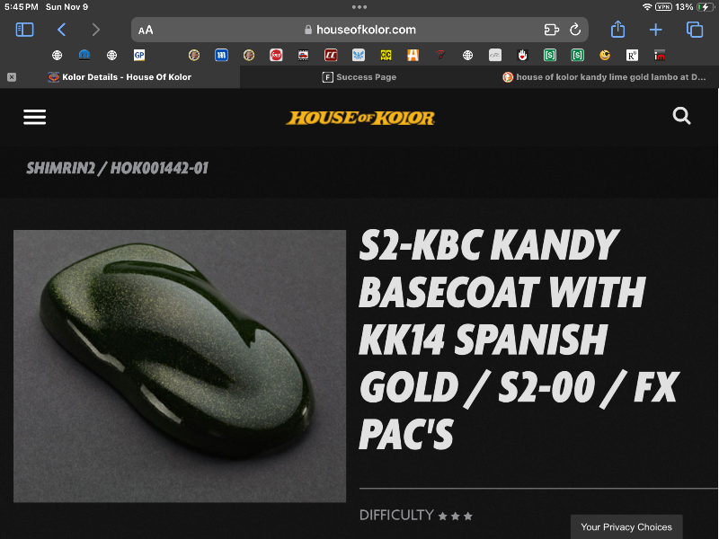

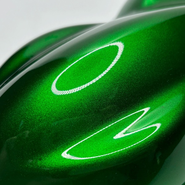

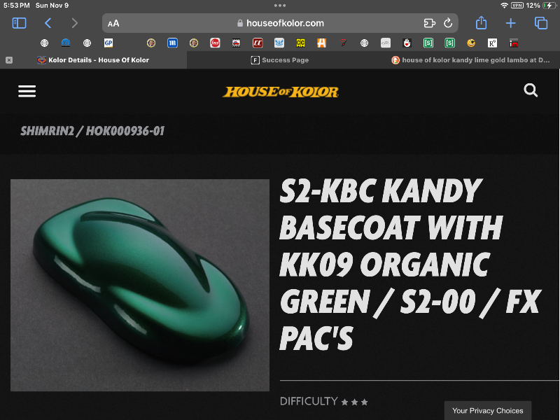

I think we have a body color picked out. House Of Color Kandy Green.
Stripes are no stripes?

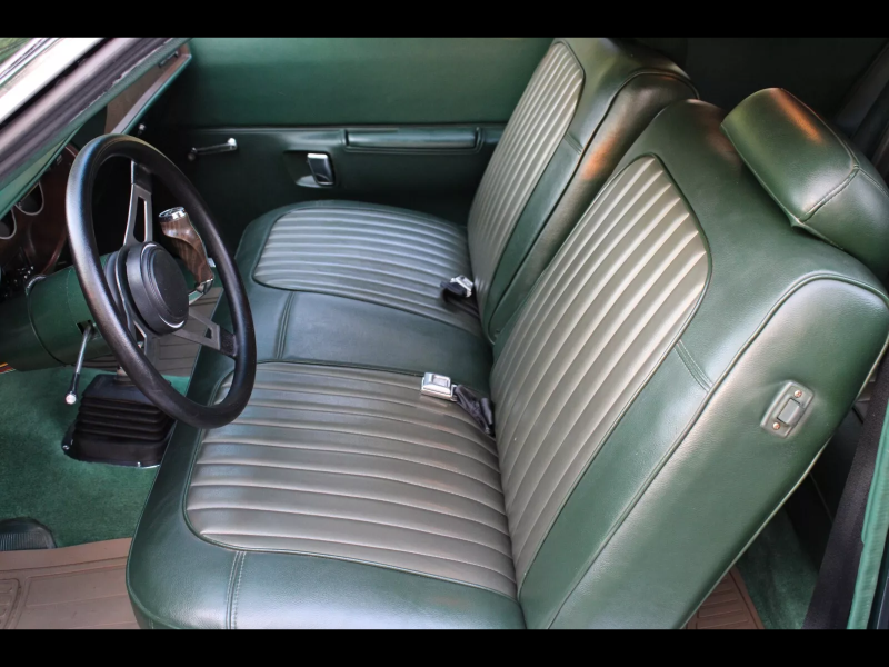

Yes stripes. Still deciding on color. They are going to be painted. We are thinking either a darker green or black. They will not be ghost stripes but will stand out when you get up on the car. But that could change. Still deciding on the stripes. The interior metal will be the Kandy Pearl body color. I think it will look good with the existing interior seat covers and door cards.

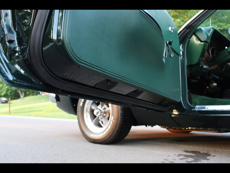

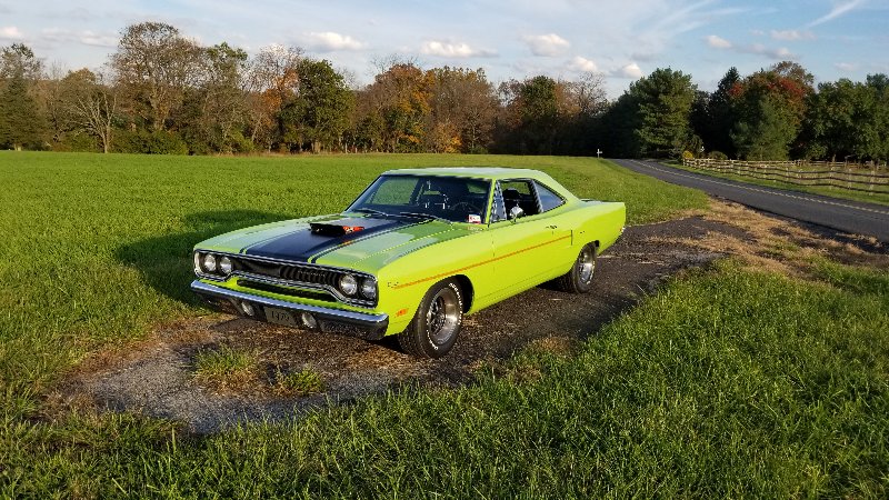

Since about 15 years ago, I have been warming to green. First of all, I ended up with my factory Limelight 70 Road Runner. I really didn't want green, but when I saw the original, pristine factory paint under the B pillar trim, I decided to do it. It has really grown on me and now I love it.
Secondly, there is a guy I know in Bloomsburg, PA with a green 66 Charger. It is a deep emerald green and it looks really nice out in the sun.
