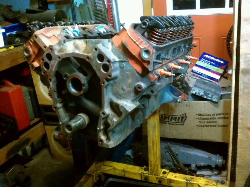

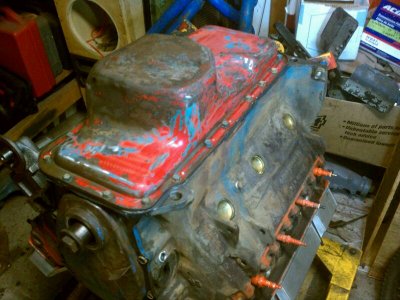

Got the bottom end and heads back together, waiting on cam and gaskets to come...

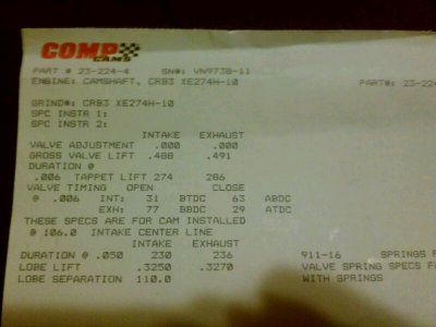

Ill snap a photo of the cam card. All that stuff came.
Its a Comp. Hydral flat tappet. Pritty chunky cam grind
Special order direct from Comp.

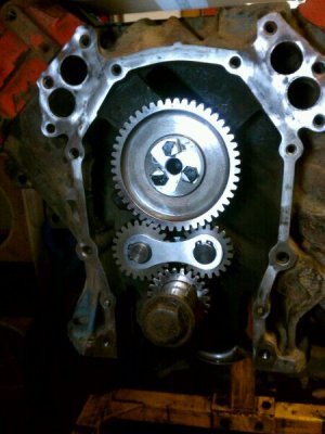

I wanted. Three bolt cam. Due to me wanting to runt a gear drive.

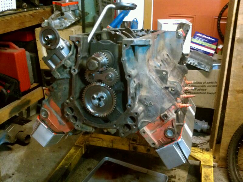

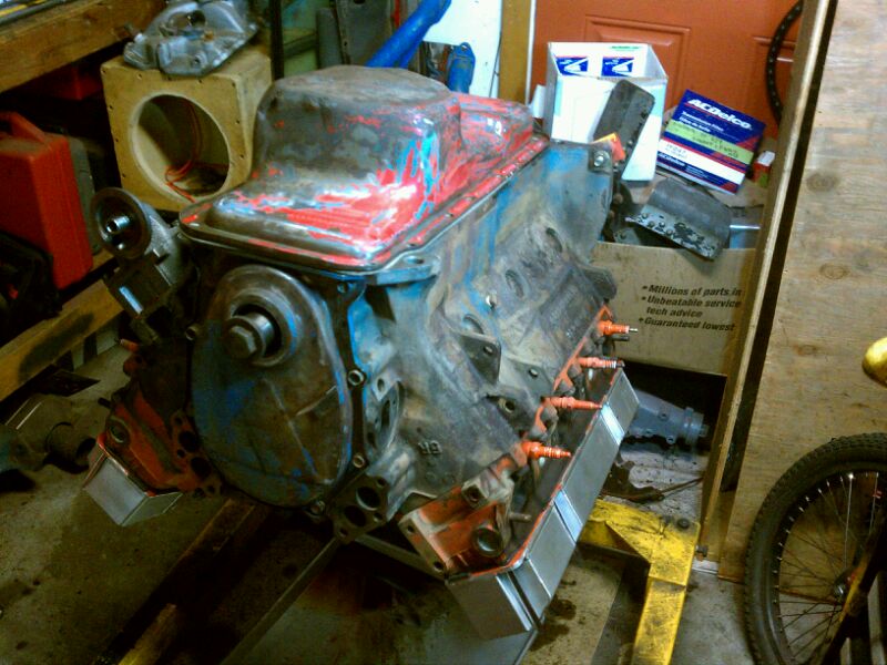

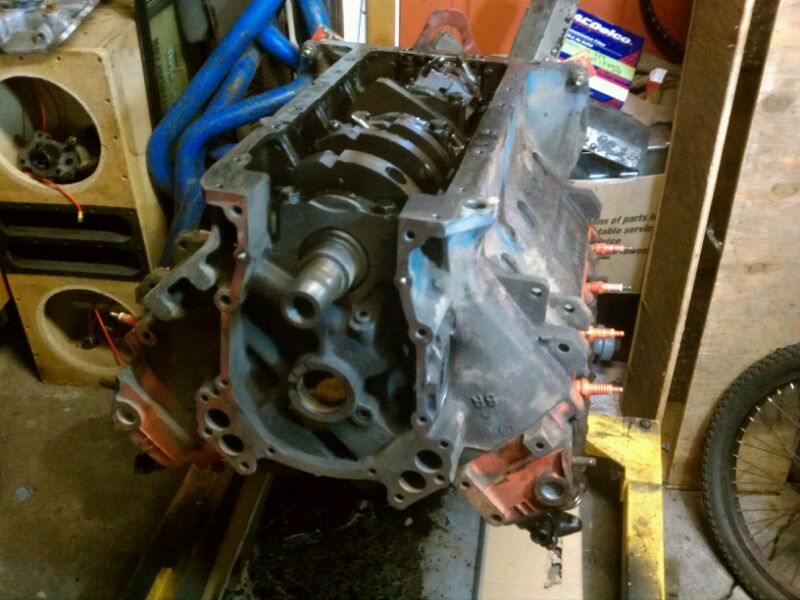

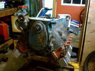

Its been a while, but heres a ,little update on my engine build. Cam card to follow, and she will be back in the car soon. Enjoys guys and gals

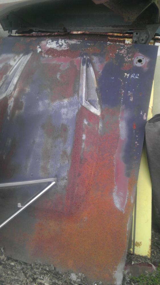

I never noticed a difference in the hoods so I went to check the one from a 74 RR I parted and crushed a few months ago and it has no gills/vents
Anyone have a picture of the difference in them?
Yep, that's a 74. At the back of the hood (by the windshield) there are two grilles for fresh air into the cowl. Reckon they figured out that it didn't help fresh air into the cowl, but let a lot of water in.

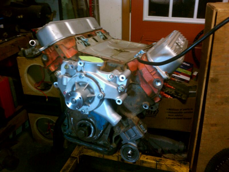

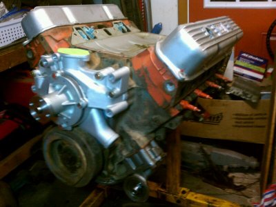

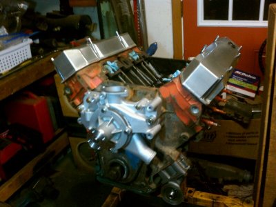

Completely ready for paint now, shown is both with the sheet metal valve covers that will be used after paint, and dummy covers that ill use to paint it. Enjoy
