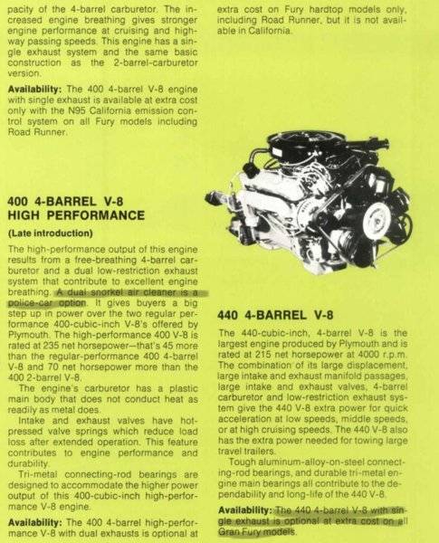

What is the Fifth digit of your vin? P is the hp engine for export with no cat converter. N is for USA
What? P is for the HP400, N is 4bbl and M is 2bbl. Those have nothing to do with sales location. The "I" on the fender tag means export, "C" is Canada and "U" is USA.
