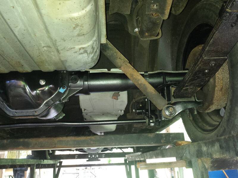

I installed a 8 3/4'' under a 75 Charger. It was from a 71 Road Runner. Bolted right in.
