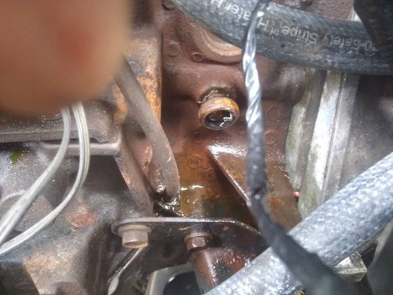

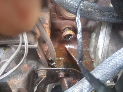

Anyone know what sensor this is? Got it running, and once it warmed up, coolant shot out
I was TOlD it's a 88/89 MPFI 2.2/2.5.
I know the coolant temperature for the computer is in the thermostat housing, and the one for the gauge is in the head I have no idea what this one is can't seem to find a wiring diagram on it either. It has one gray wire and one gray wire with a yellow stripe. Maybe some type of fan control for the coolant?
