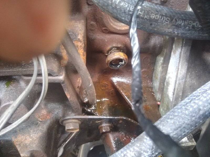

Anyone know what sensor this is? Got it running, and once it warmed up, coolant shot out
I was TOlD it's a 88/89 MPFI 2.2/2.5.
I know the coolant temperature for the computer is in the thermostat housing, and the one for the gauge is in the head I have no idea what this one is can't seem to find a wiring diagram on it either. It has one gray wire and one gray wire with a yellow stripe. Maybe some type of fan control for the coolant?
Im going to guess a thermostat sensor .
That sensor, ECT, is located on the thermostat housing. This is in the block. I'm thinking some type of extra fan control switch, but I haven't confirmed it yet
After more research, it's gotta be the oil pressure sensor sender. It sure looked like coolant coming out. I had just changed oil and added some engine restore, that stuff is tinted blue. Maybe it just looked green, idk. Gonna put a new oil pressure sensor in it and try it out
