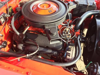

My numbers 383 Magnum
Now a 432 Stroker
Repop 22" Radiator , recore 3 rows a long long time ago and kept things between 180-190 degrees at all times for many years
High flow 180 degree thermostat
Factory shroud
Anyways Doesn’t cut the mustard anymore - 195 - 200 degrees creeping towards 210 at idle with this 432 motor and temps here in WI isn’t summer yet
