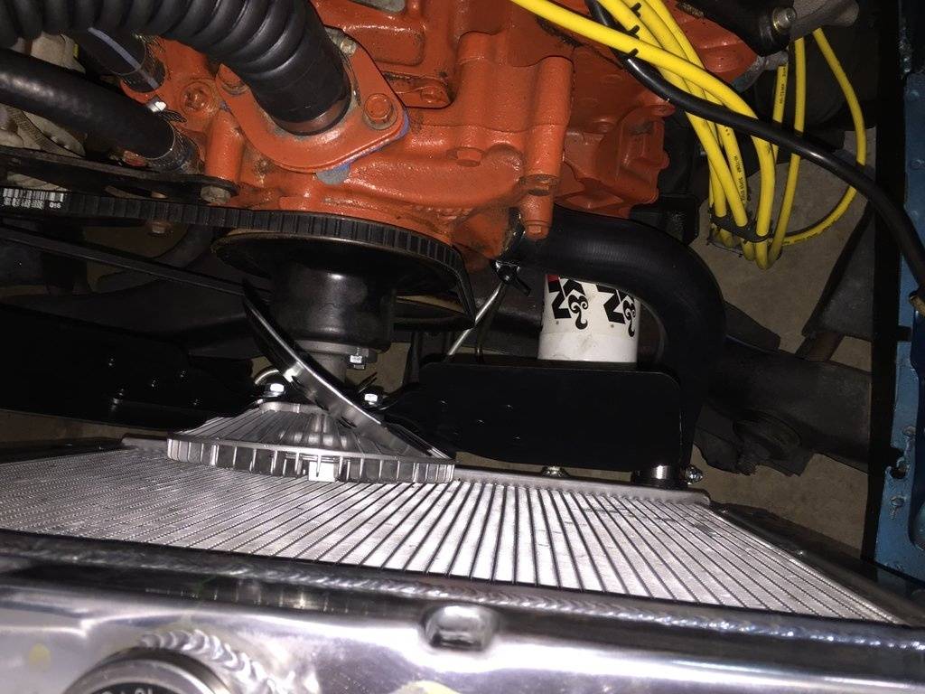

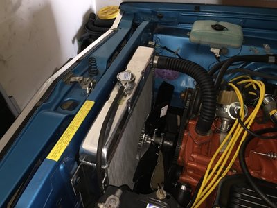

I ended up keeping the one that I had already purchased from ECP. Made new lines and will be making a shroud for it when I get a bit more downtime. It already cools better than the old one.
Pics please!
Pics please!
Here are a couple. Not the best quality.
Nice! Now get a shroud and your fingers will thank you.
