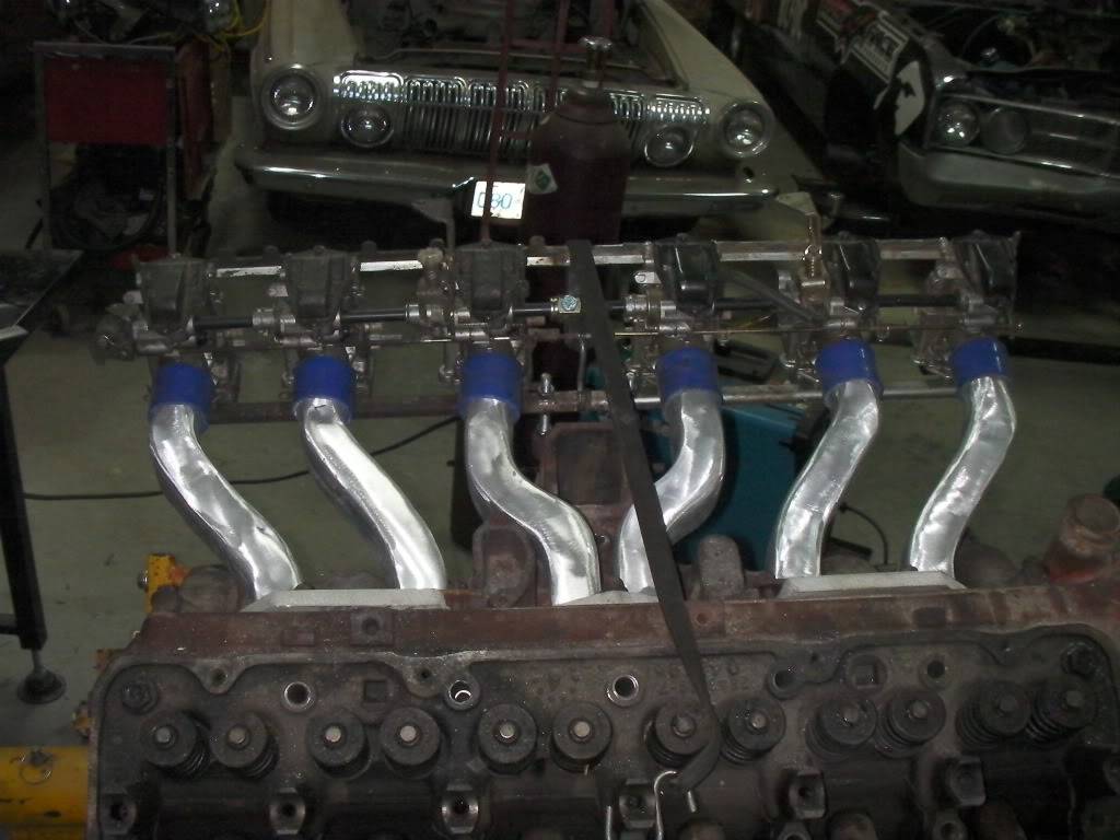

Has anyone ever put six flat slide Mikuni MC carbs on a 225 six?
I'm not looking for a huge project, but as a tinkerer and machinist I thought some square tube stainless times six would be cool.
Can they deliver enough fuel?
I've seen 1, 2 and 4 barrels, this is a direct blast per cylinder.
What do you think?
Dan
Being a snowmobiler I have had these evil thoughts aswell. My 1000cc 4 cylinder 11,000rpm engine has 4 BSR37 millimeter carbs on it.The older ones had individual cables tugging on each carb, making syncronizing all valve openings a bitch with cable stretch.The newer one has all 4 tied together on a common bar pulled by one cable, making life good.
I think the biggest hurdle is sizing then linkage.These carbs are very expensive new, but if you have access to a bunch of same carbs, I think it's a wicked cool idea.
May only work with manual clutch though.
6 Mikuni 225 pics
This type of fabrication effort is what defines Hot Rodding. Keep up the good work and definitely keep up posted on the results.
