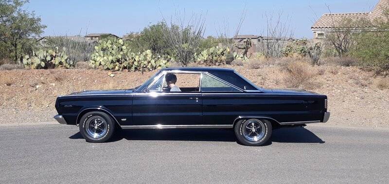

I have 245/60/15's on 15x8 rims on the rear of my 67 coronet 500. With mopar xhd leaf springs. Fit fine. But you need to raise the rear of the car and unload the rear suspension to get them on or off.

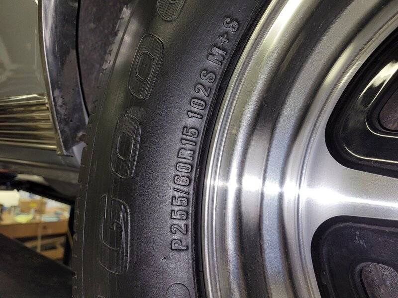

I have 255/60/15's on the back of the HP2. There is about 3/8" clearance to the quarter lip and a good 1.5" to the springs at the back. Another 3/4" of back space and you could get 275's on it.

I have 245/60/15's on 15x8 rims on the rear of my 67 coronet 500. With mopar xhd leaf springs. Fit fine. But you need to raise the rear of the car and unload the rear suspension to get them on or off.View attachment 1274282
