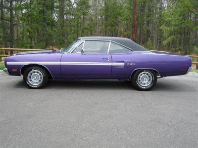

I got a smokin deal on (4) 8 inch rims, w/(4) 275 60 15s. Bought (2) 245s, and mounted them on the front of my 70 Charger w a set of the 8" rims. While I would prefer the 7", clearance is absolutely NOT an issue. Love the tire size for the front.
IMG_2977 (Large).jpg245 60-15 would be the proper size to mimic an F 60-15 Good Year PolyGlas.
Stock 15x7 rims are 4 1/4 back space.
Here is one of my old cars with 235 60-15 front and 275 60-15 rear. Got a deal on the setup but always wanted to change the fronts to 245 60-15.
