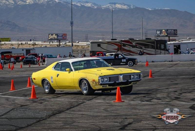

Has anyone run 275 15's on the front? I am thinking of doing this on my 73 Charger. Fitment issues?

YES......BFG Radial TAs on my 1970 GTX RS23V0A******. IMO....it just looks good....but bottom edge of fender is close...1/2" - 3/4" clearance at full lock left/right. But in straight ahead no clearance issues....no problems with rear clearance either inside or fender well. Run them on std Rally wheels.....see pix. Some prefer smaller tires up front.....it's a personal preference.......just a thought.....

Autocross. It has 255/60-15's all the way around now and it is time for new tires. I daily drive this car, along with autocross and drag race.

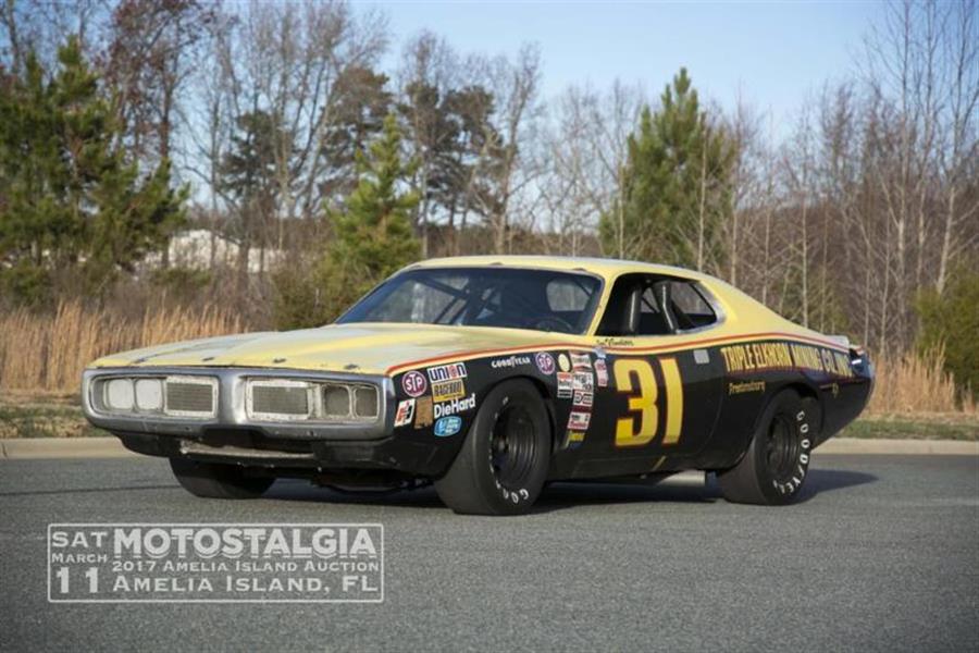

The only way fat tires on front look good to me is when the car is done up as a road racer or old Nascar style. I wouldn't be surprised if you have to radius the fenders to get them to fit without rubbing. Otherwise the car may have to sit too high and look funny. No personal experience , sorry. I did find some cool pics on the'net though. https://i.pinimg.com/originals/d5/07/58/d50758692d5b31ae5bbe0c89d6258942.jpg https://www.racecar.com/racecarwebsite/Images/News/85048/dd.jpg
Thanks for finding those pictures. The front tires do look very tight.

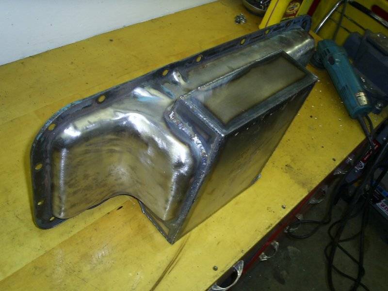

I have @ 7 quarts. It's unbaffled as it is not necessary for my use, but could just have easily been done. It was way cheaper than a purchased pan, but took some time to build. You have to be be very cautious not to warp the pan rails. Mine was made from a "187" pan (not sure of original capacity or application) because that's what I had laying around.
