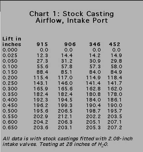

Well, I am weighing in late here and I am no expert on cylinder heads, but to play devil's advocate here I offer some slightly different info that my cyl head guy agrees with. These articles were produced by Mopar Muscle magazine awhile ago but offer some really good advice on cylinder head selection. You should read all three articles...very well done. I have posted the link and an excerpt .jpg of one of the flow bench results. Good reading!
http://www.moparmusclemagazine.com/techarticles/5115_cylinder_heads/index.html
Eddy head flow numbers unported for reference.
